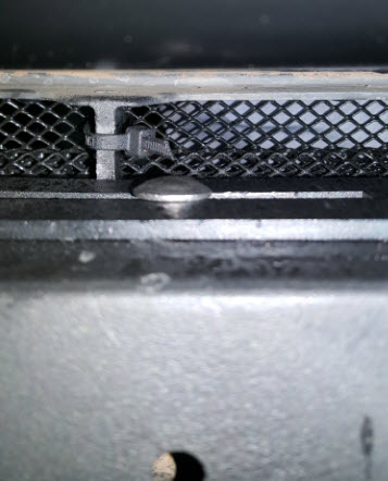

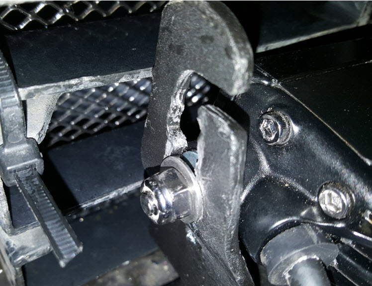

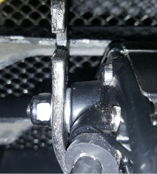

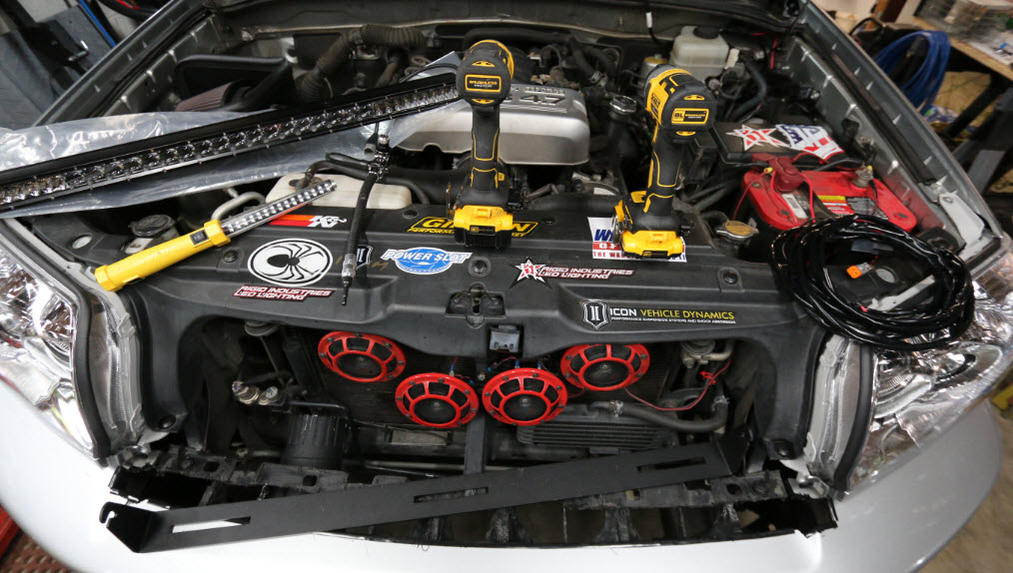

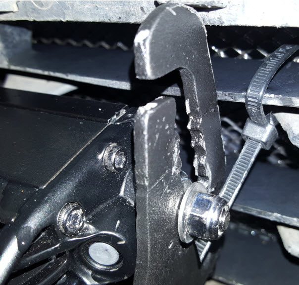

Okay, last Rigid light. This one was a pain.... I mean real pain to install.
The Light bar mount was to small??? Come on Rigid check yo $hit please.
Had to bend the ears out and back in and then made a mess borrowing down into the ears so that the light bar would sit at the right level in the lower grill.
Here is what i started with
This is the finished product.
ears i had to borrow down into the get the light bar to set at the correct height. And i had to bend them out due to length not being right.
borrowed into other ear
Drilled through the frame on both sides, which was not as hard as i thought it was going to be.
Another picture of the ear burrowed and bent out.

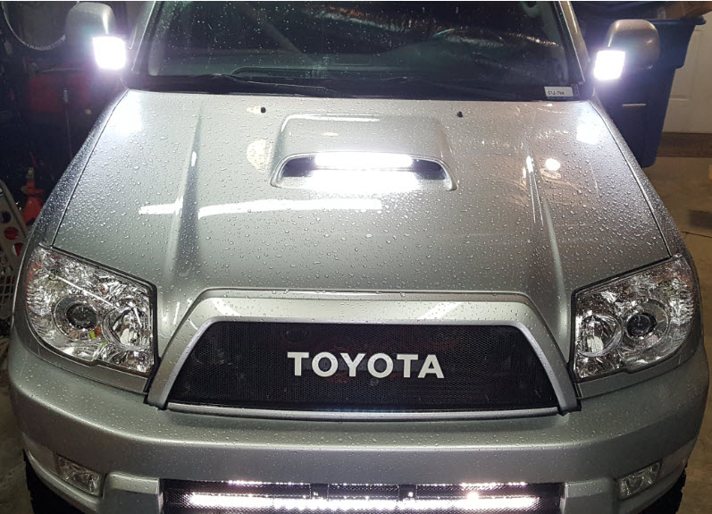

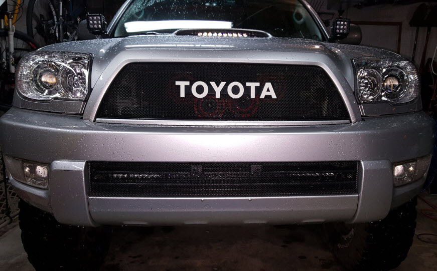

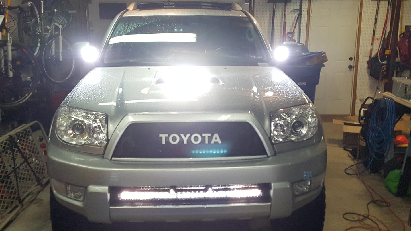

and now the real reason i did this. To hide a very expensive light bar in my lower grill. Almost unnoticeable

Hopefully the rain will stop so i can go out and take some night time shots.
The light bar is silly bright. I think it is brighter than the other rigid light i have mounted.
Nice install, thanks for sharing! Looks like you went with the SR2 combo 30" - Much brighter than the older SR series light bars for sure. I have one on my roof and it has awesome output
Thank you and yes, forgot to mention it was the SR2- Series 93131 Driving/Hyper spot.
