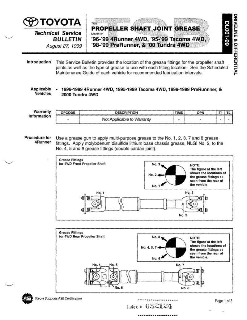

Yeah I need to go buy a new zerk gun. I'll will do that and see if it helps. On the 4runners there is a zerk for greasing the shaft is that right?
I also forgot to add that i dont have much aftermarket weight in the back. Only 50 extra lbs from a roof basket and the rear sits a little higher because of that. Not sure if that would be throwing anything off balance or not.
Yeah there's around 6 or so on the rear driveshaft. You can also grease the front but it doesn't run dry unless you use 4WD a ton.
6? That's quite a few. I saw the zerk for the yoke and right next to it a zerk for the u joint. Both u joints near the tranny don't have zerks. I'll have to look around for a few more on the shaft.
So I know Yoda recommendeds different types of grease for the u joints and the yoke. If my research is correct NLGI No.2 Lithium Base Chassis Grease is used for the universal joint, and NLGI No. 2 Molybdenum Disulfide Lithium Base Chassis Grease is used for the yoke. It's a huge pia switching out grease in a zerk gun and I'd rather not buy two. Is it important enough to not use one in the other? Or can I get away with using the same grease in the shaft related zerks?
I'm sure there are those who will say I'm wrong, and that's fine.
I use a high quality moly grease on all the driveline grease fittings at each oil change. I pump until some weeps out of the u-joint cups and wipe off the excess. The zerks on the slip yokes get enough to make the yoke telescope out just a tad. I don't overfill those.
41513d1301233004-driveshaft-clunk-thud-viewer-jpg
I also hit everything with Moly B. Works fine. I still get some grumble from mine, but they're original 200k joints, so it's whatever. I'll change em someday.

I believe I saw a comment by you on another post saying the same thing. I ended up getting some moly grease and zerked them up. Will drive it tomorrow and test it out. Took around 15 pumps into the yoke before it moved.
