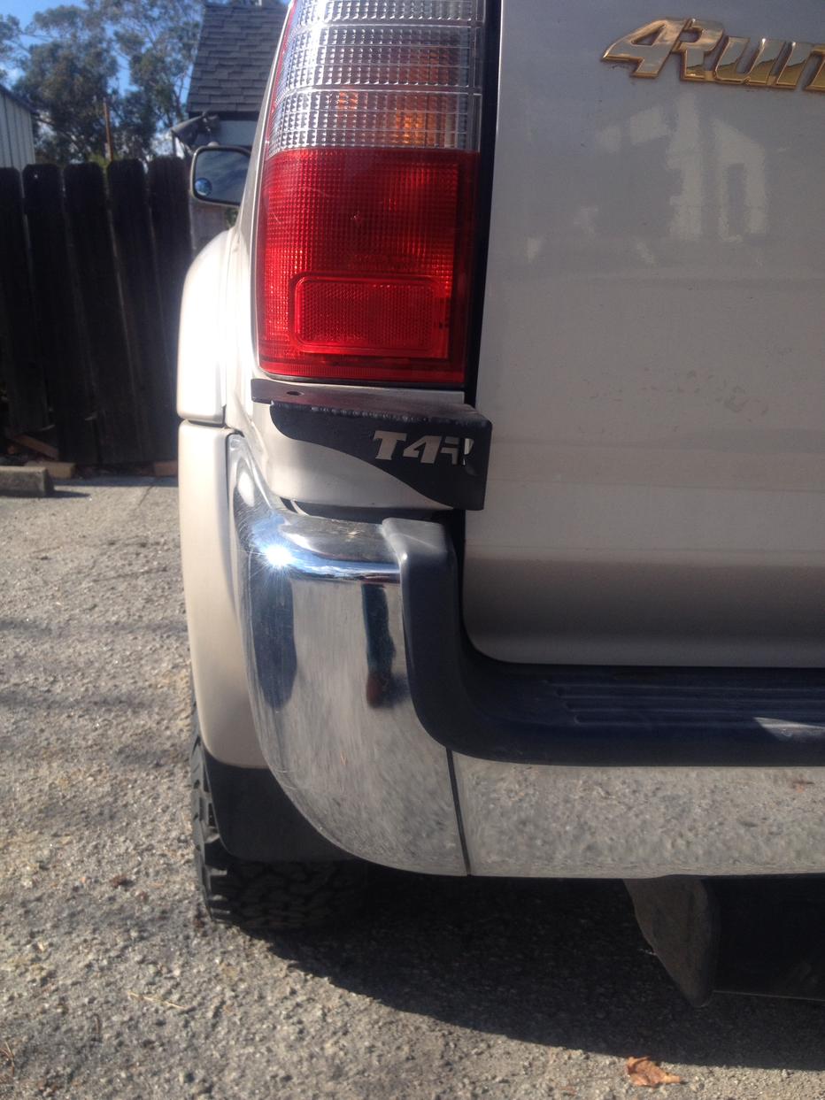

Considering painting (black/bedliner) my wheels (they are very chipped and pretty thrashed) my hitch (some rust/fading) my sliders (waiting for welder to have some time) adding extension and repainting rack, and my rear spoiler ...but also seriously considering bedlining my front and rear chrome bumpers. Any input?

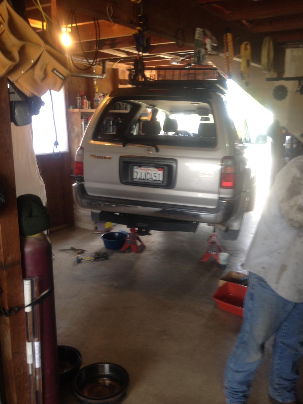

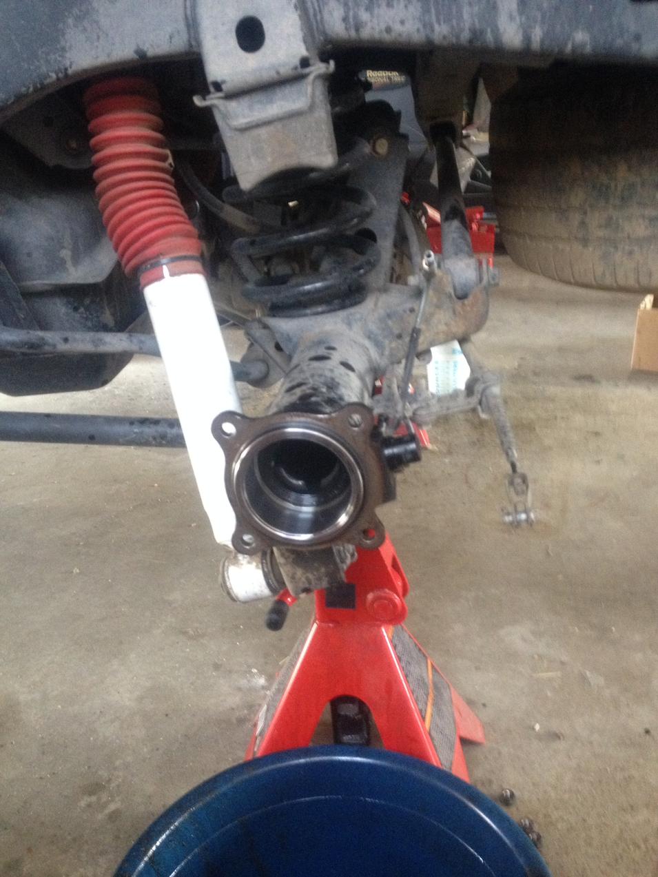

Axle seals and brake shoes
Diff breather clogged, causing seals to leak, causing news shoes and lots of clean up!

Good to go!
New seals, brake shoes...check your diff breathers everyone!!

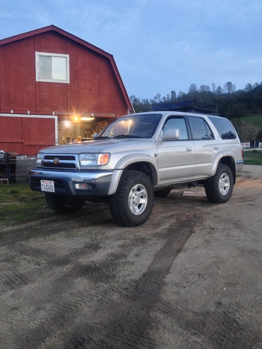

lifts on. OME 881/890 on bfg 265/75/16 top is stock height same tires.
Following....Looks good so far. I just got my family 2000 4runner limited. Catching up on all the maintenance and going from there. I'm interested in how you like the OME 881/890 kit?
To be perfectly honest, I love them. Not "kit", just the coils, made such a different truck. I did get around 3" and a small spacer that comes with them was put in front for less rake...and after 6 months, I haven't seen any droop/settling. For around $165 per pair and the ride quality I have whether weighted or not, they're fantastic.

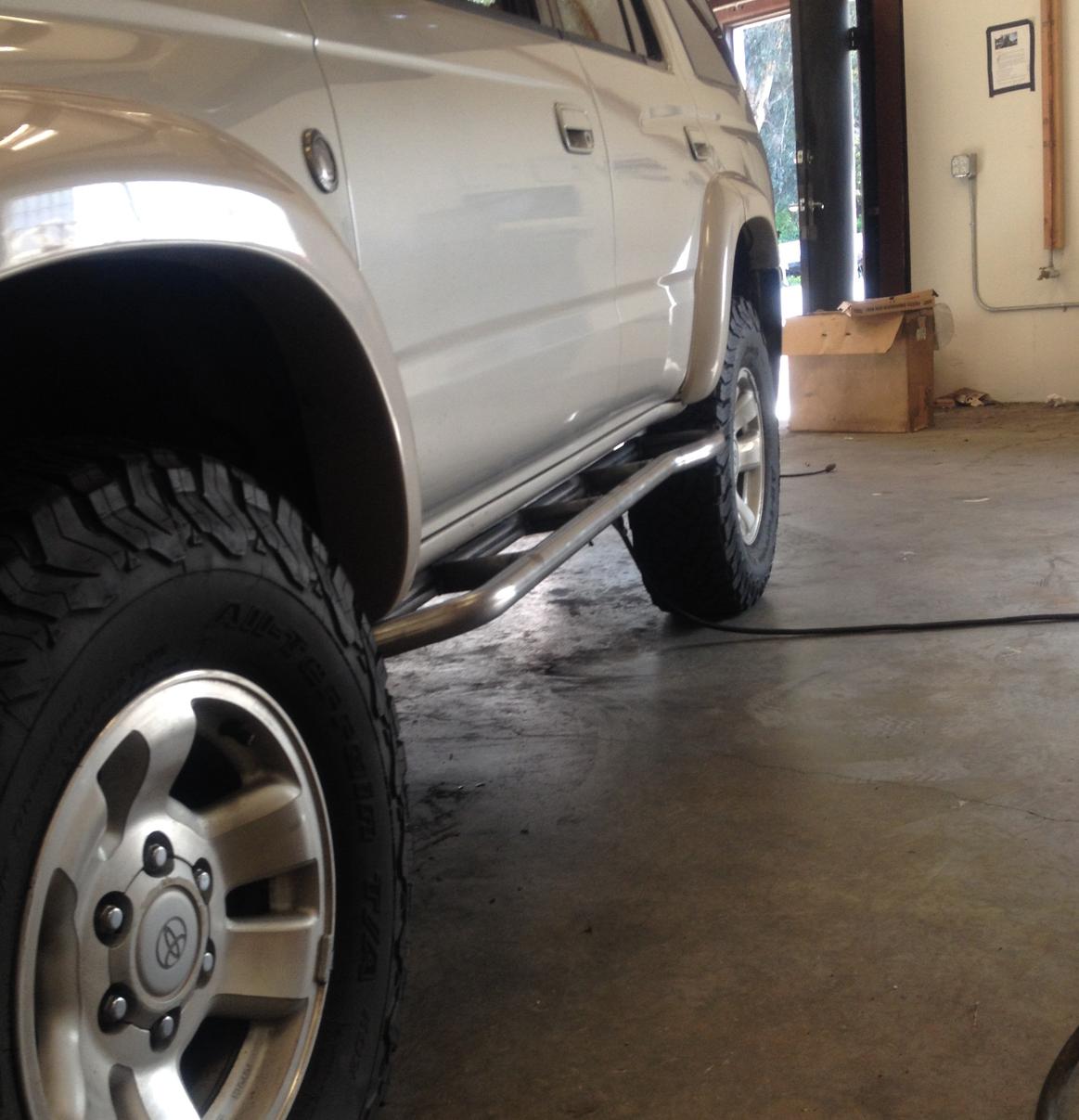

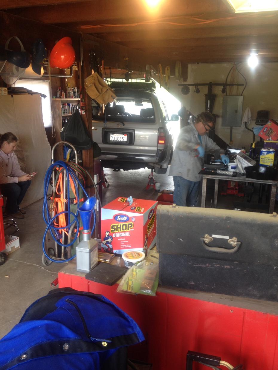

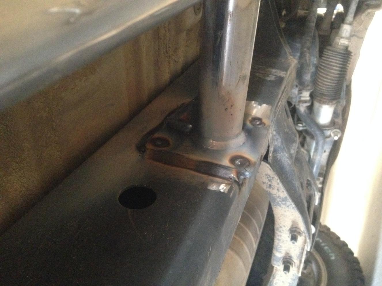

Slider install day
Serious serious welding skills by [MENTION=138171]Lornejohn[/MENTION] Thanks man!
