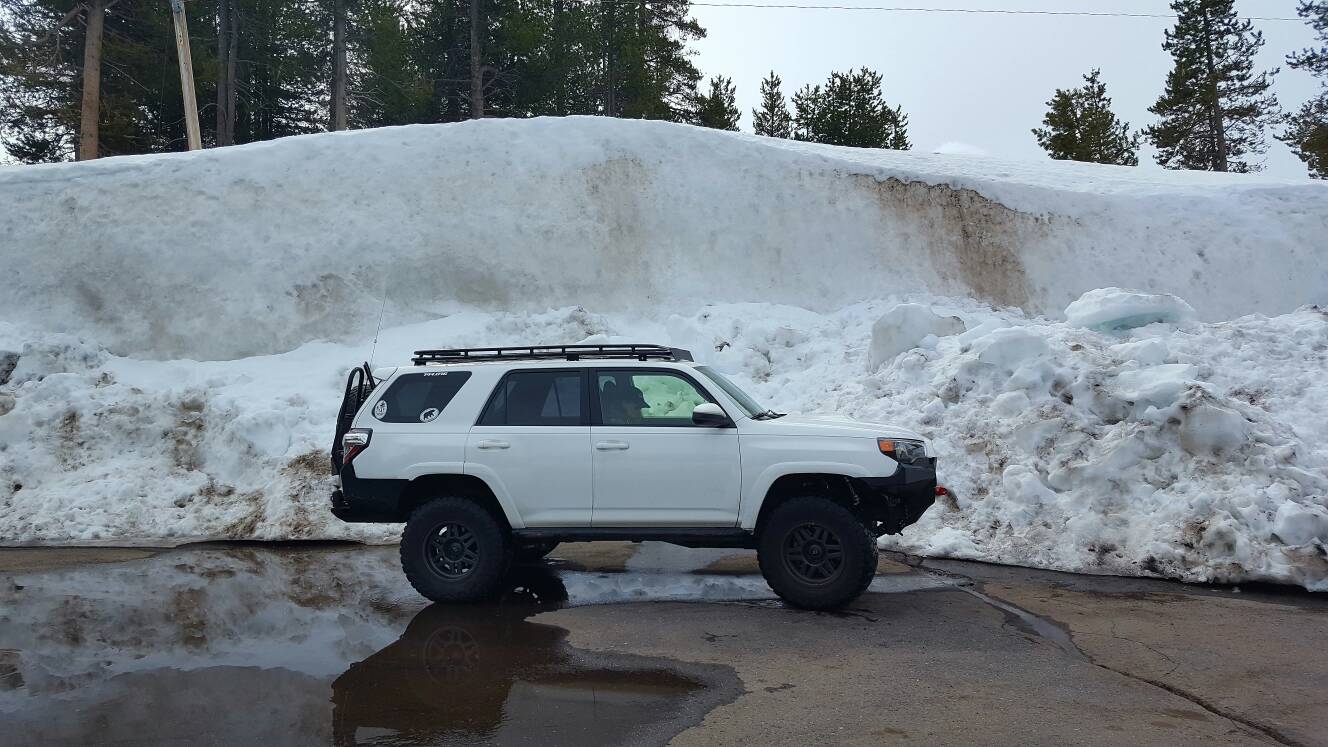

A quick run up to Bear Valley for some coffee and to see how much snow there is.

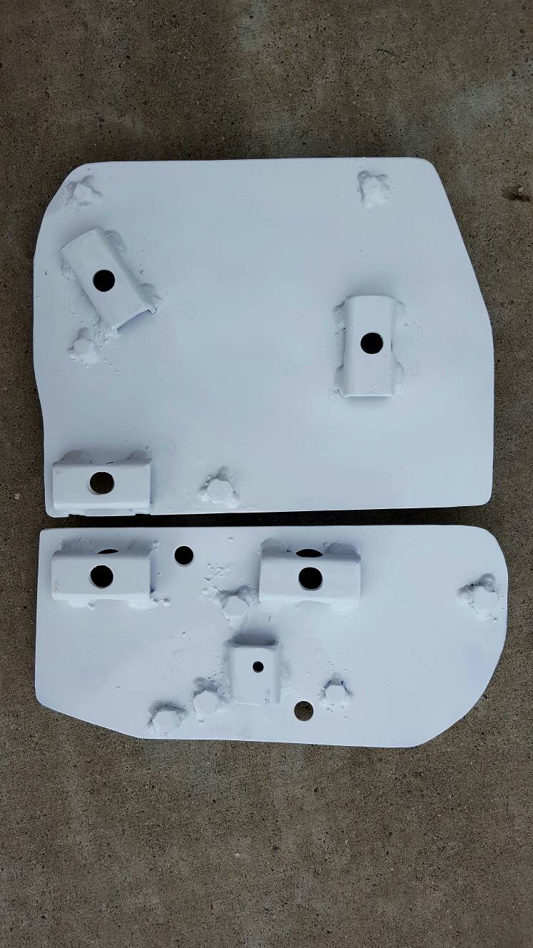

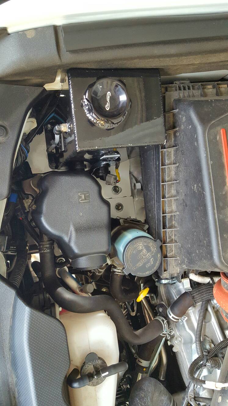

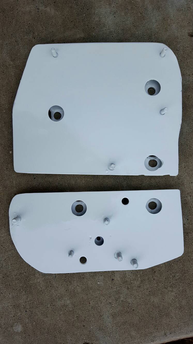

Well, after almost 2 years with out a washer bottle reservoir, that drought has ended. Finished fitting up everything and welded all the bolts into place and everything fits and functions once again. That was a long 20k plus miles of dirty windshields.
The mounting plate.
Installed

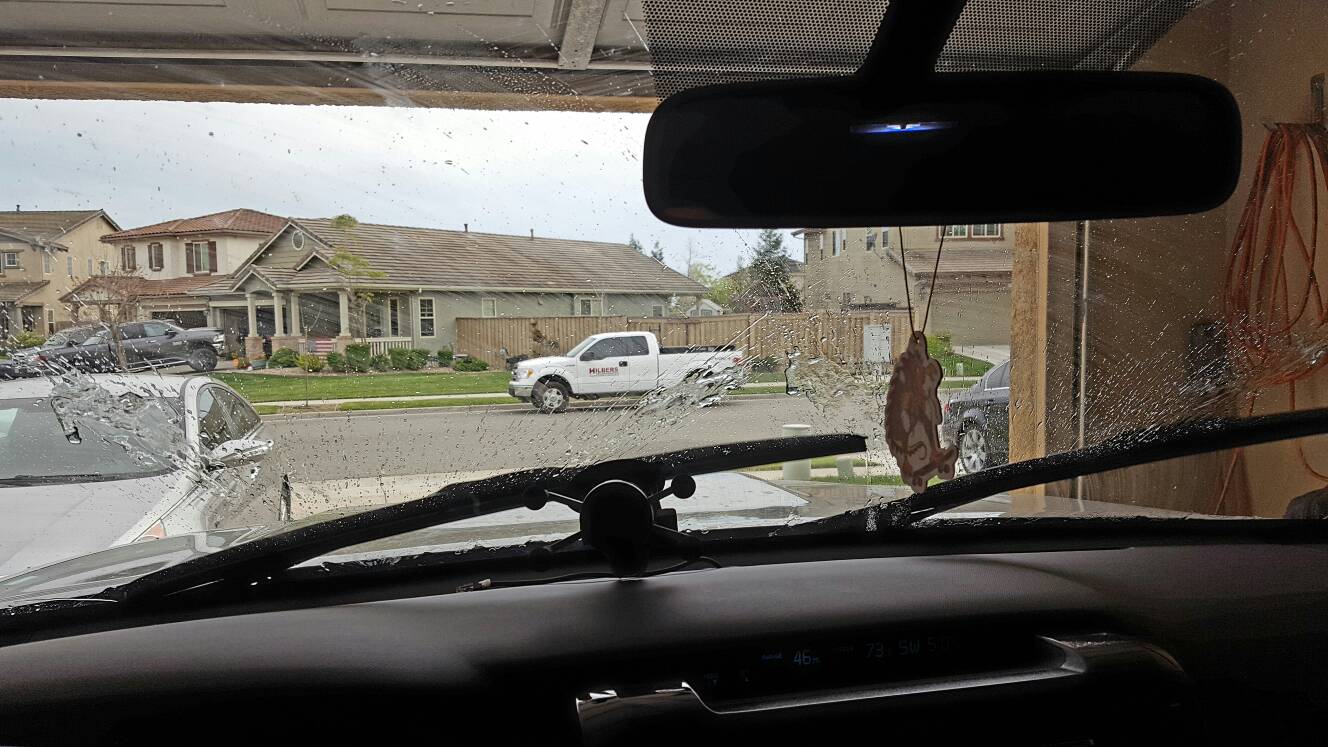

And damn, it works!

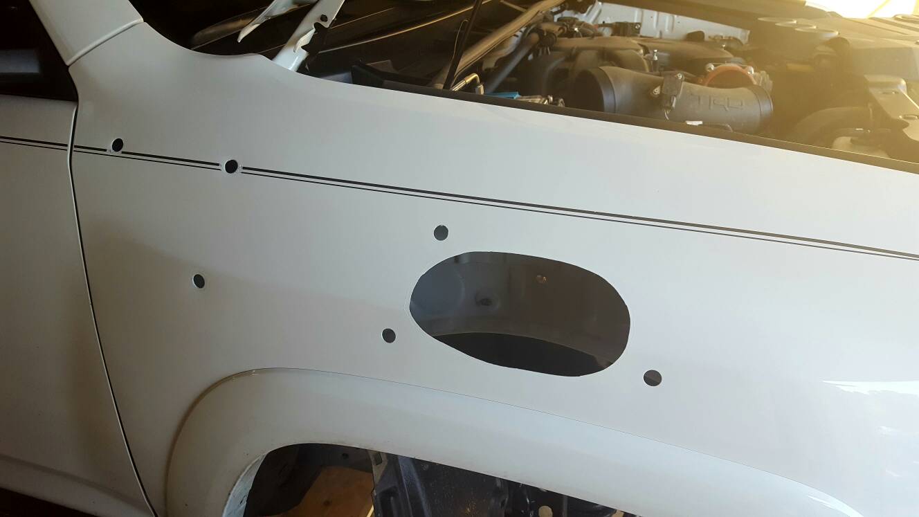

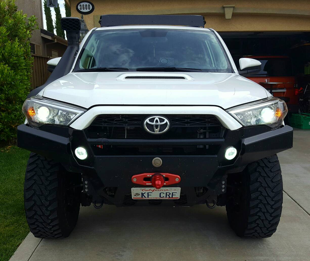

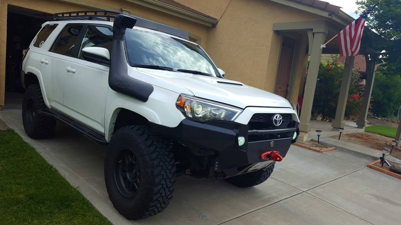

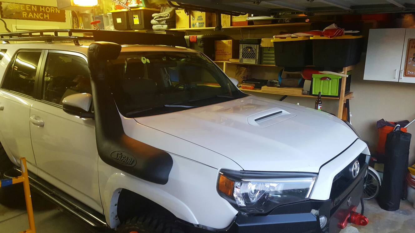

Finally got around to installing the snorkel that arrived in the beginning of March. Best way to take the edge of, a hoppy IPA before getting started.

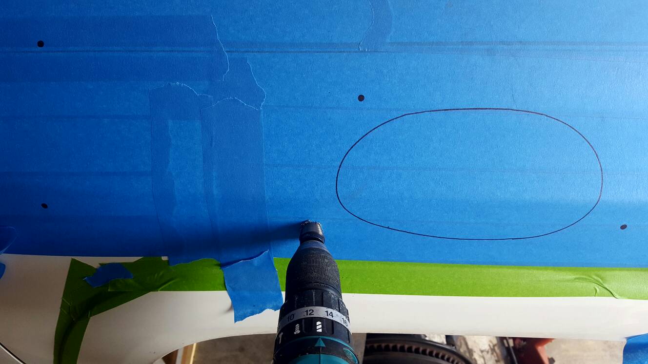

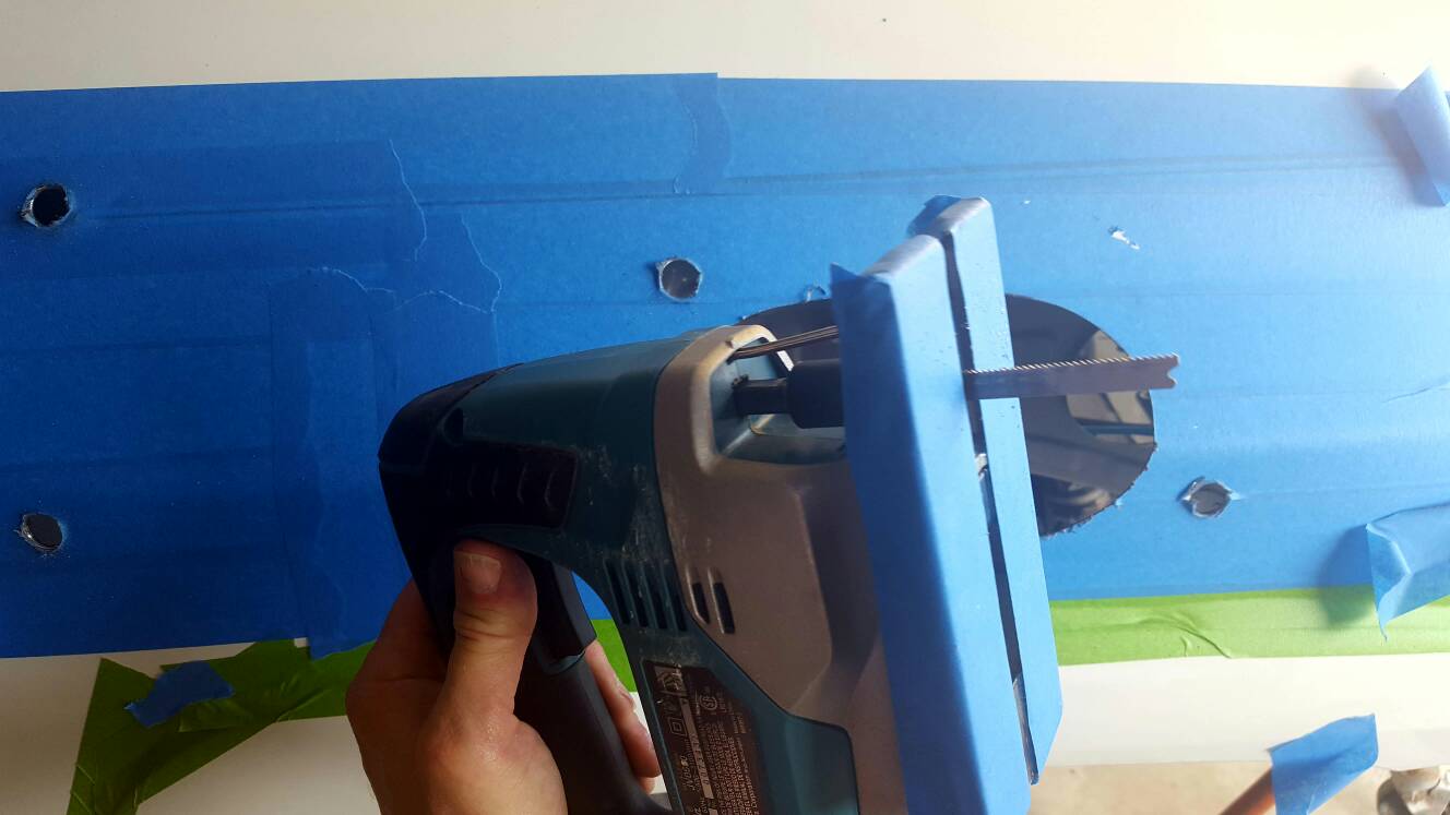

Then, tape off the area, break out the sharpie and look at all the holes, especially that large one. Hmmmm, better take another drink ...... or two. Drill the holes with a step bit and a the on to the big one. Used a jig saw with a metal blade and taped the base for protection. The thing cut fast and smooth. A little Dremmel action and polish off the beer and crack another.
Everything went fair smooth and wrapped up in about 3.5 hours.

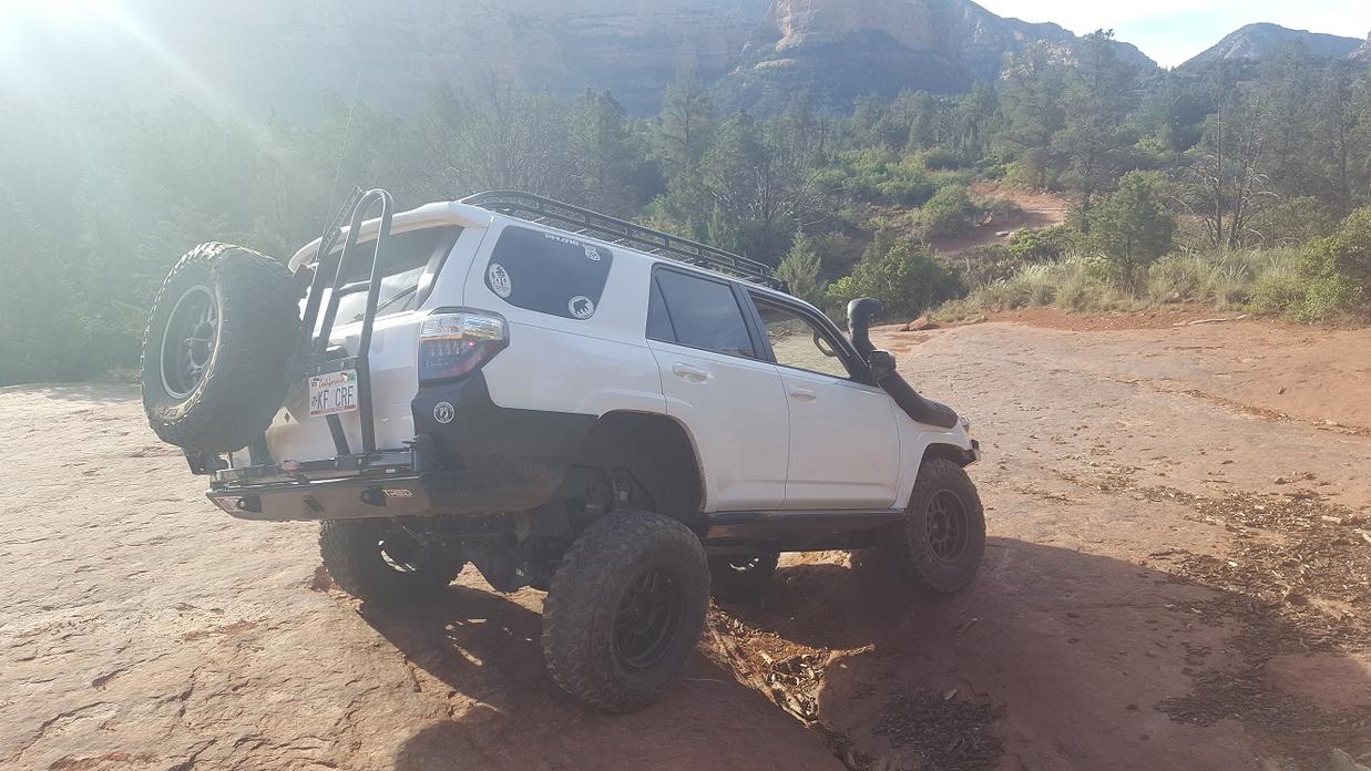

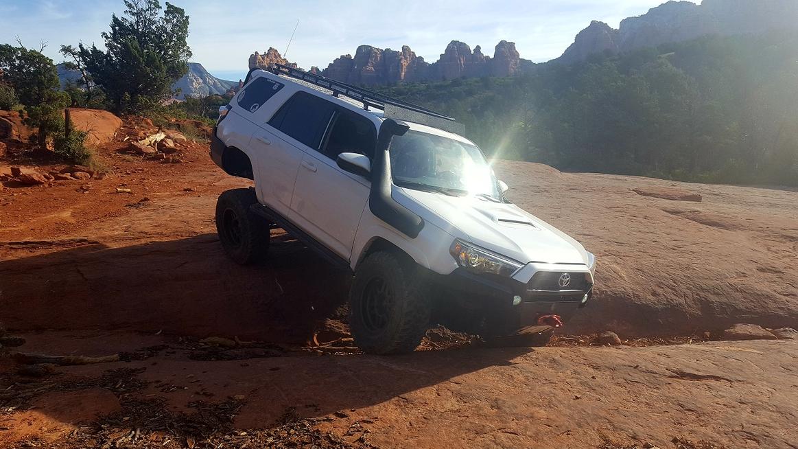

Also, I could not go all the way to Arizona and not get in a little wheeling. There is a trail on the South side of Sedona called Broken Arrow. It is not a very long trail and not too difficult, but fun none the less and again, some awesome views.
