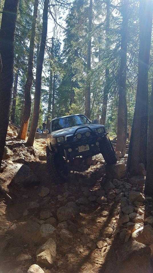

Saturday was a long day and an early start. Met [MENTION=88231]having fun[/MENTION] in Sacramento at 0530 and headed up the hill to meet up with [MENTION=106195]v_man[/MENTION] in Arnold at 0730. Everyone was prompt and we filled up as this was the last stop for gas. From there, we headed up to the South side trail head and aired down and headed into the trail a little before 0900.

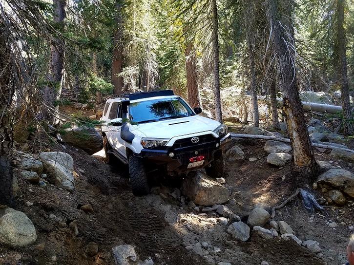

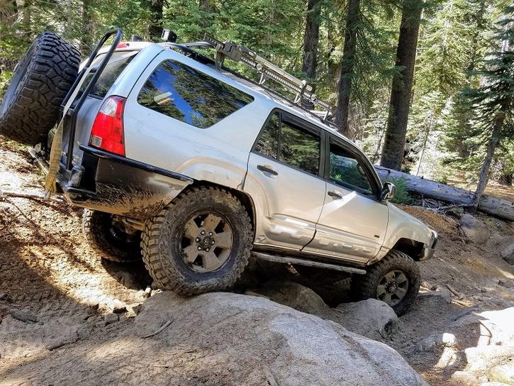

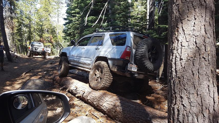

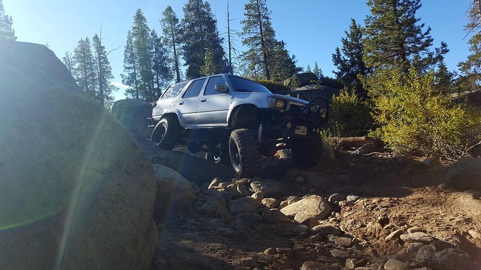

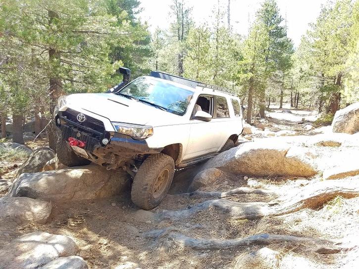

From here on, it was a heck of a trip. It wasn't too long before Leonard tried to follow Vince up an obstacle and got a little stuck. We pulled up the strap and freed him for a new line, (lesson - do not follow a SAS on 37's over every obstacle.) From here, we were at the stair case. Leonard and I opted for the by-pass, and we watched Vince come down.

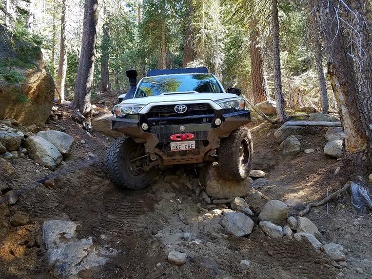

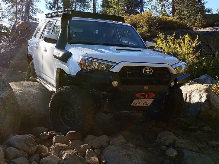

After Vince, Leonard and I headed down the bypass, which is challenging and requires a good line. Leonard made it without backing up, I was not as fortunate.

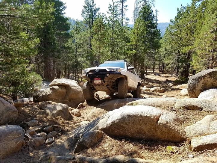

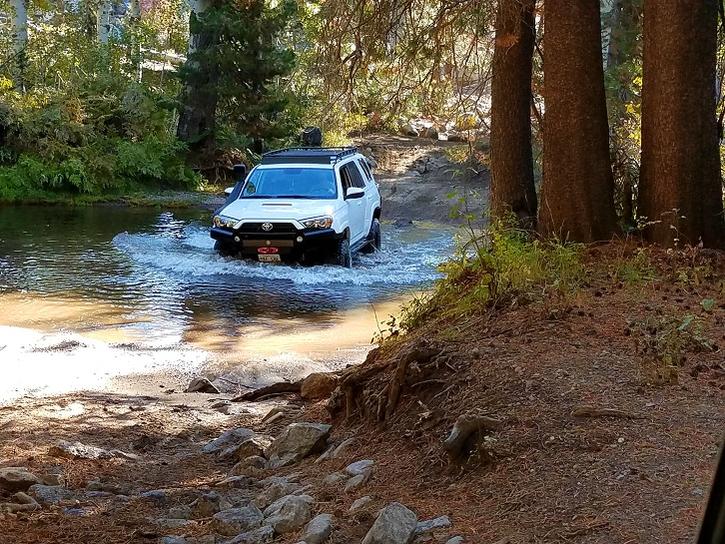

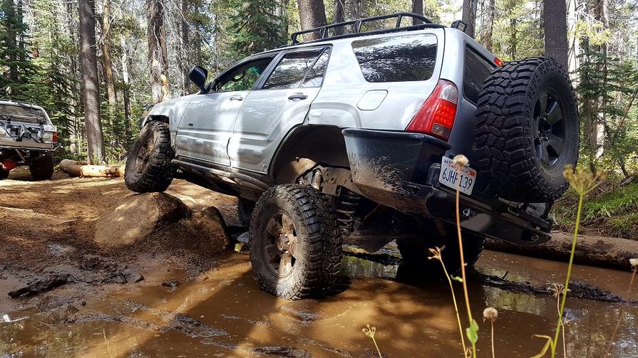

From there, it was on to one of the many stream crossings for the day.
We continued on and had a good time. There were a few other spots that posed some difficulty, but we all made it through. We only passes one group while on the trail. We were off the trail before 1130 and then headed up the pass to Hermit Valley.

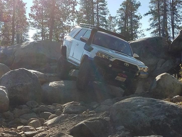

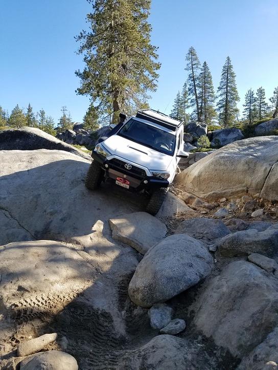

I believe it was about 1230 when we headed into the trail. We paused for a moment while a group in front of us were making their way through the Gate Keeper. Then is was our turn. In typical fashion, [MENTION=106195]v_man[/MENTION] made quick work of this obstacle in his well 2nd Gen, [MENTION=88231]having fun[/MENTION] was next and made it though with-out incident and then my show. A few spots from Vince and I was through quickly, too.
From there, this trail was the trail that just kept giving, all the way to the other side. Long uphill boulder fields, tight squeezes between trees, which exploded by drivers side mirror. Spots between a rock and a hard spot, obstacles that would have been a little easier had that large rock not been in the middle of the trail.

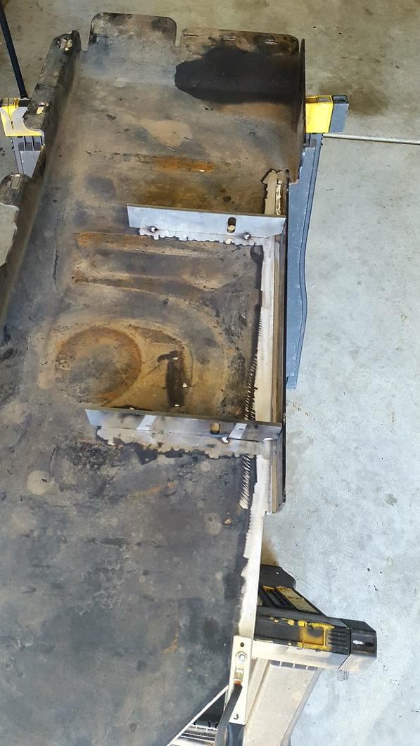

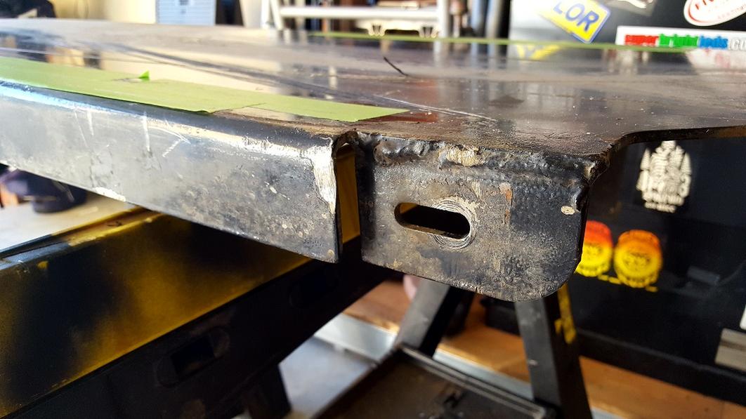

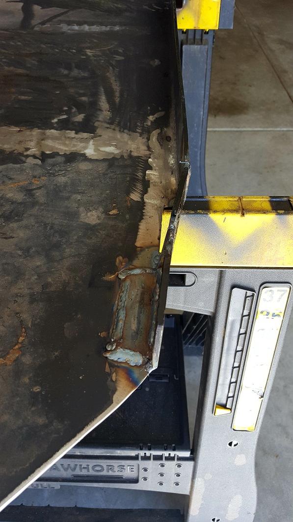

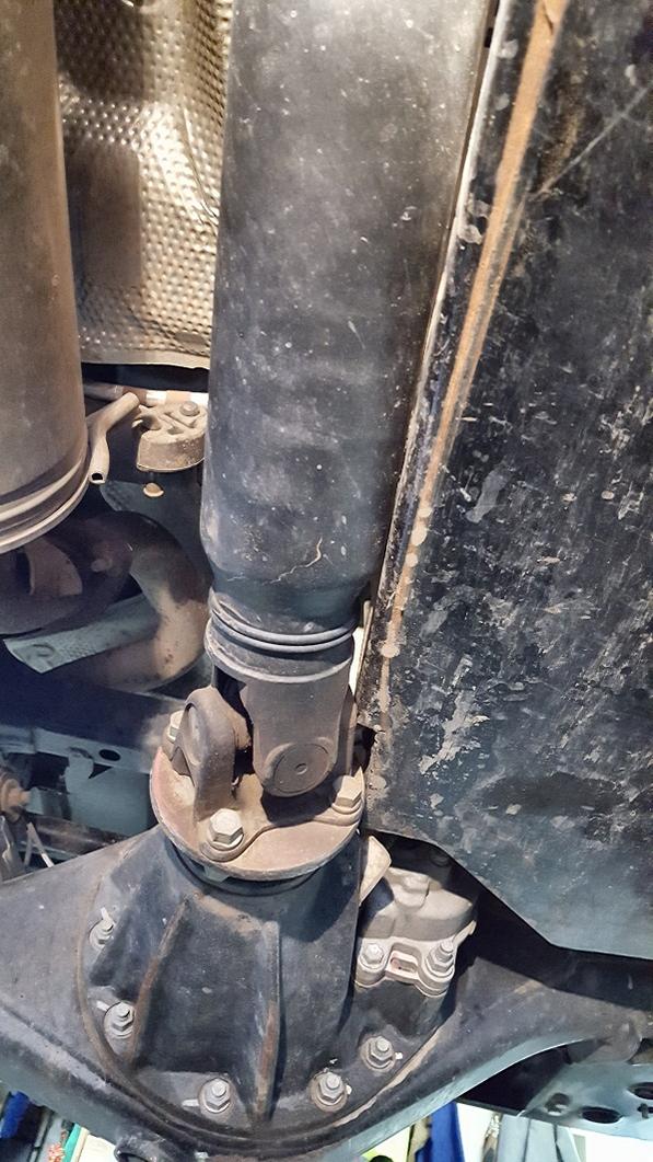

A couple of weeks ago, while greasing the suspension, I found that the drive shaft was hitting the gas tank skid. I thought I had fixed this once, but it appears the fix was not enough.

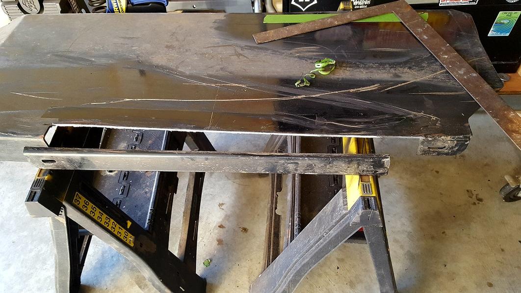

This weekend, I dropped the skid and started cutting. I cut the entire edge off along the shaft , ground off some extra metal and the rewelded the edge back on. I ended up moving it about 3/16". At the very end, where one of the mounting holes are for the bracket, I moved this area back a good an additional 1/2". Have everything welded back up and welds ground flush. Next, I need to reinstall the skid and beef up the hanger support closest to the diff.

Been having the same problem also. Had cut out the rear bolt location and just weld the hanger on the plate and reinforced. Noticed each time I go out, I have had to cut more each time along the plate. Still need to do some more from our last run.
