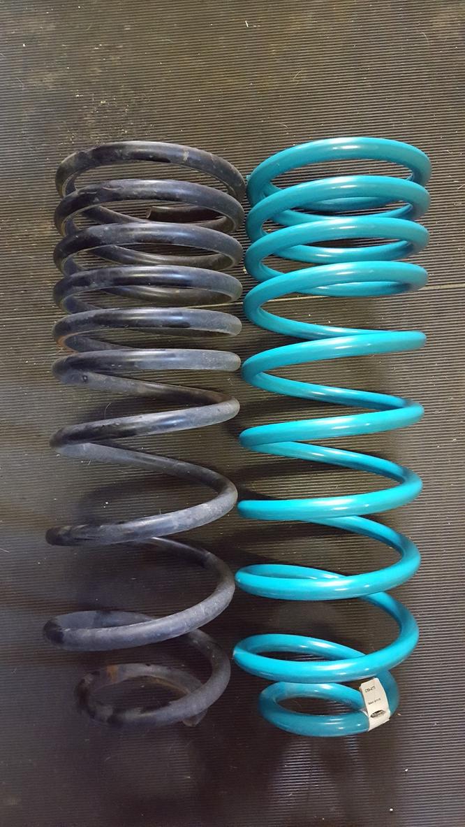

I have been a little disappointed with my rear coils. They flexed well, but I was constantly hitting the bump stops just going down the road carrying very little stuff. I had the Metal Tech LT-HD springs.
At Overland Expo West, I spoke to Metal Tech about a high capacity spring, but due to lack of demand and cost, this was not something the would be considering. I then started talking to Dobinsons and it sounded like they had some availability and options. After I returned, I started up a conversation with Mike and went through my issues and gave him some measurements as well as some estimates of additional weight. He recommended the C59-677V rear coil.
I decided I would give them a try and order direct from Dobinsons. Mike had them shipped out the same day and they arrived within a few days.
Over the weekend, I got them installed. Damn, that is a pain in the ass! I had to remove both upper links to drop the axle down far enough to get the coils out. The upper control arm was limited in down travel by the gas tank. Ended up having to remove the gas tank skid in order to get the coil in. After a good 4 hours, I had everything back together and enjoying a cold IPA.
Hoping to get some trail time this week for an update on their ride and performance.

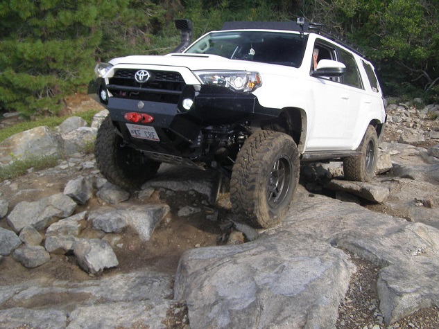

Pic for comparison.
Pic for comparison.

First impression while driving California's level roads are they are much more firm, never hit the bump stops, which was normal on this road. Even felt like there was less body roll than normal, most likely due to their stiffness. Looking forward to see how they do on the trail, and if all goes well, I am planning on running Sourgrass tomorrow.

Swapping to these springs netted ZERO additional lift or loss. The truck sits exactly like it did with the Metal Tech HD springs. As far as how they are handling the weight, it seems like, at this point, they are better. Will need to see after the break it and get some use.
