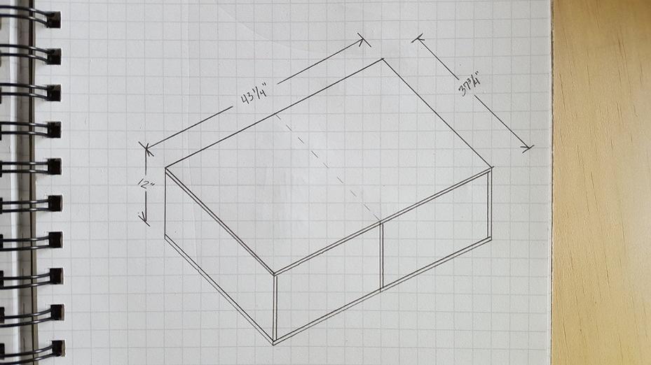

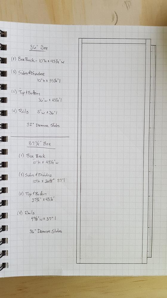

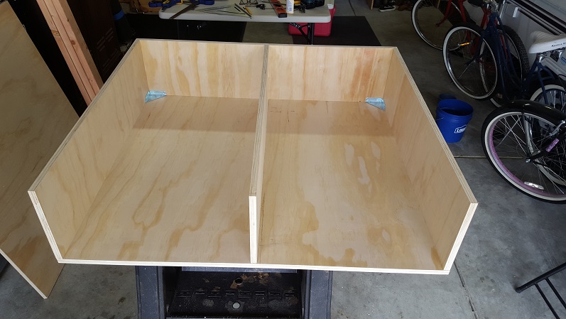

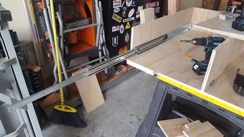

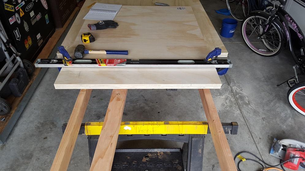

Well, it is winter time and work is slow, so it is time to start the build of a rear storage box. Detailed up plans at work (the old school way, on paper), and made my cut list. Have everything cut now, with some minor cuts to still make. Ordering some 36" HD drawer slides today.

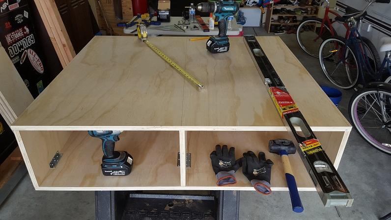

A little more progress on the storage box. Waiting for slides and latches at this point.

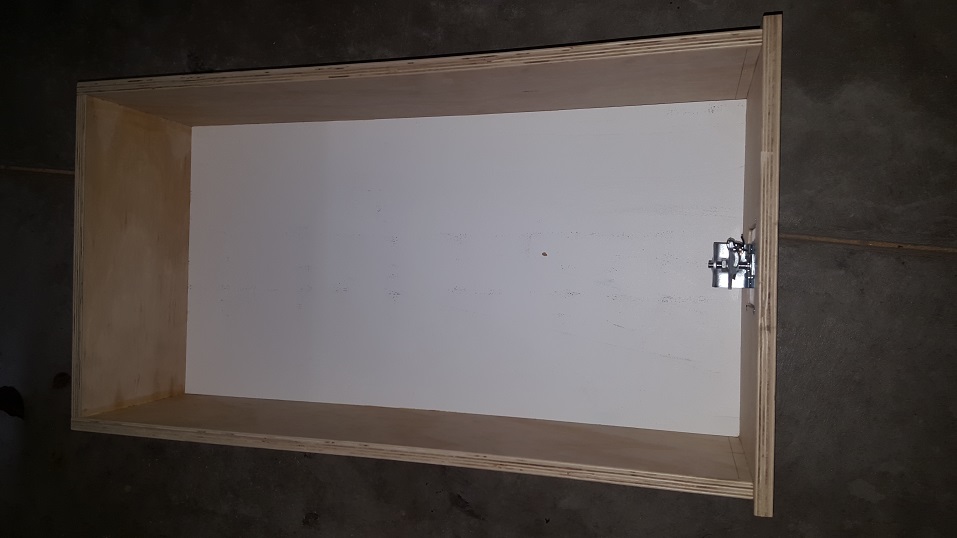

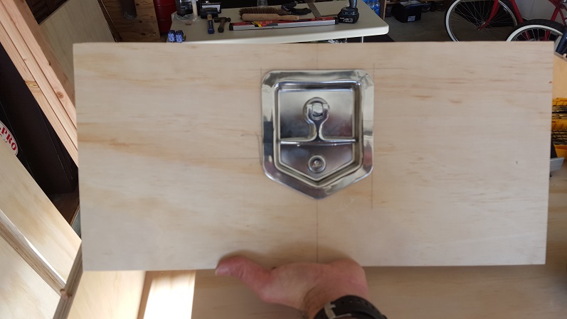

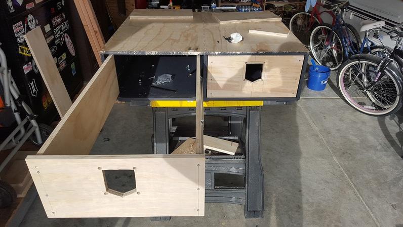

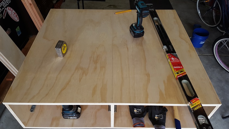

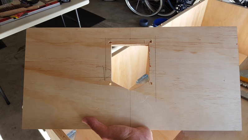

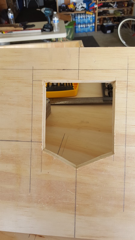

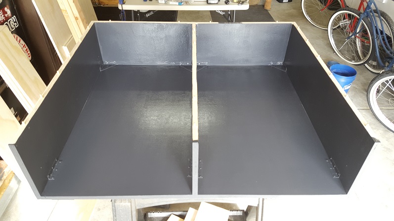

More progress on the storage box.

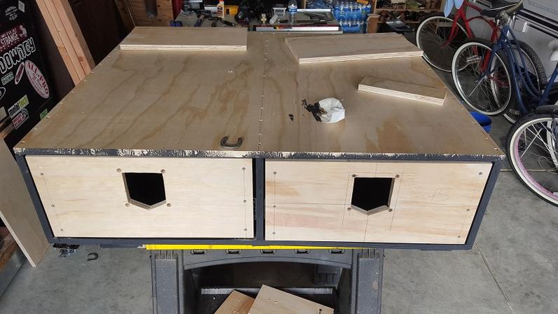

Finished the drawers yesterday. Now to fill all the holes, sand and paint. Also need to fab a catch for the locking latch.
