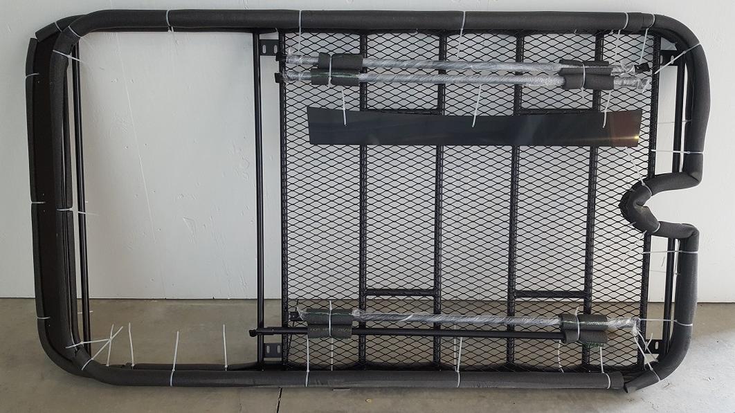

After waiting, oh, about 10 months, you can now assume what was delivered by that info alone.
A Drabbits rack. Hoping to install (at work) Thursday, since I have plenty of help here.

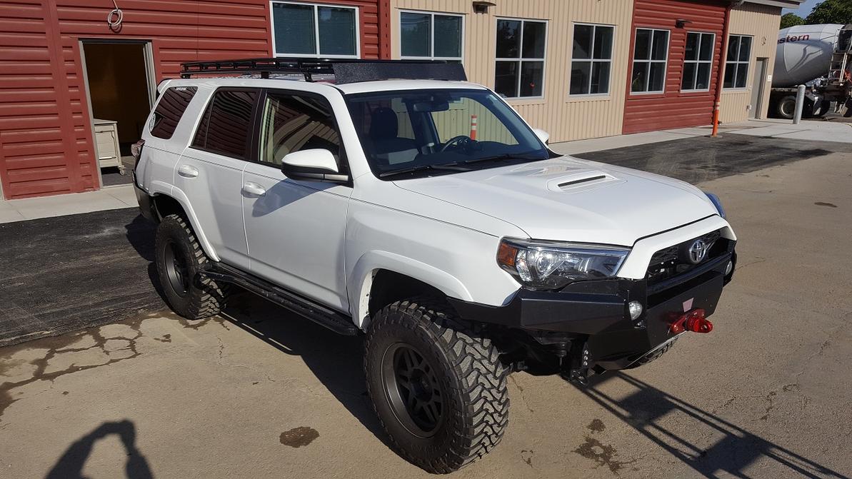

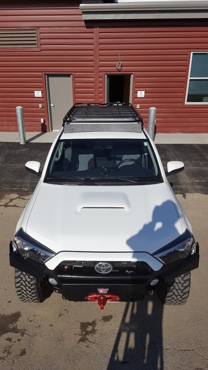

Drabbits rack installed. A full commentary / review to follow once the order is completely resolved.
I give you (and Mikey since he has been impatiently waiting);

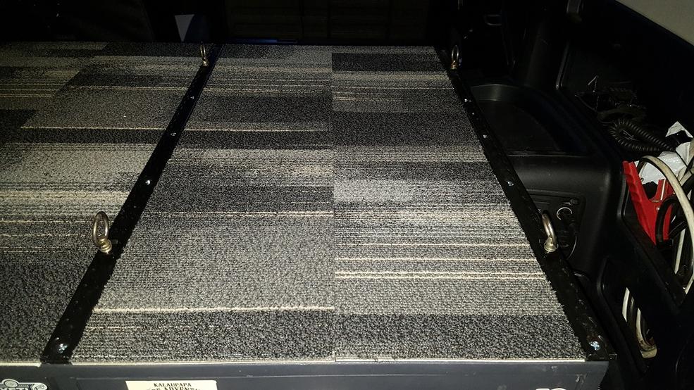

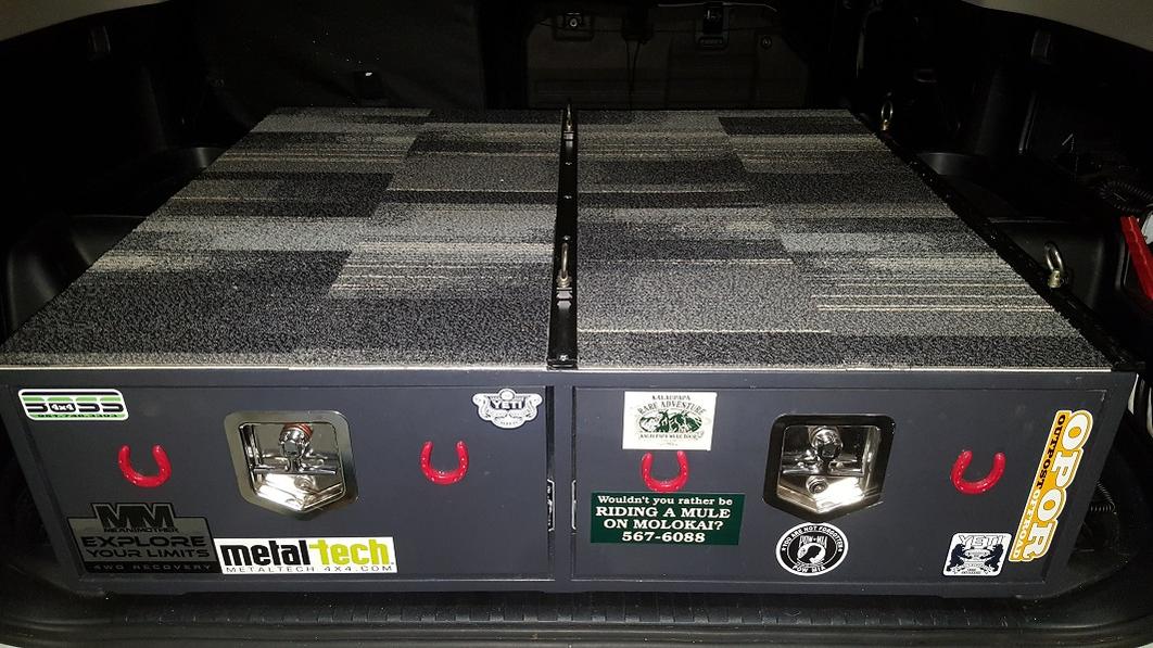

Ordered these Pit Posse tie down rails about a month ago, just got around to installing them and cutting the carpet tile to fit.

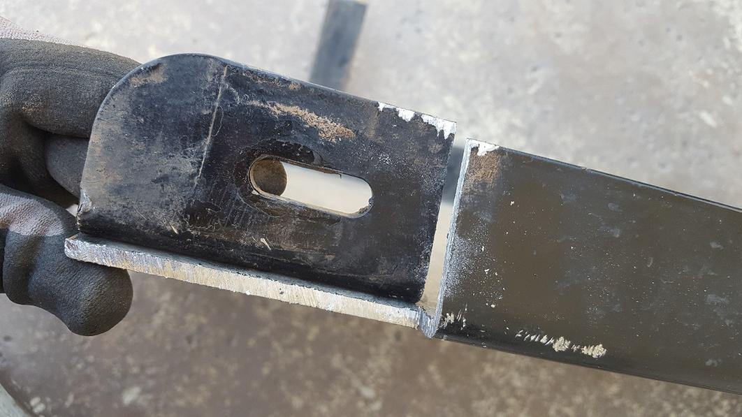

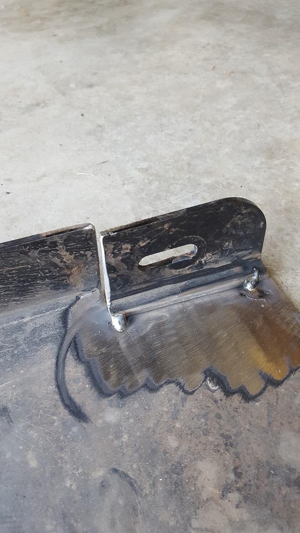

Only thing I didn't get to was diff oil. So it started out by removing all of the skids to change the oil. What a pain in the ass. Then on the the oil change referencing Antman's helpful thread. Noticed that my one free oil change at the dealer meant no more index tab on the filter cover so had to fake that one.

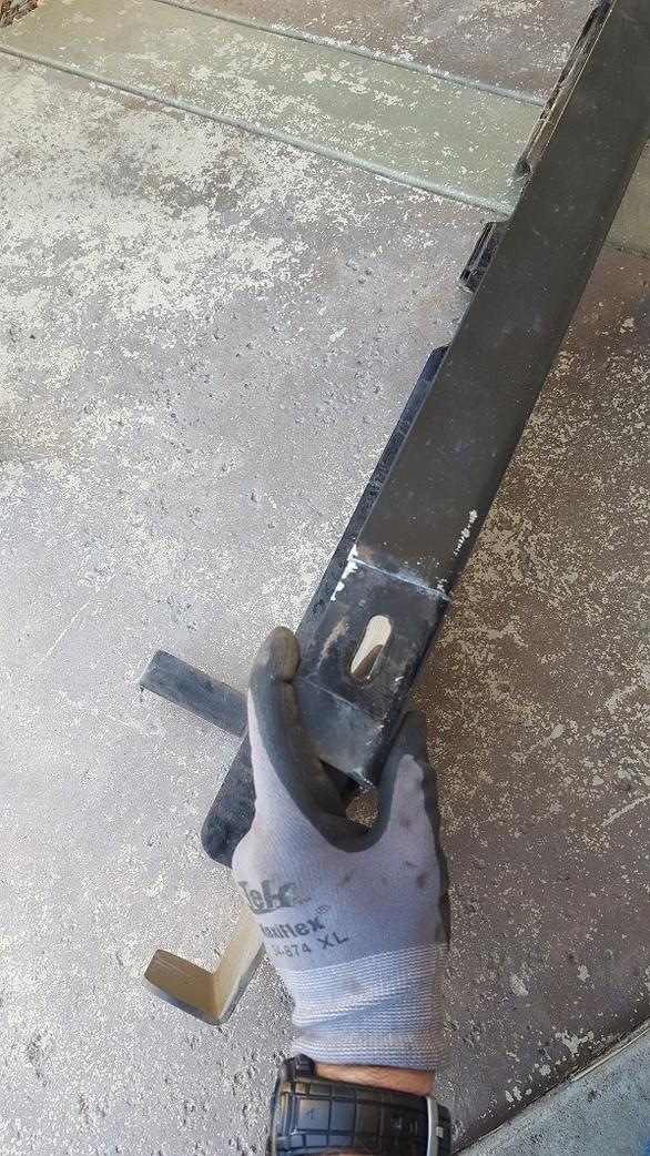

Next was modifying the read inside mount for the gas tank skid. I had noticed that the drive line flange was rubbing on the mount / bolt. wfo9 had this issue a while back. So I broke out the sawzall and started hacking. THen welded in the mount about an inch back. Should be good now.20160430_091708.jpg
