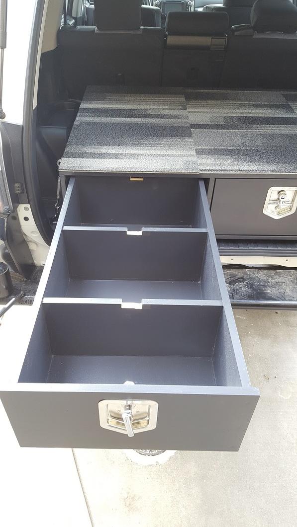

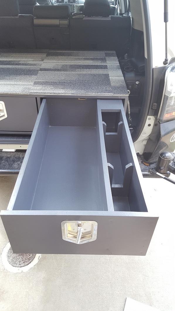

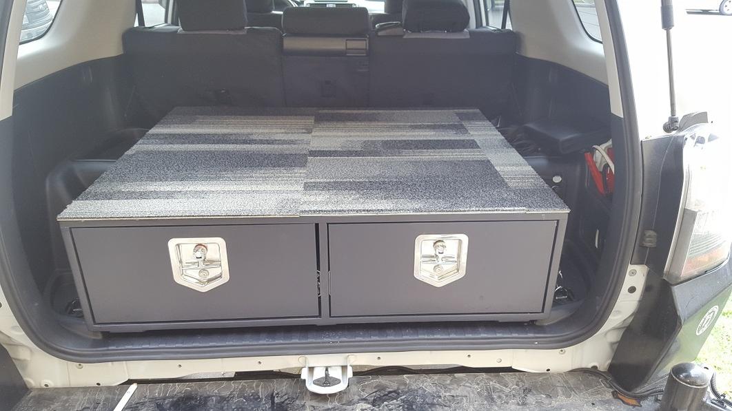

Pretty much wrapped up the storage box before Christmas. Have some minor thing to complete, but it is securely installed in the rear of the Runner.

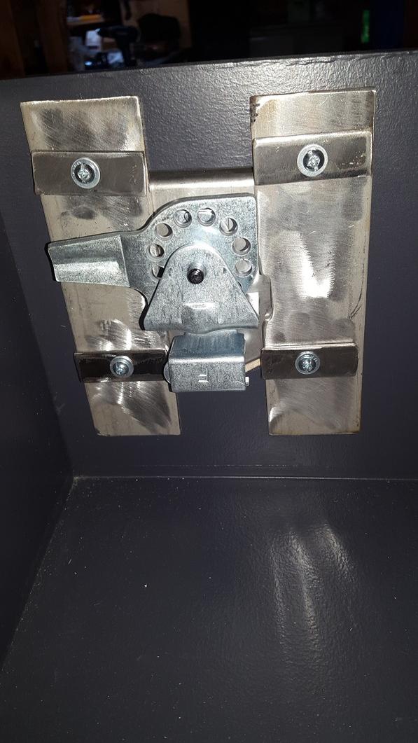

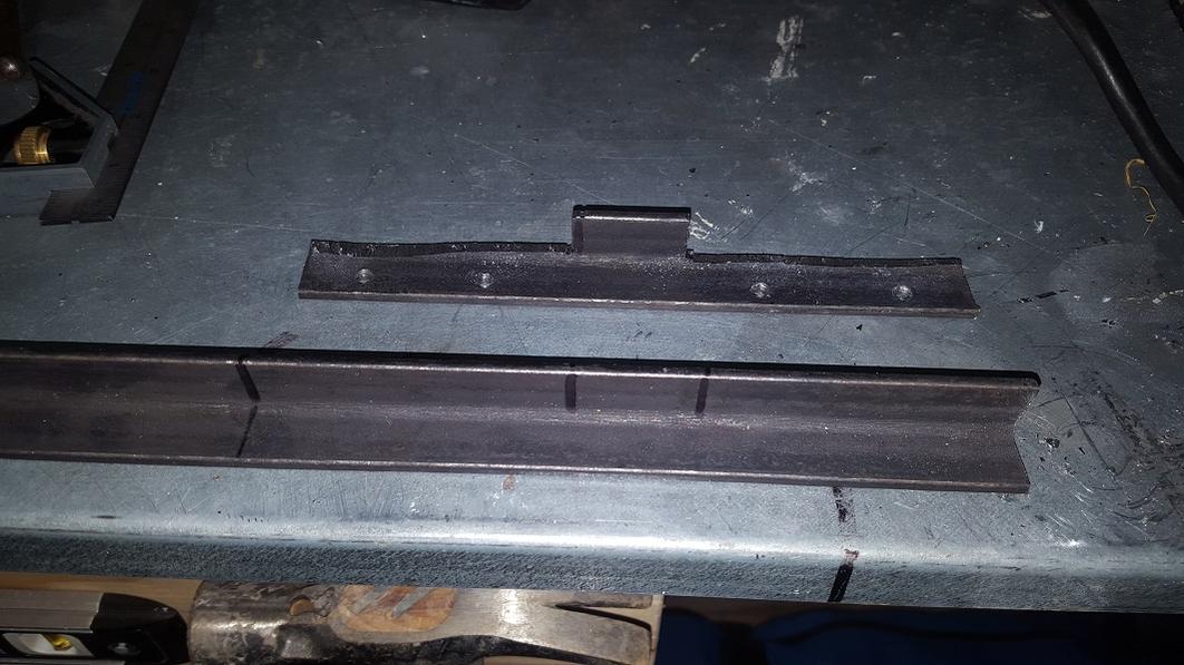

Fabricated a catch for the latch in order to secure the cargo and lock up.
Installed in the back. Used some leftover carpet tile from a project at work.
Dividers in one drawer. The furthest back is large enough for antifreeze and oils. Had to notch the dividers for the catch.
Built in a special "hardware" holder. Need to build a hinged lid with cam lock for additional security.
Need to clean this up a bit, but since there wasn't much wood left for a secure lock, added some flat bar to reinforce the lock/handle.
Awesome work. I am planing something similar to this.

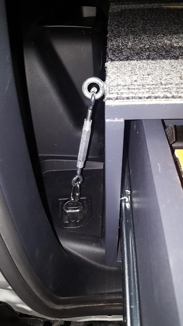

How did you attach the drawer box to the Runner?
How much does it weight?
awesome work. I am planing something similar to this.
How did you attach the drawer box to the runner?

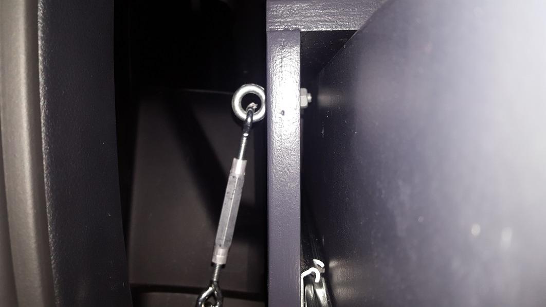

i am curious how you attached you box too. Started to design in my head on the drive home tonight.
Used an "I" bolt with fender washers. Had to cut the threads to length as it was 4" long. Clean-up the threads with a grinder and flapper wheel. Attached to the four points in the truck. Pretty much like a lot of people have done and also, easily removable, if needed.
As for weight, it's heavy, almost two sheets of cabinet grade plywood and four 34" extended heavy duty slides
Mikey, for reference, besides screwing the whole thing together, I also used ¼" wood dowels, which you can see in post #137 and wood glue. THis thing is NOT coming apart.
