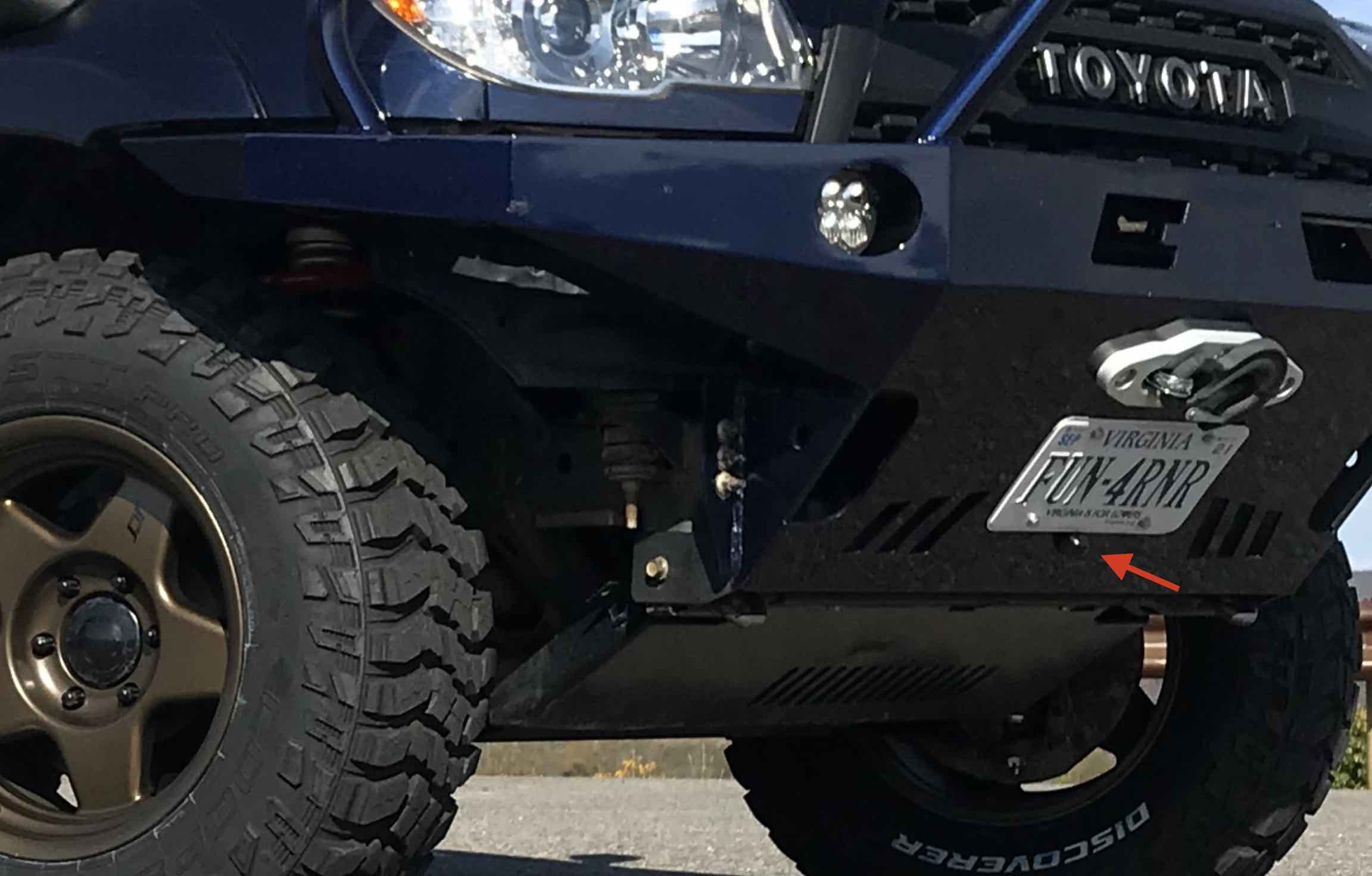

Thing I wanted was to see tire placement, it worked awesome when I had the factory bumper cover. I was able to get it in a spot far enough out to see both tires.
Presently I have a Coastal bumper and it's mounted just below my license plate facing rear, tough to find a good spot that gets the view I had before.

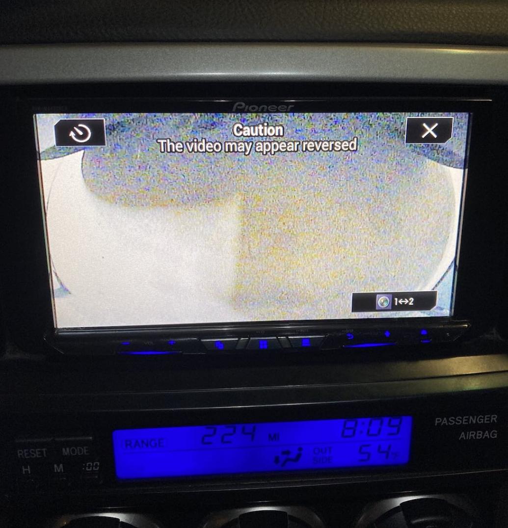

It's nice sometimes, but honestly not as useful as I'd hoped... helps when solo to make sure I'm not WAY off line.
Couple pics... crappy one of the display, just snapped it in the garage.
