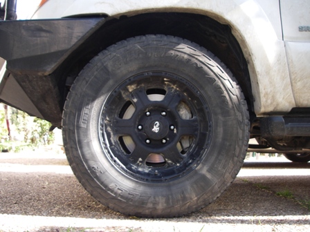

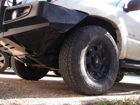

Brilliant crazydubman! I am running a 2008 SR5 w/v8 and FT4WD with ARB front bumper, the RevTek 3/2 lift/level kit and 285/70 R17 on Procomp 17x8's. I appear to have good clearance all around after removing the front mud flaps and no other adjustments. In fact, observing the same potential to rub against body mount flange with larger tires, but now with the knowledge of the potential caster adjustment, I am considering 315/70's because it looks like another inch in radius will clear pretty easily. Questions for ya:
1. With the caster that far forward, what is the next closet thing you would rub if you went with bigger tires?
2. How come you haven't gone with 315's, or even 35's? It sure seems to me these should fit with no cutting at all, at least on a 2008.

I am optimistic that the ARB front bumper handles the bumper clearance issue, even for 35's. The pics below are for 285/70's (32.4" actual diameter), meaning one would need about another inch in radius to support 315/70's.
