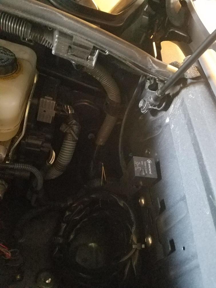

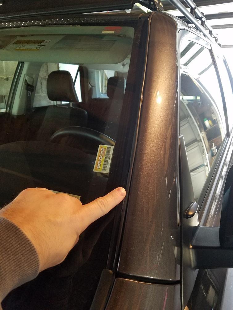

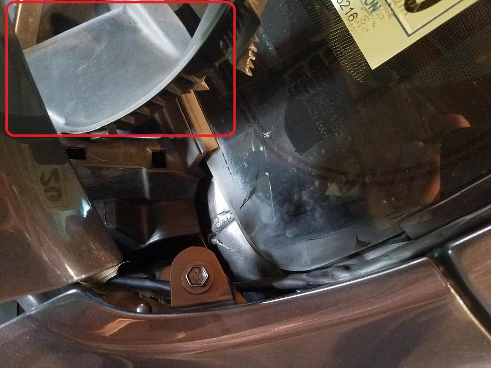

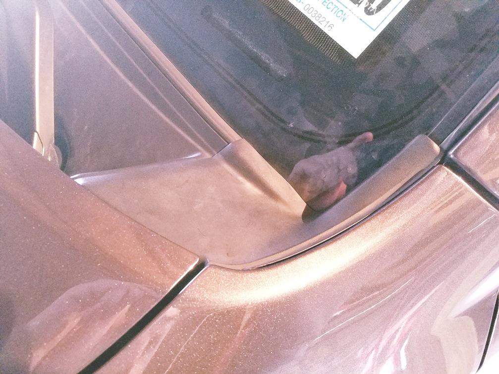

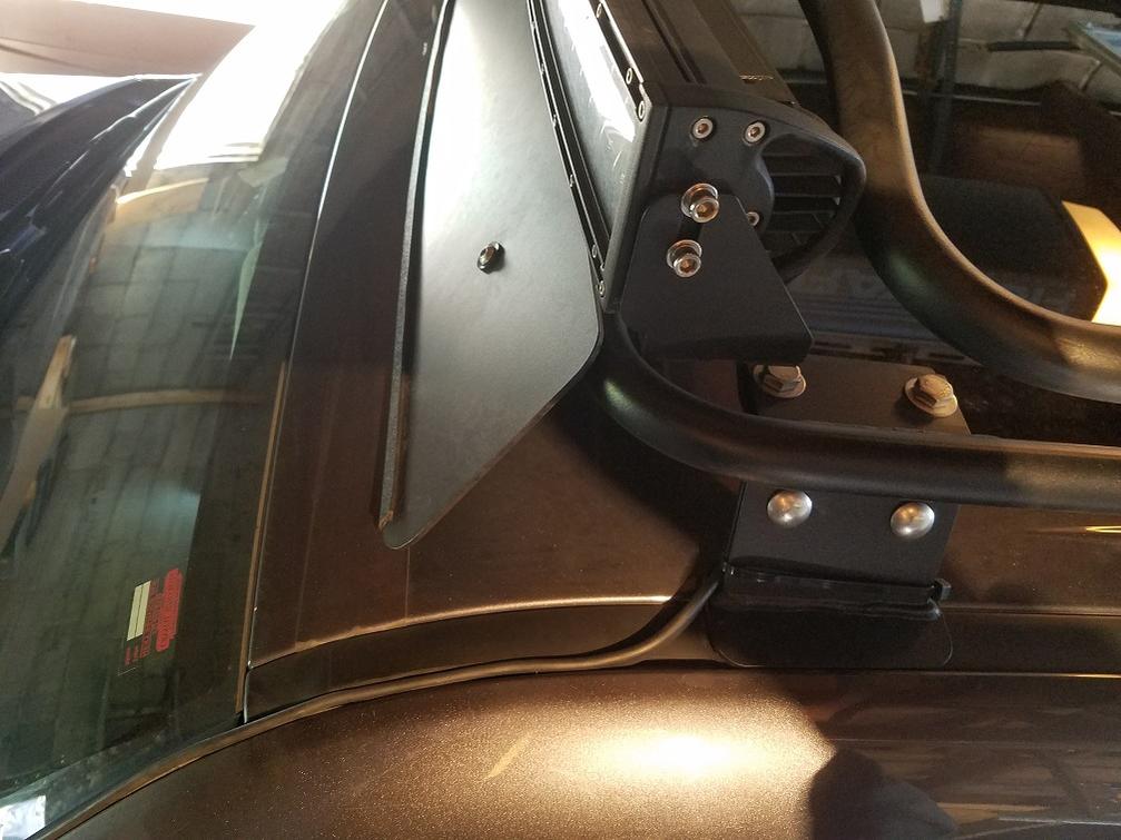

ok, here is how I did mine. I used a rigid wiring harness and removed the wire sheath for wire running up the pillar. I then put heat shrink over the wires.I bought a $60 light bar, and wasn't sure if it would last, so i used double sided tape rather than a silicon in the pillar channel to hold the shrink wrapped wires in.
Most guys do not have to trim the weather stripping on the roof to accommodate the heat shrink wires, but I did.
