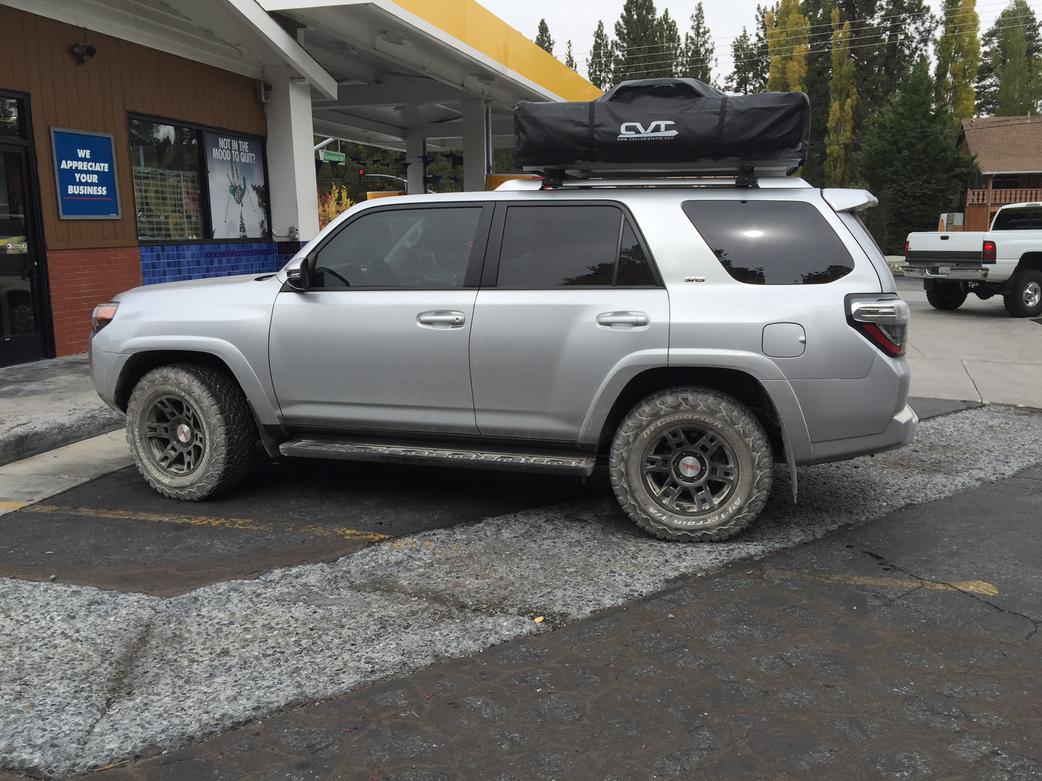

I have an Autohome AirTop mounted to the factory rails with Yakima Rail Grab towers. The reason I went this route instead of the new roof rack route was because it's much easier to remove the RTT for storage. I just loosen the 4 bolts on the Yakima towers and lift it off the rails, Yakima bars and all. It's kind of a pain to remove/install the RTT using the RTT mounting hardware since there are 8 bolts and very little room to maneuver your wrenches under the rack.
As it sits now, all I have to do is drive under the RTT, lower it, position it, and tighten the 4 Yakima bolts. Takes about 15 minutes.

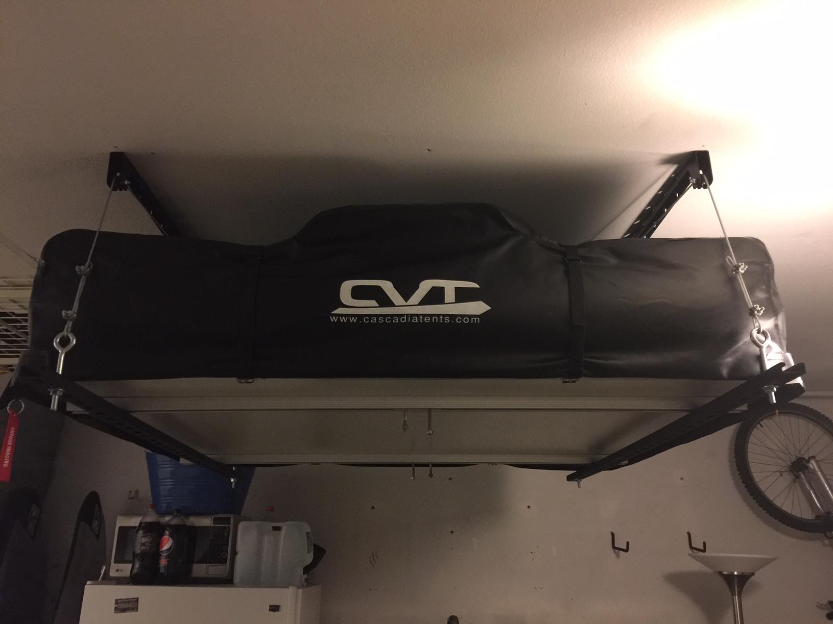

We are also using the Yakima crossbars and secure the tent with the Yakima snaparounds. This allows me to load and unload the tent using only 4 mounting bolts. I also installed the Racor lift, available on Amazon for about $100.
Roof Top Tent on Yakima
I tried mounting directly to the roof rails, but the tent rails scratched the rails pretty easily and it was more cumbersome to remove the cover to install the annex.
We will be upgrading the the Baja Rack Flat Utility rack, soon.
Good luck!
Man, I'm jealous of that hoist system!
