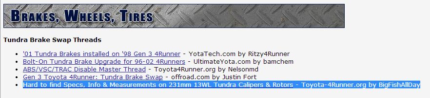

How much is a mechanic going to charge to do the tundra swap and will a book rate mechanic even do that?

They are 16" 5 star wheels. Brian, thanks for the link. Very good read, however i doubt that my small shop mechanic will do all that grinding. Unless 2002 Tundra brakes will fit there with 213mm calipers w/o any mechanical grinding.
