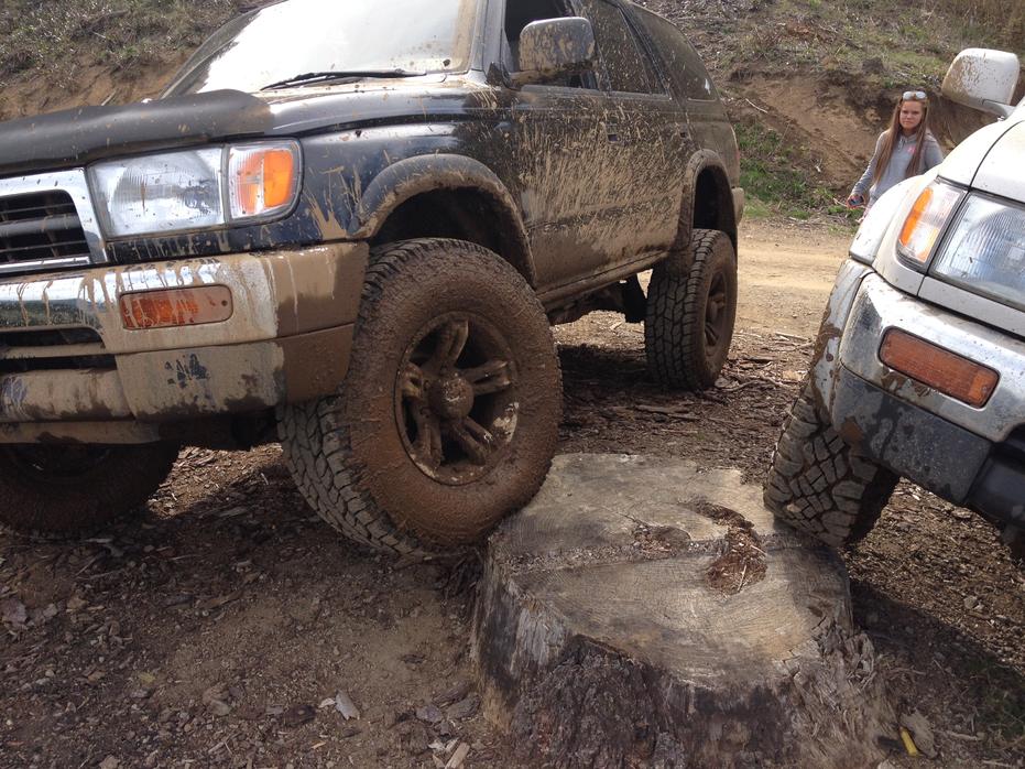

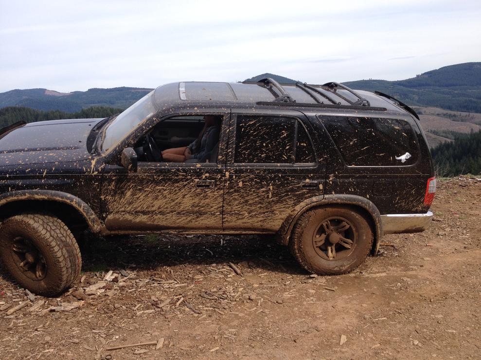

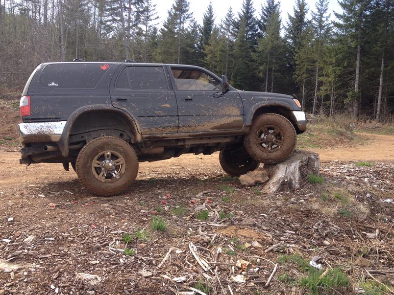

A link is always helpful but it's a suspension lift. Diff drops are controversial. I have a 3.5" lift front and 4" lift rear with no diff drop. Never broke a CV or even a boot and I've done some decent offroading. Obviously not hard enough right? Haha. I hear bad things about rough Country, like being cheap and not worth it. I've personally never used them so I can't say good or bad things about them.
