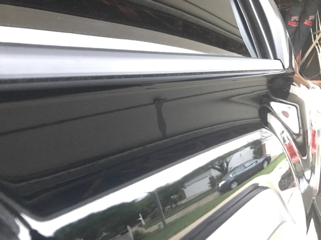

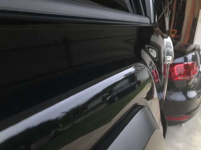

So I have had my 4runner for a few months and I noticed some very rough paint on the rear hatch around the area where the plastic 4runner fascia sits, it's a good size area on nearly the entire rear hatch but mainly the area that spans about 8" from the bottom of the rear window all the way across. I originally thought I must have driven through some tar and it was just dirty but now after a few washes this is clearly an issue with the paint or clear coat and it's not sanded smooth...its almost sand like. Is this normal on this area? To give you an idea, running a microfiber cloth over the paint it grabs like crazy and pulls off bits of the cloth.
Should I try to fix this myself or do you think a dealer would take care of this? It's obviously a defect but I'm not sure they would touch it. Any ideas?

maybe it is rail dust, I hadn't heard of this before but searched on it and seems to be similar to what is going on...I'll try to get some pics later - truck is black so it's not noticeable but you can definitely feel it

I bought the truck with 2mi on the odometer. First noticed this the day I brought it home from the dealer when I was installing my blackouts. I know the rear hatch collects a lot of shit but the little dots were there from day one.
No railyards nearby.
I always hand wash and dry about once a week (its black and the only way to keep it clean).
Check the bolts that connect the hatch to the rear of the truck. If those are gnarled it's possible it was damaged in transport and they took it off to repaint it. Also rub your finger nail on that upper lip where it meets the roof and see if it is rough. This is another sign it may have been repainted and the "roughness" you're feeling may be "trash" (dust particles) in the paint from the respray.
