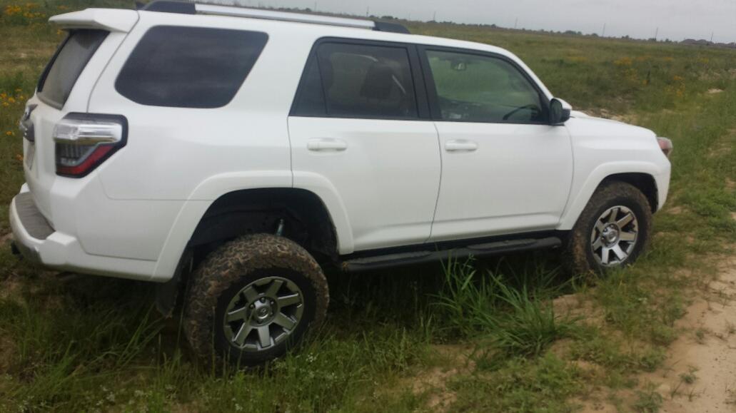

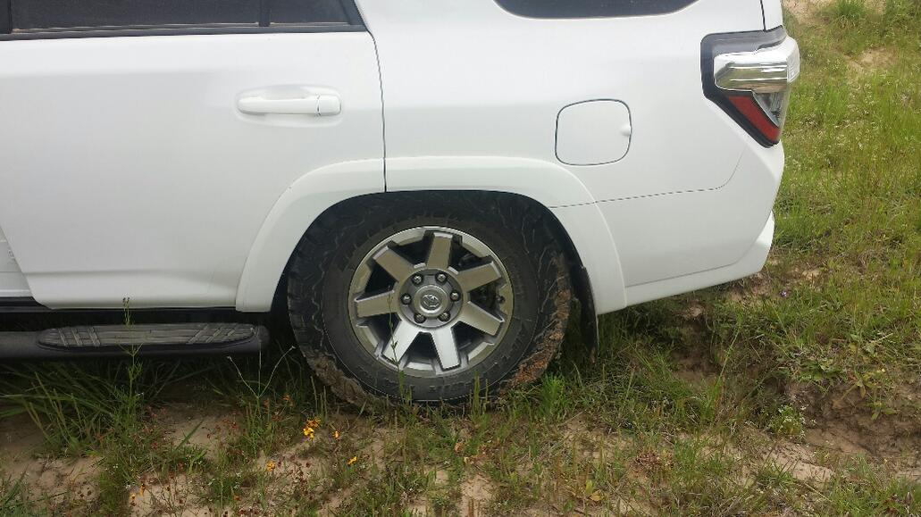

Not sure why you'd rub with 275's, especially after a lift. I'd probably remove the wheel spacers before cutting anything. Here's mine with a very mild lift & the same tires as you. No problems at all.
Because no two trucks are exactly the same. What rubs on one, will not rub on another.... with the exact same lift & tires.
275s should easily clear with no lift.
The issue was your alignment and maybe a tiny bit of trimming required. The wheel spacers however can cause all types of additional rubbing with the scrub radius change.
I went the 275's after reading through this http://www.toyota-4runner.org/5th-g...r-5th-gen-tire-fitment-guide.html#post1550444 and it was all green for the 275. But when I encountered rubbing with no lifts I went with the cheapest solution for a lift thinking it would eliminate the rubbing, but threw in the spacers without much research and my guess is that the spacers is what is causing the rubbing. will try removing them first. Thanks
