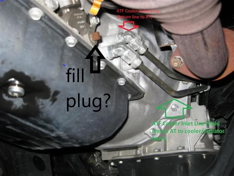

My 2005 has the same symptoms as described in this thread. I'm going to do a drain/fill and add a tube of shudder fix.
It seems pretty straight forward. My only question is that the pictures of the trans pan in this thread show a fill bolt with a hex head. It seems my fill is like the one in my attachment. I was able to get a 22mm med well socket on it and turn it quite easily so I'm confident it'll come right out.
Can someone please confirm this is indeed the fill bolt/port for my SR5 V6?
thanks
That is not the fill plug, the fill plug is about half way up from the pan and the top of the transmisson body.
You can see it in this PDF document about halfway down the page, it shows the fill plug is on a 4WD/750F and the 2WD/750E, both are on the tail section.
https://shop.ukrtrans.biz/wp-content/uploads/catalogs/A750E.pdf
