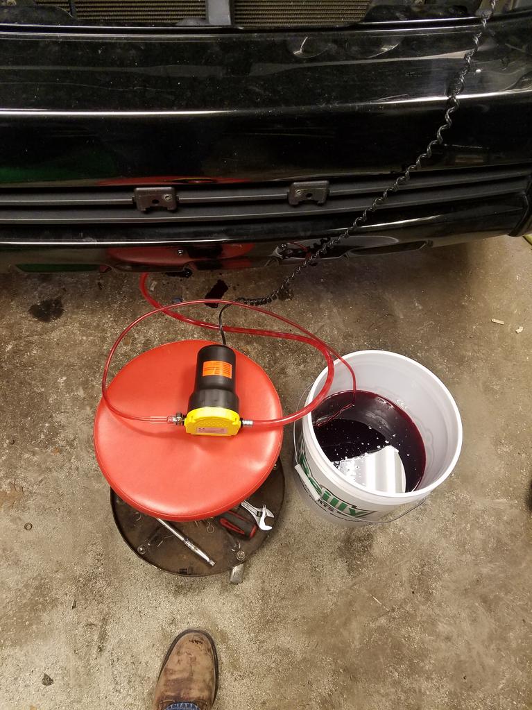

Get a $20 pump, 2 buckets and necessary hoses, and 3-4 gallons of fluid and do the fluid exchange yourself. It takes all of 2-3 mins once youre set up (which takes ~5-10mins) and will save you money.

Adding My 2 Cents
Hi Guys,
I'm pretty new to this forum but not so new in the mechanic field, I've been around cars since I was born so almost 30 years now, and I'm an aircraft mechanic(much different, they like fly and stuff). I recently purchased a 2009 Limited V6 4WD 4Runner with 147,000 miles on it. It had the shudder right off the bat. I have been doing the 4th gear work around up to 150,000 miles. Luckily I found this forum right away, and I plan to do my transmission fluid full exchange soon using two methods. I will first add some transmission flush cleaner, run it as per the instructions, drop the pan, change the filter, and then for the second method go through the cooler lines. Although, I would like to add that I will be doing same entire process again after 3 weeks of driving, and I will explain why. I myself am an amsoil dealer and they have a write up about transmission services. See below:

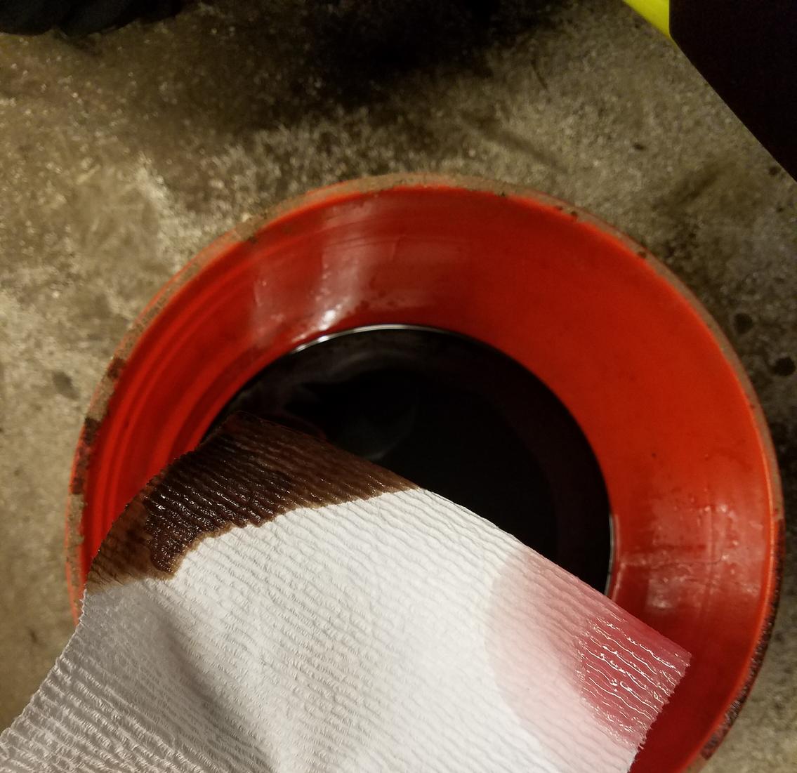

So I finally got around to changing my transmission fluid on 04/21/2018 with 150,000 miles on it. I only went through the cooler lines due to the transmission pan having a good amount of rust built up on it around half of the bolts. I didn't have a new pan at the time so I wasn't risking pulling it off and it not sealing later. Anyway, this fluid was very bad. When I pulled the line I second guessed myself if it was an engine oil cooler line. The way I did the job was I used an electrical oil excavating pump to push the fluid in the transmission. I would have the car in neutral and then start it, let it run till the steady stream of old fluid started sputtering, and then turn it off to let the electric pump catch up. I didn't check the level after doing everything because I compared the two buckets I used to do the job. I marked the new bucket at 12 quarts, and I stopped pumping fluid out of the car when the dirty bucket hit the 12 quarts mark. As far as the results go I have to start by saying my rumble strip issue was pretty bad, I had to have it in 4th gear all the time until I got up to 50mph. After doing the flush it was still shaking but its getting better as I put the miles on it. It just hit 50 miles since the change and it is way better. Once the new Valvoline Maxlife ATF has a chance to completely wash all of the parts I'm sure it will stop shaking altogether. Also this job doesn't clean out the cooler so some old fluid was still in there, and now the new fluid should help clean the cooler as well. After I know the shaking is gone, and I have put around 5,000 miles on the new fluid I will be switching over to AMSOIL. On the second flush I will replace the transmission pan, filter/screen mesh, and the cooler elbows going into the housing (rusty :-/ ).
