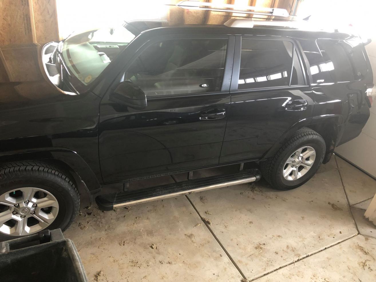

New member, read this post and it helped me figure out what I did wrong. We purchased a new 2018 4Runner and wanted to install some running boards. Well, I went out on Craigslist and found a pair for 80$, not bad I thought. Got home installed them right away but scratched my head thinking "Man, these really look funky, they seem to be really low to the ground or something." These must be for the earlier 5th gen LE's because the bracket seems kind of long. They just don't look right, lol.
Ugh, so now I'm stuck with these longer bracket running boards. Does anyone know the part number of the shorter brackets? Will they hook right up to my Yoda and current boards?

I did the same but the opposite! Want to trade brackets?
I can't even install mine due to this issue, PM Sent.
Tried sending a reply to your PM but I'm not sure if it went thru. PM me your email address and let's exchange photos. That way we can both be sure it's the parts we're looking for. Bolt holes and a tape measure next to the brackets should work good.
