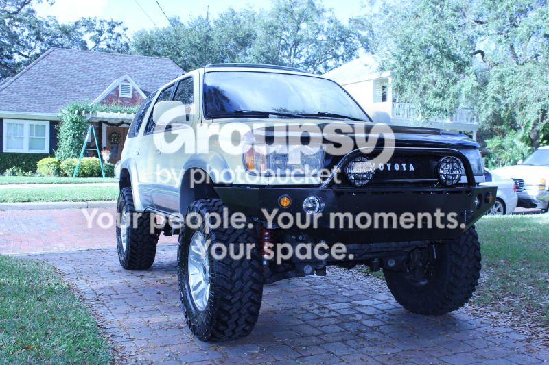

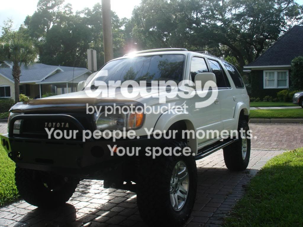

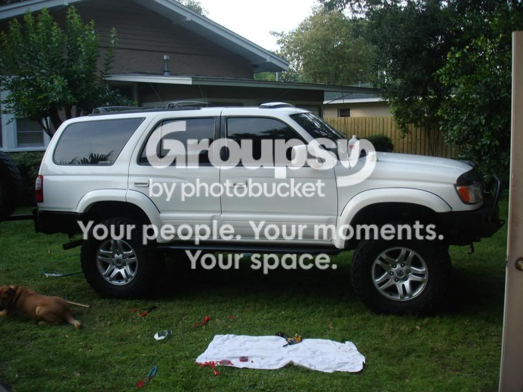

ODL bumper made it in. I haven't had the hoop mounted as I'm still trying to get it perfectly level on the frame. Rattle can black to stop the rust. Migh try and get it silver, but I think im set on the stormtrooper look. Poser shots can come after its cleaned up. I battled with the fogs for a while, destroyed a few things, and figured out. You can search for the thread but Im not providing it as it was painfully obvious what was wrong.

Added Hoop: She now has piaa 510 smr ins the bumper and Piaa 520 SMRs under the hoop.
I love this thing!

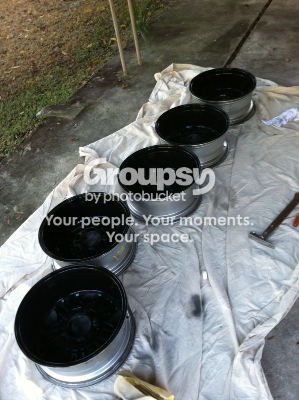

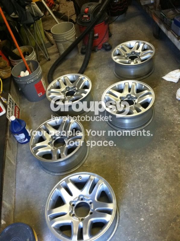

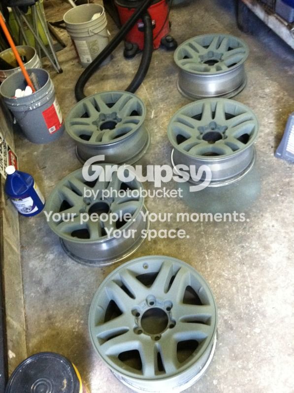

Broke down and finished the rims. Wound up using an 80 grit disk, more stripper, wire brush, chemical stripper, anger, final hand sanding. Here they are all primed up with self etching primer. I went with rustoleum, I didn’t get the warm and fuzzy from duplicolors website.
IMG_1028.jpg~original
Then painted the backs with high heat gloss black.
IMG_1027.jpg~original
Then hit the fronts again with 3 coats of rustoleum steel wheel paint.
IMG_1030.jpg~original

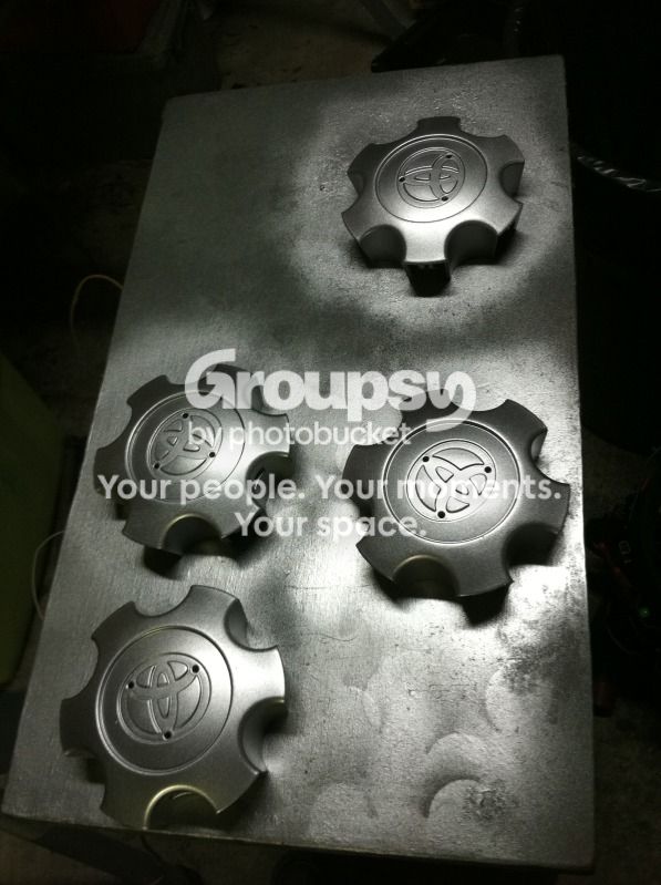

Then sanded the center caps and clipped out the emblems.
Primed and coated

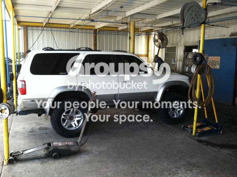

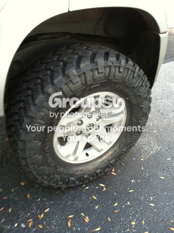

I was looking around forever for the right tire and settled on the nitto terra grappler. They are the most like the BFG KM pre KM2 style. I loved that tire and many times considered buying smaller tires off the rubicon guys trading them out in our area. The 295/70r17 Nittos are just the right size. Bigger than 33, smaller than 35. Just right. I absolutely could not be more excited about these tires.

On the rim
IMG_1039.jpg~original
Its important to note the following: Nitto gives you two options for letters. The one showing is the normal style, the style I turned inward looks like it belongs on a studded Afflicted fight shirt. Not my style.

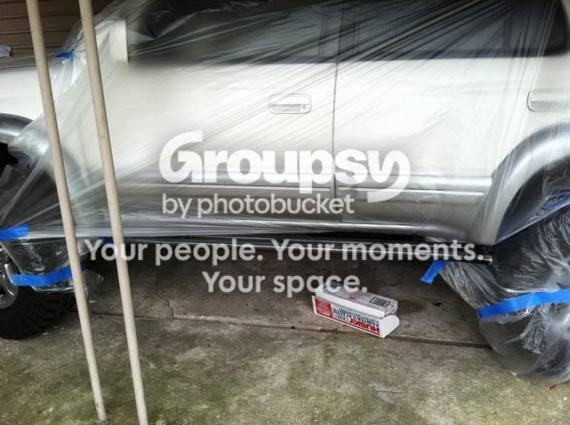

Got some addicted off road sliders for Christmas. They are the only Sliders with rock bump outs that, in my opinion, do not look like an afterthought. Here they are welded up, I don't dare do real welding yet, so i left this to the pros. Hint: don't not paint these things when you can put them up on a sawhorse. You heard it here first.

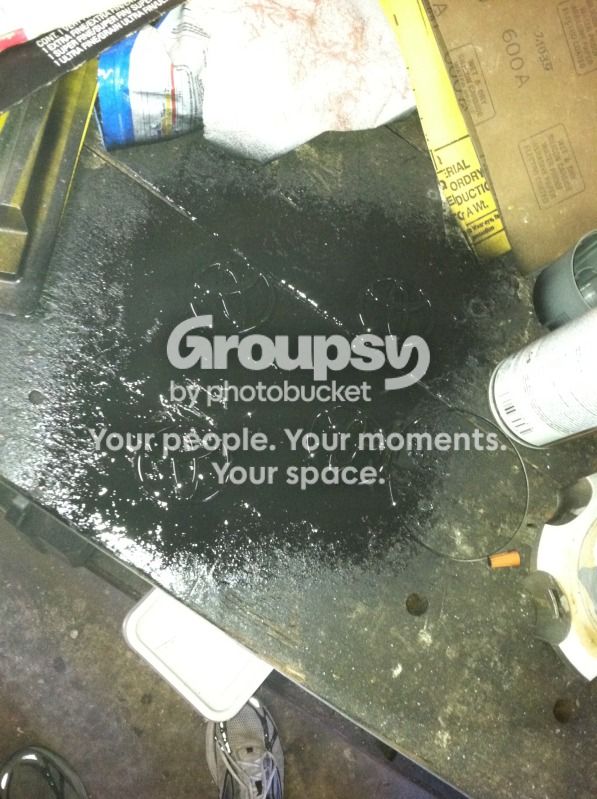

Painting: Note to future rock slider owners. Acetone wipe down is a must, Self etching Primer is a must, allowing the top coat to cure is a must. Painting these on the truck was a giant gaping hole in my plan!
Notice how the plastic doesn't try to lay on the wet paint of the left side of the picture. The truck pretty much just protects itself from over spray at this stage. A quick 30 minute project turned into a study in sandpaper and curing time relative to humidity.

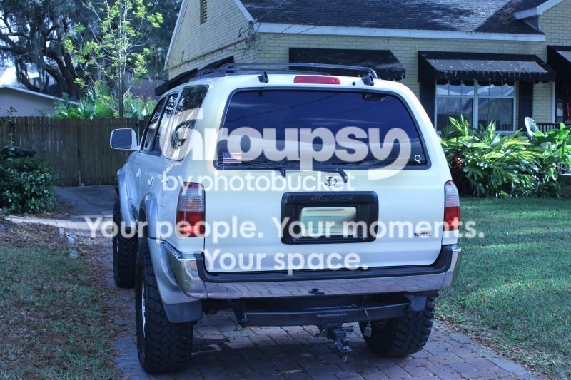

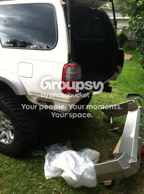

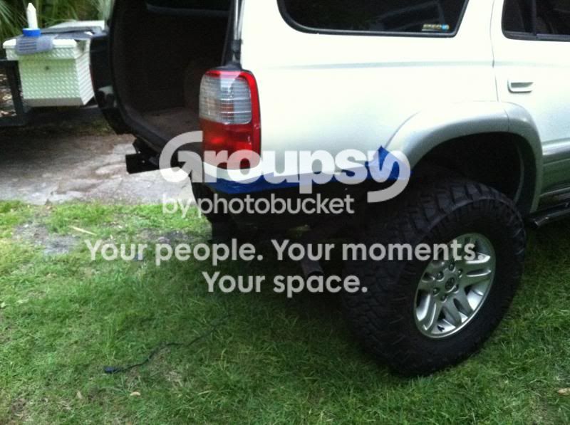

Got new Bumper in the mail. A gift to me for selling my Rhino.
Goodbye Fluffy, you will be missed.
On to the good stuff.
Here is a picture of the bumper installed on another t4r guys rig.
Was it Black? No. Should it be? Yes. Did i find the coolest bumper in history? I believe so. IT WAS HEAVY!
Beat up chromy removed. Its for sale if you need a dented rear bumper :)

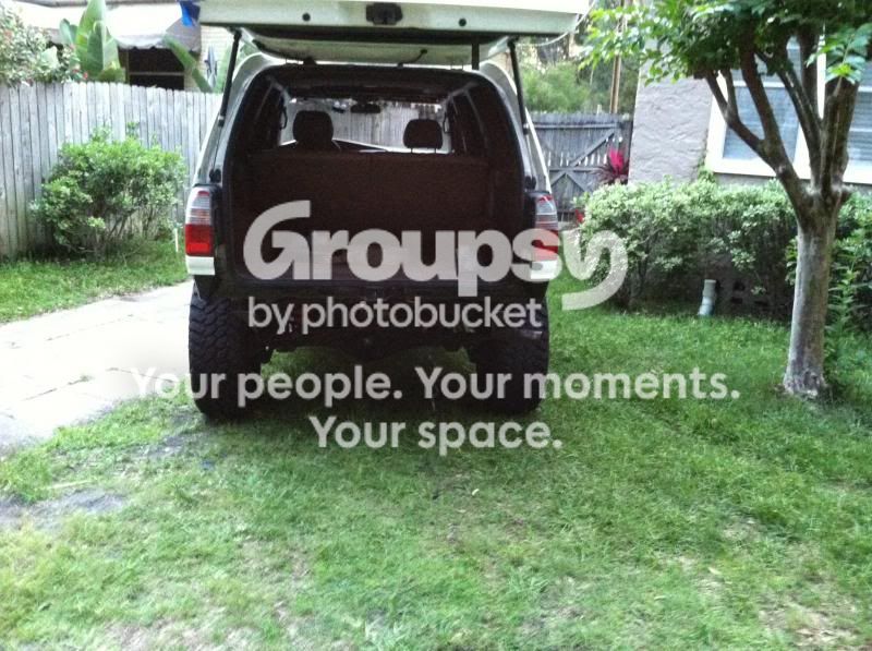

Whatever that plastic thing is on the bottom of the driver rear panel under the old bumper was shot. I have seen that thing on every build on here, still dont know what it does. Its is called a Pressure Vent. It can be found here. http://tps.toyotaofdallas.com/parts/1997/TOYOTA/4RUNNER/LIMITED/?siteid=214074&vehicleid=1272596&diagram=8414485 My great engineering mind figures that it vents pressure of some sort.
I sanded and painted the underside of bumper area. I am a big Rustoleum fan, and I read that POR does not last in UV light exposure. Also found some pretty shoddy patch work under here, so much for the never been in an accident story from the hippy i bought it from. I guess doing the right thing and telling the truth dont go hand in hand with peace and love. Forward!
Hot dam these things look sick with no bumper. Can you see my air leveling bags?!?!? Not hooked up as I chopped the bump stops off way too low. Going to let the springs settle before I attempt to size the pucks in the kit to make up for my "aww $h!) you gotta be flipping kidding me!"
FINALLY installed. The love tap on the left rear of the truck must have shifted the body. I spent about an hour before mounting it up with a tape measure and found the body was 1/4" offset to the left. I built a wooden jig to hold the bumper up, used winch straps to cinch it to the body and a steel rod, (you tie down cargo on a semi flat bed with) to jimmy the bolt holes together. I BARELY got the threads on the bolts biting. I was angry but it was not directed at my 4runner, it was directed at the a fore mentioned Hippy.

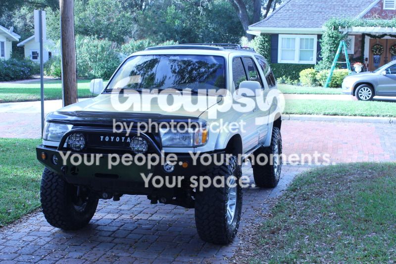

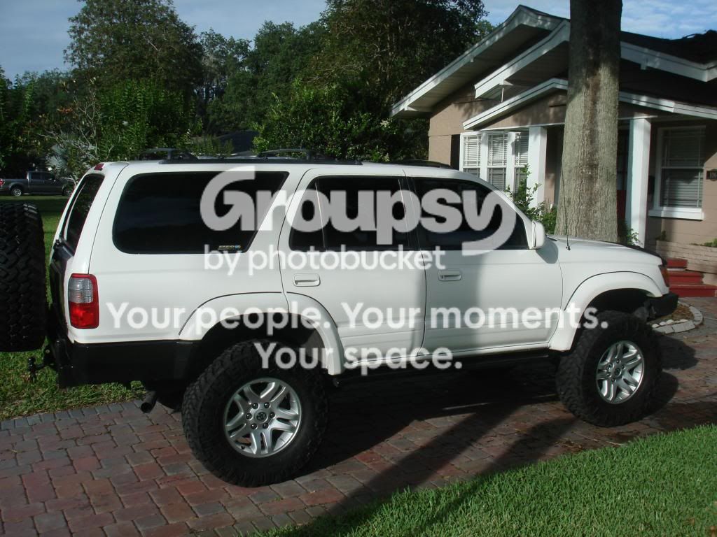

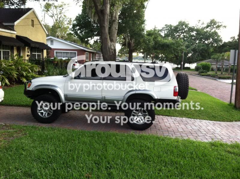

Note the 891's hold up well. Sag is long gone. Silver flares making me recoil in disgust but i still dont know if white is the solution. Too much going on externally.
Better here below but I wish I had a Hilux Surf rear door with the side license plate light and holder. Cant wait to get my first ticket from big brother.
Stripped and painted the rear arm. It should be noted that the guy who had this before me, had a RIDICULOUSLY good paint man work on it. I have never before seen such a nice paint job save motorcylcle tanks and fenders, super thin filler with at least 2 or three coats of sand-able primer, then a few coats of color and flake; and to top it off about 3 coats of clear. I could literally hit the clear with a 4" metal brush running full out with my grinder and couldn't make a dent in the color for a full second. My wife says I spent 2 days stripping the thing, so divide that by exaggeration and carry the "your always late to dinner" and i think i have about 6 solid hours in stripping this thing.

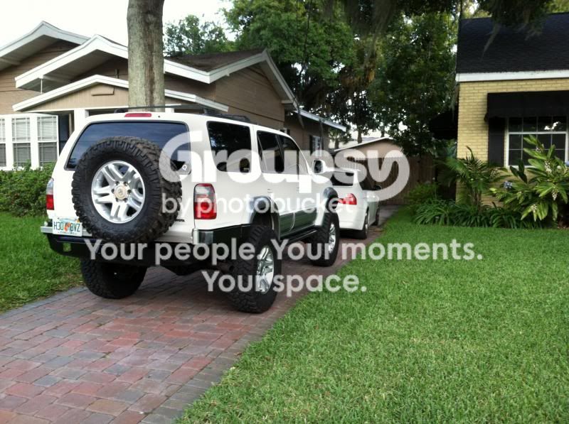

Finally got some pictures i took with my potato phone of the new swing away tire carrier. I want to move the 4runner emblem to the 99-02 side (left side) of the lift gate. But I am pleased with the carrier overall. No noise, decent fit, Now just need to add the back up lights. I love this truck!
I Snagged the rim off a guy on here, sand blasted and painted it. The cap is from an old Toyota 3 spoke i had and repainted it to match. I went to Marshall's for hobby paint, yet retained my manhood.

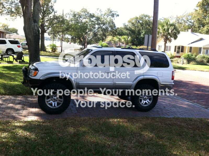

Yanked off the limited flares and repainted them this weekend. Really like how it turned out. I took a pile of pics and Ill post a write up if anyone is interested. Let me know.
yes please post as soon as you can. Looks really good. Ive been wanting to do this for a while now but thought it looked way too involved for me to do.
Your truck is badass man! The white flares are just what it needed too. I dont know how your license plate is on there but I got in trouble with mine for having no light on my swing out. Luckly mine came with one but its a pretty cheap and simple thing to rig up either way.
Ill be doing it tonight. Glad I wasn't the only one who wanted to do this. Though I think yours may be a bit different.
Your truck is badass man! The white flares are just what it needed too. I dont know how your license plate is on there but I got in trouble with mine for having no light on my swing out. Luckily mine came with one but its a pretty cheap and simple thing to rig up either way.
Thanks man, I had two buddies screaming at me to paint or rhino line them black, I haven't seen an all white job so I figured id step off the ledge. I have a few ideas I'm rattling around in my head for the light. It seems simple enough to figure out.

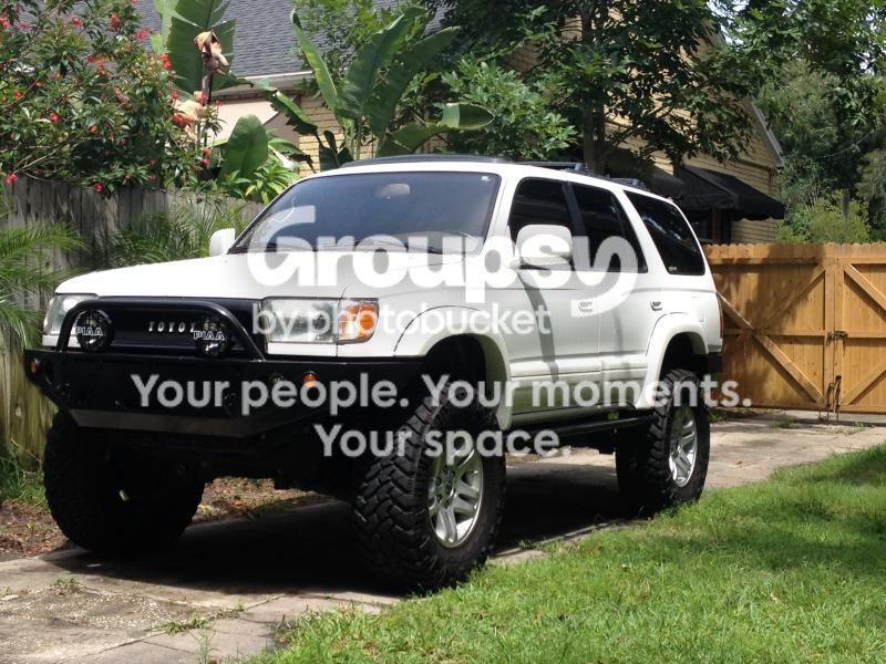

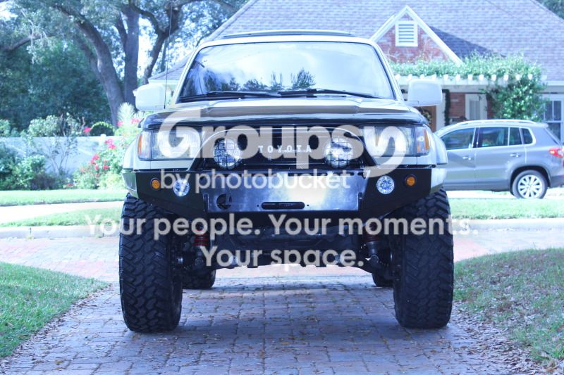

Clean and shiny. Reinstalled the fogs and back up lights Saturday. Waiting for the rain to stop and more poser pics with lighting on etc. but for now i have these...

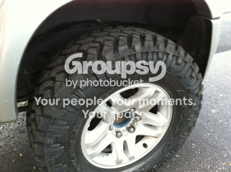

At the shop
IMG_1036.jpg~original
On the rim

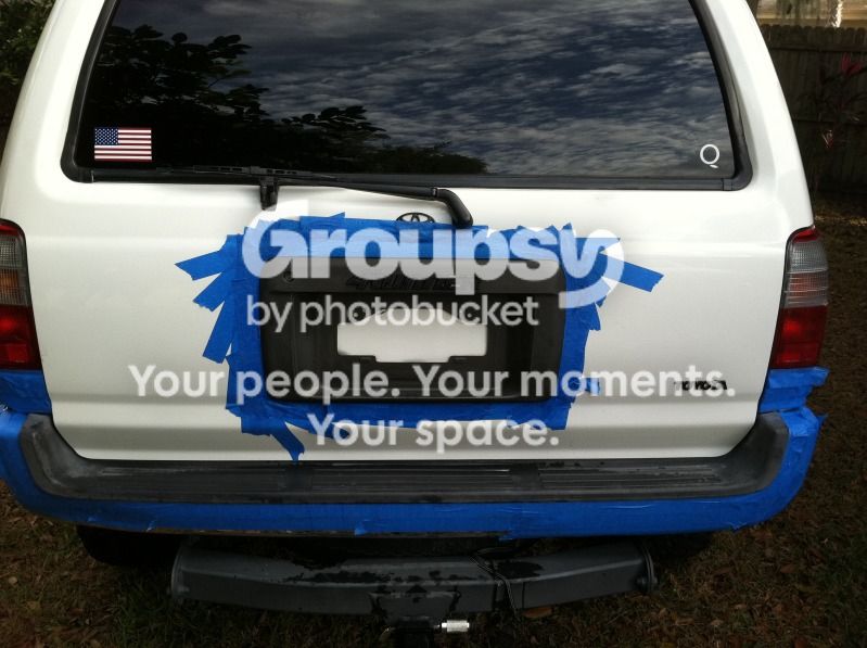

Taped off the rear license plate and plastic piece on the bumper.
IMG_1054.jpg~original
plate.jpg~original
Don’t like the plate holder all black, it’s going body color when I get another shot at it.
