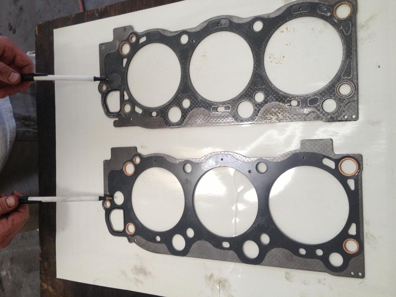

Jake - I discovered that my problem was that I had switched the head gaskets when doing my HG job. That was my conclusion after eliminating most, if not all, of the probable causes.
Some explanation.. The two head gaskets are nearly identical with the exception of one hole the size of a nickel. This hole is where coolant passes through and if the gaskets are swapped, that coolant hose is blocked. Hence, coolant does not flow through the system. This explained why the lower hose remained cold (with thermostat in).
It may be hard to believe since the only solution to confirm this would be to tear it down again to check whether or not this be the case. I'd say if all else fails and you've eliminated all possible causes, do what you need to do.

Well. I have got to tell you, you were right. I offered to help do the work on my truck at the mechanic's shop. He was delighted that I came. He and his employee had business to tend to Friday as I worked on dismantling my engine. As I reached points unknown, I asked for help and continued tearing down. I reached the cam shafts, removed them, and then finally the head ad the gasket. Luckily I had a gasket from the package still and kept referencing your picture and dreading the sight of the gasket. Sure enough I pulled the head and lo and behold the gasket was plugged!! I grabbed the new one which matched correctly. The employee was shocked it was like that (and didn't admit fault) he said, "Oh look it goes right down to the thermostat!" Well duh! That's what was plugged! I was glad to discover what you said was correct! It was plugged! So today his employee set the gasket, head, cam shafts, and the rest of assembling was left up to me. Monday morning I'm going to finish with the belts, fan clutch, and radiator. Thank you!!
You can see in the pic, the gasket they installed which plugged the nickel sized hole and the correct gasket WITH the correct hole. They both exclaimed, "The didn't label the gaskets L or R! Well, it's not rocket science to line up holes."
I'm just glad it's done. Again, thank you! Here's to a cool running engine!!
