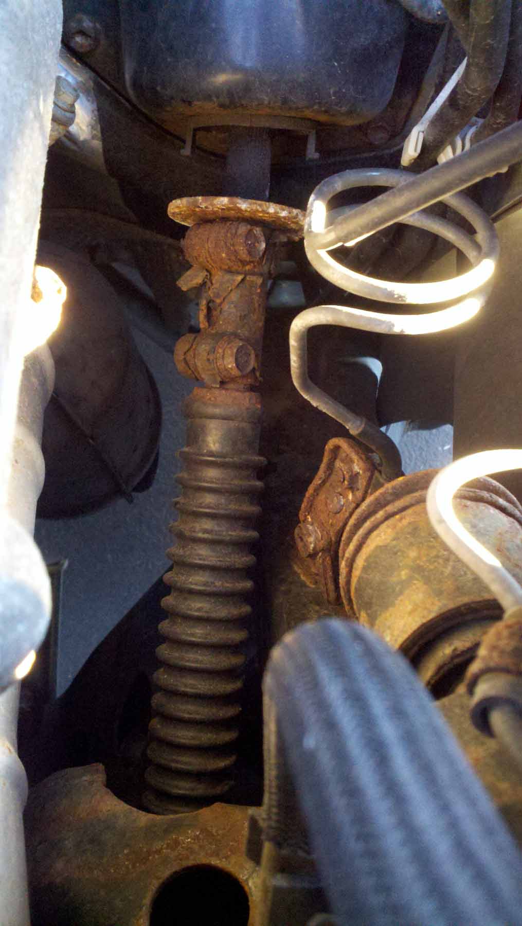

WOW, the photos you posted of your 4Runner Rust look EXACTLY the way my '04 4Runner looked after the SAME 3-4 years on the road. I live in Eastern Pennsylvania, BTW.
Check out this thread from a few years ago to see photos of my 4Runner and information about POR15.
http://www.toyota-4runner.org/4th-gen-t4rs/28922-under-body-touch-up-rust.html
FYI, I was at my Toyota Dealer tonight looking at Tundra pickups.
Just for grins I looked under some 2007 & 2008 Tundras on the used car lot.
Other people on the lot must have thought I was nuts when they heard me laughing my butt off. Seems that the used Tundras of that vintage have the same rust in the same places as my 4Runner at that same age.
BTW, some here with older 4Runners in Rust Belt States might want to check out their steering column linkage. The "surface rust" on mine suggests to me that this might be one of Toyota's future safety recalls.

hey charlieR180 so you used POR15 only on rear end so how does your 4runner looks now at those parts has the rust come back? peobably you used it 3 to 4 years ago...and yes the sliding yoke on steering shaft looks almost same at my 4runner but not as bad as shown in your pic...
