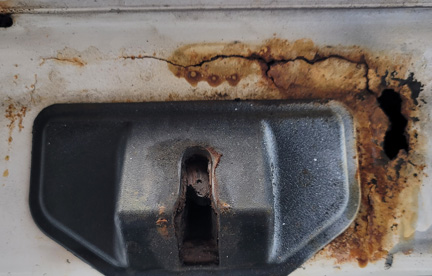

Tailgate latch area has major rust happening and didn’t get this bad till this fall. I had an issue with the glass falling down due to rust on the hangar and motor dropping it this summer. Now I found this after removing the trim piece that covers up the latch assembly. Really bummed it got this far.
This area inside the tailgate is just prone to excess moisture in my 4Runner. Clogged weep holes along the bottom doesn’t help either. I’m worried it is too late but wanted to get your thoughts. Hoping it might be salvageable.
My initial thought is using a rust converter and sanding to try to save it. Inside and out of the tailgate assembly. Worse case I’ll run until it breaks off and buy just the tailgate body part. Paint and re-assemble it myself.

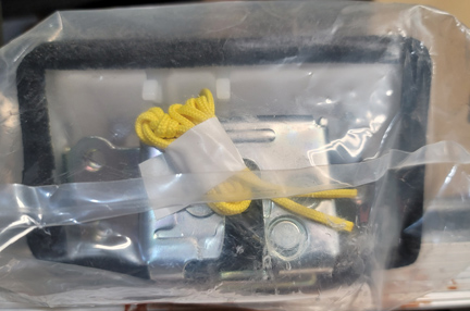

I read somewhere that only two manufacturers make the assemblies, despite branding and price differences. So I went with the cheapest imported eBay latch assembly about six months ago and it’s been fine.

I JB welded the tailgate and lubed up the latch with PB Blaster. I'm not about to replace an entire tailgate just based on this.
However-- I will say that if it was to eat things out enough the latch would have nowhere to bolt to, then that's an issue.

I have the same issue. The rust came from the inside out, so when I saw it, it was already too late. The rust has rapidly progressed to the point that I had to buy a new hatch and lock.
Looking at the plastic water shield on the lock, is it not plausible that the open cell foam around the base of the lock at the door is holding water/sale and causing the corrosion? The rust pattern matches the shape of the foam covered shield. I am debating on removing the foam, since it seems to be causing more problems than it stops. I am going to Fluid Film the daylights out of the inside of the door as well.
