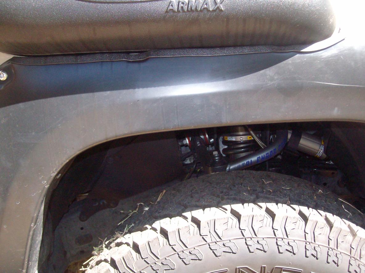

[MENTION=154717]T4RWARRIOR[/MENTION] asked for a closer look of the cutting required if one is running BW flares. This is the best I have right now but if anyone needs more, please let me know..
Perfect thank you. That's all I needed to see. Can't wait to add my snorkel once I get it. Appreciate the photos
Sent from my iPhone using Tapatalk Pro

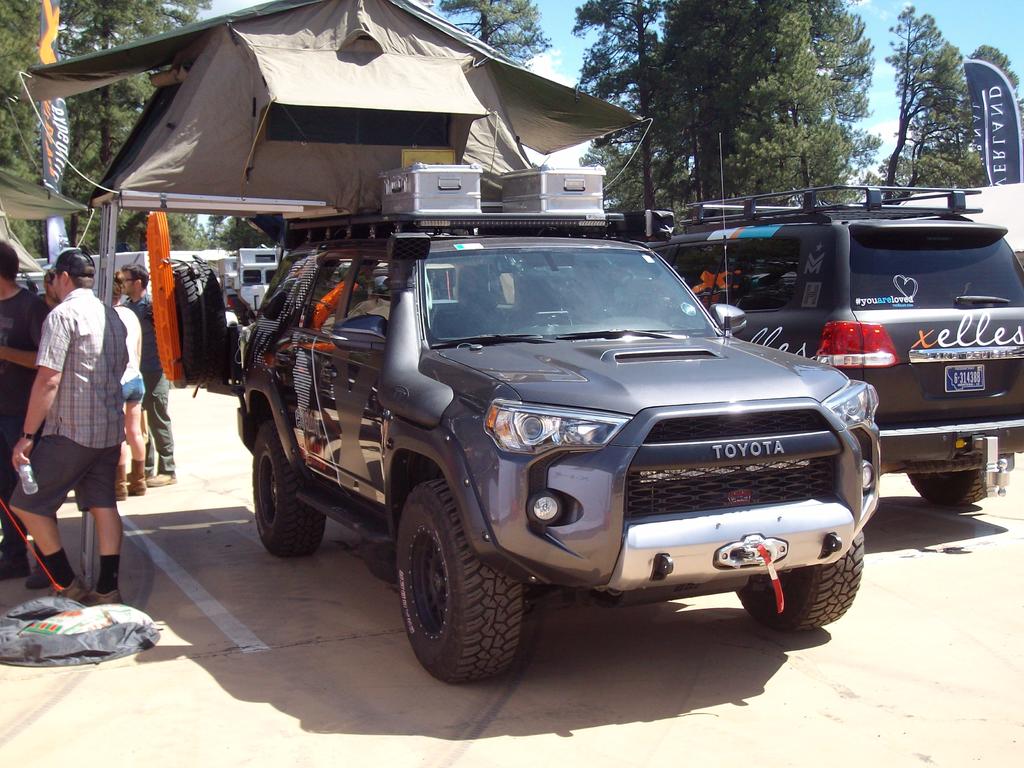

To me it looked like the BW flare was trimmed too much on the Expedition Overland 4runner. There was a huge gap between the flare and the snorkel. Yours looks better as there's not much of a gap there. I guess the lesson here is trim a little bit, test the fit, repeat.
Thanks and agree, In the pic it looks like they have a huge gap but the edge trim around the flare is darker so it appears huge. However, In person looking at their rig, they did cut a little bit deeper but it's hardly noticeable blended with the paint/wrap.
Yeah when I saw the expedition 4runner it did have a big gap. Then why I saw great-ape his was nicely fitted with the snorkel. Looks way cleaner too. I like it
