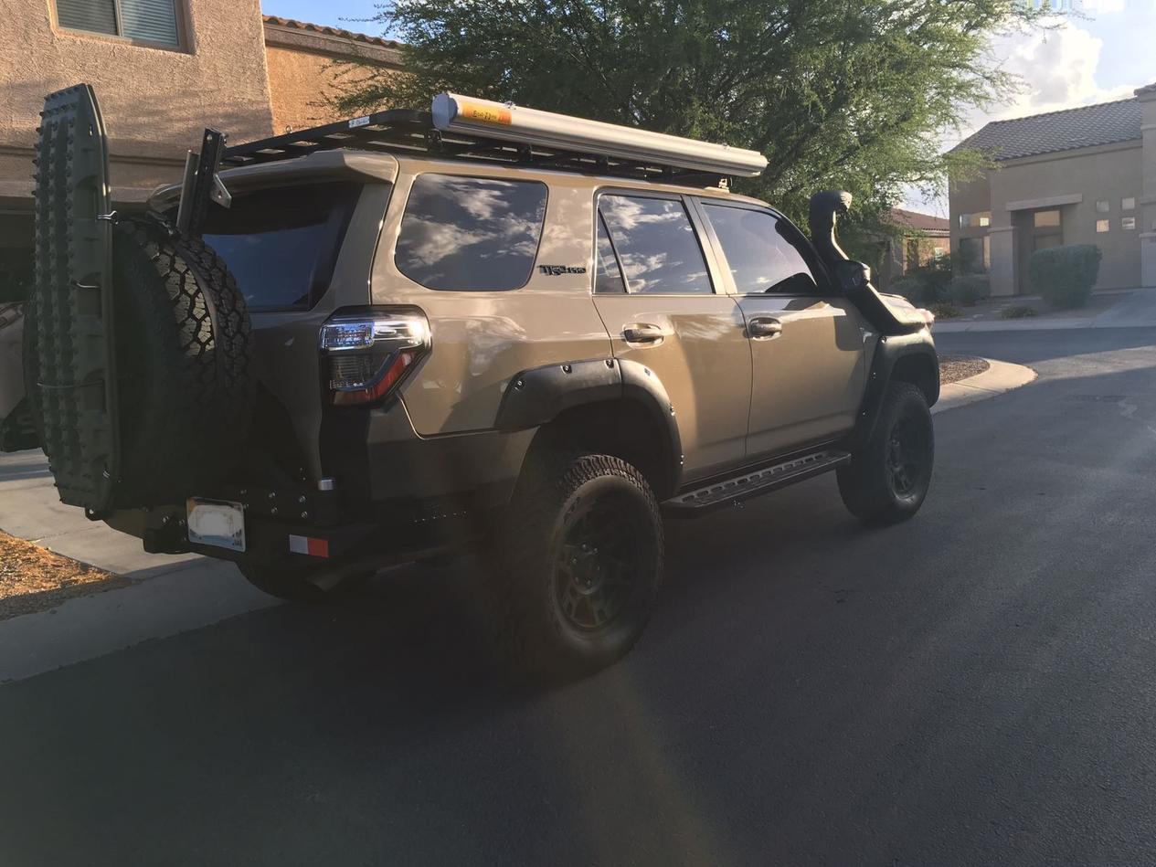

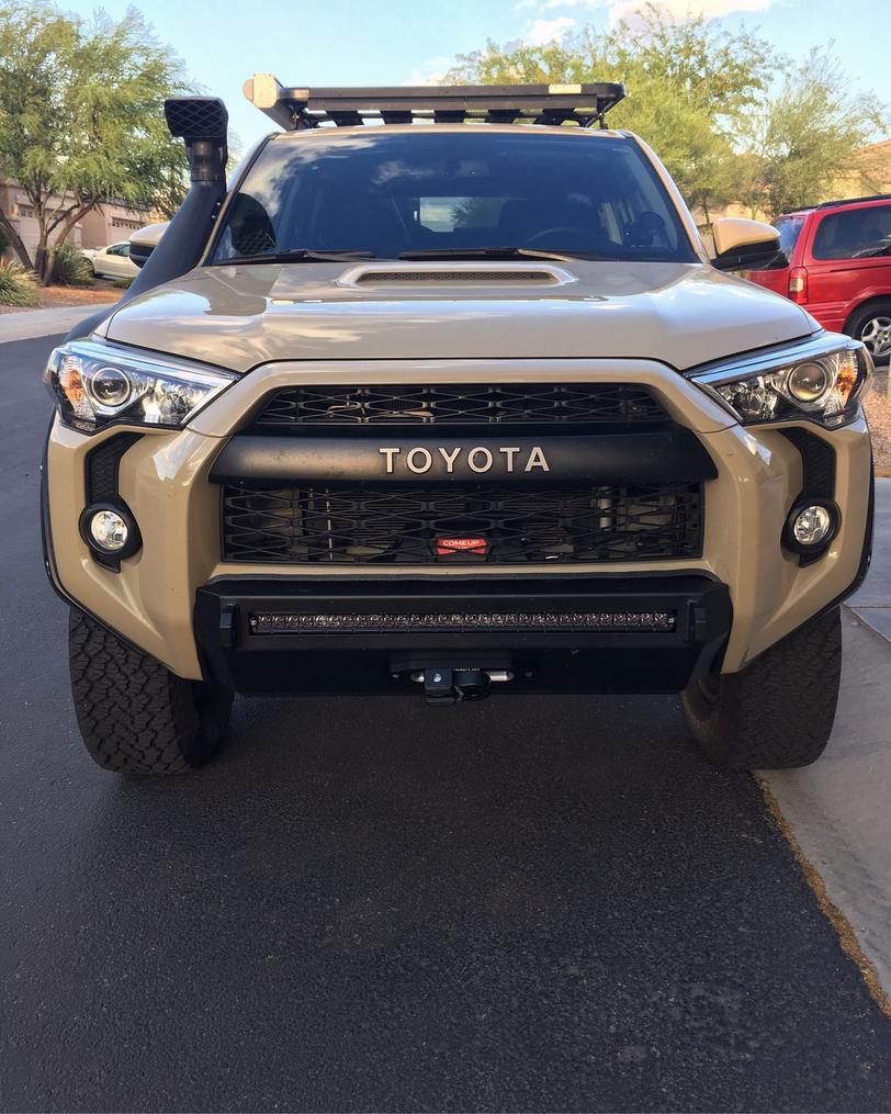

It's on ...ARB did a great job designing it. It's definitely a beast x2 and aesthetically, it will grow on me...all in all ..hell yeah
