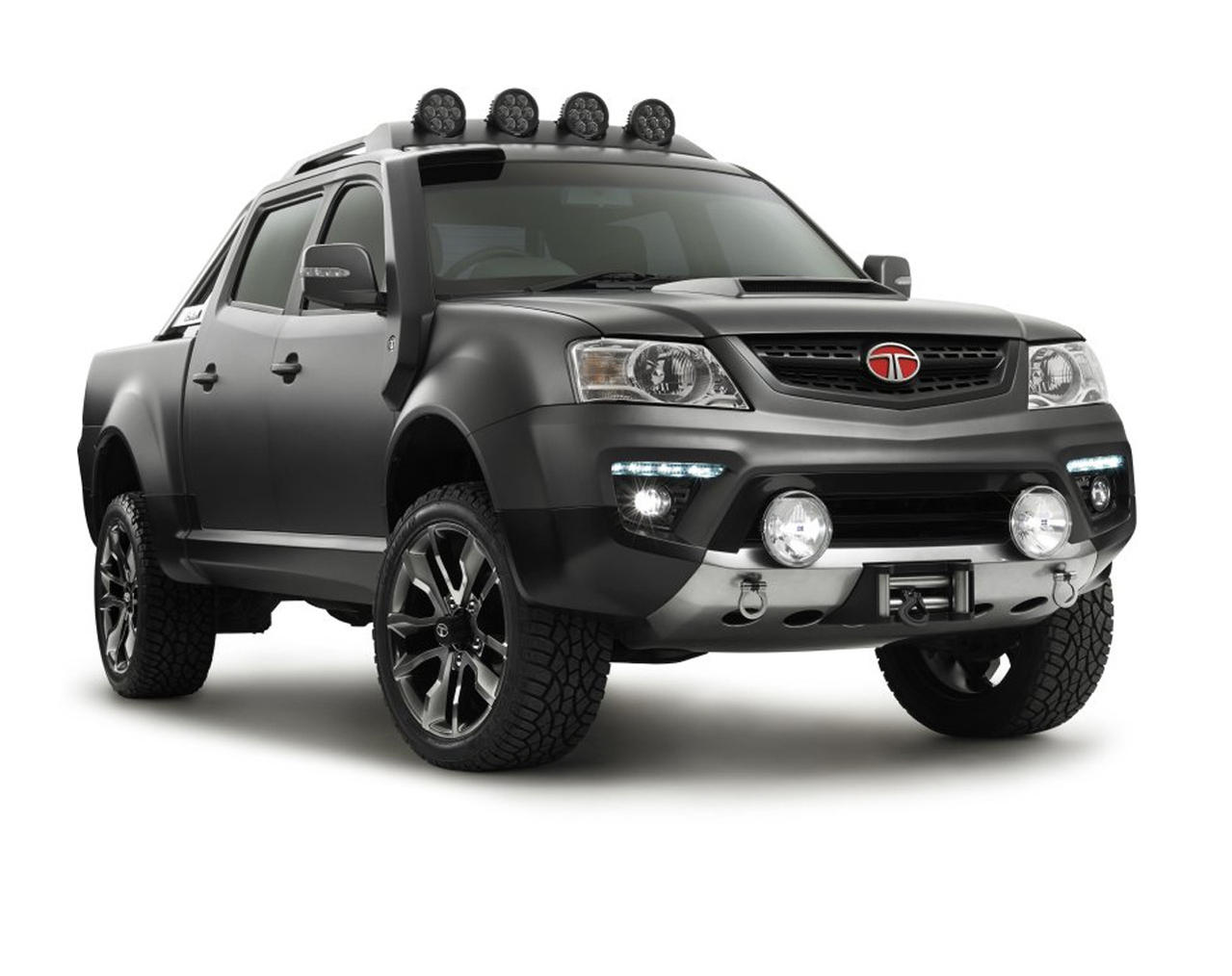

How about making a "slim" design complimenting the look of the 4Runner in 2015? I don't see Armor or Roof Rack manufacturers going all bulky and tank like, everything is tucked in/slim/lightweight and I believe that's what most of us are looking for. How about something like this that could be color matches to the vehicle?
Not a good design at all. Why? Because I had once instance that I literally dove into a stream deeper than I thought and a huge wave of water went over my hood, and continued flowing and up my windshield and hit the roof of my 4runner.
Looking at this snorkel since it mounted just at the windshield the wave of water would of got sucked into the inlet of the snorkel. Not good at all for a snorkel that should prevent this!

That snorkel is a common design of what they use in Dakar it probably breathes from the back side not the front but the shadow makes it look that way. It's designed for dusty environments not water if it does breath from the front I have to agree that is really a dumb design as it would suck in a lot of extra dirt as well.
