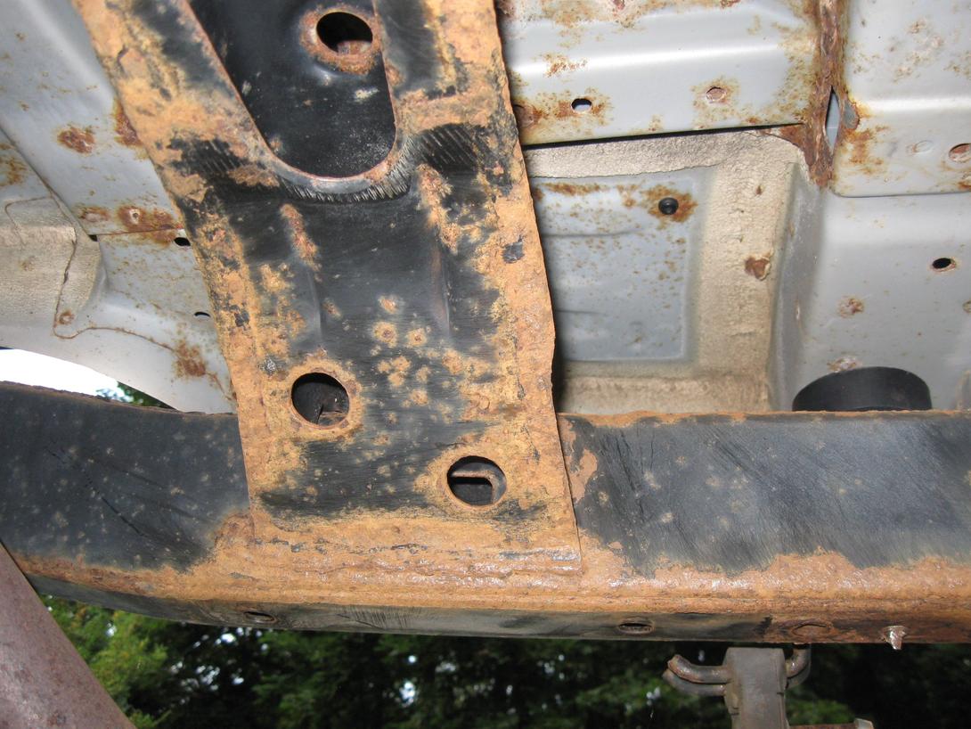

I am beginning to undertake the body-on rust scaling and preventative measures. I don't have a lift or access to one so that makes this challenging a bit.

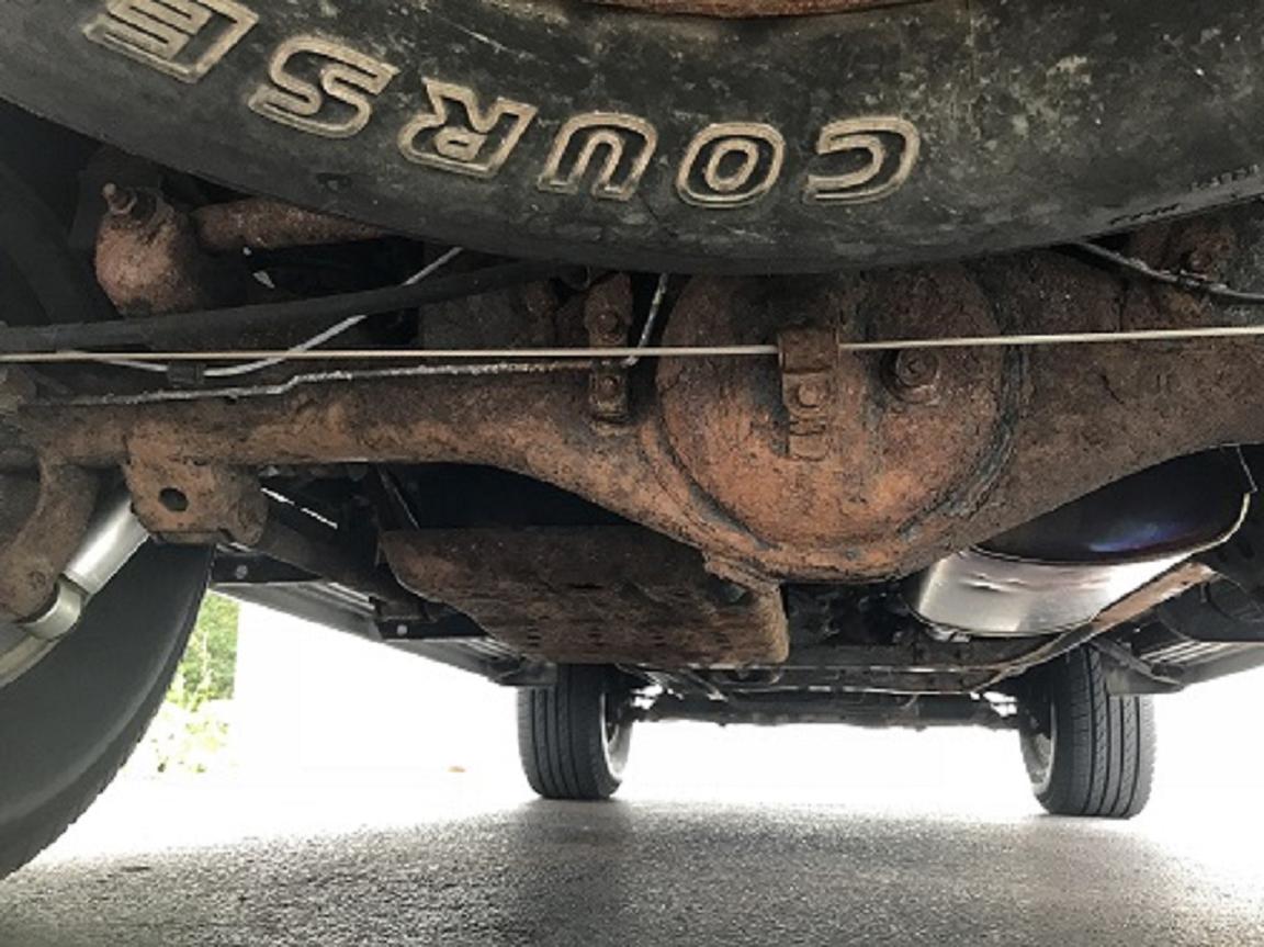

Q1 - Here is my rear diff - this is salvageable right? grind out/away the rust and coat with reformer and por15 best option?

You're going to want to be real careful grinding or descaling that dif. That is somewhat thin metal and you could very well put a hole in it then you'll have opened up a real can of worms. Hard to tell from the pic but if you could get a closer shot, I could tell how bad it is.
Also, if you haven' t already, try to really clean out the frame rails by flushing water in at several spots. Start at the back where it's wide open. If you have a pressure washer that might move things a little more. Two things you want to accomplish here is to get out all the "stuff" that would clog the frame hole drains (really needs a drain in front of the rear lower control mounts) and to see what kind of rust you can flush out (the bigger the rust chunks the greater the problem (and panic) JK about the panic but the rust problem is no joke on these trucks and looking at that one picture of yours, you've got some work to do.

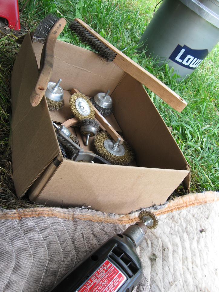

Second no screwdriver! Buy an assorted kit of wire wheels that attach to a drill, plus different length & width wire brushes. It really helps to have a 1" body lift to get to the top of the frame.

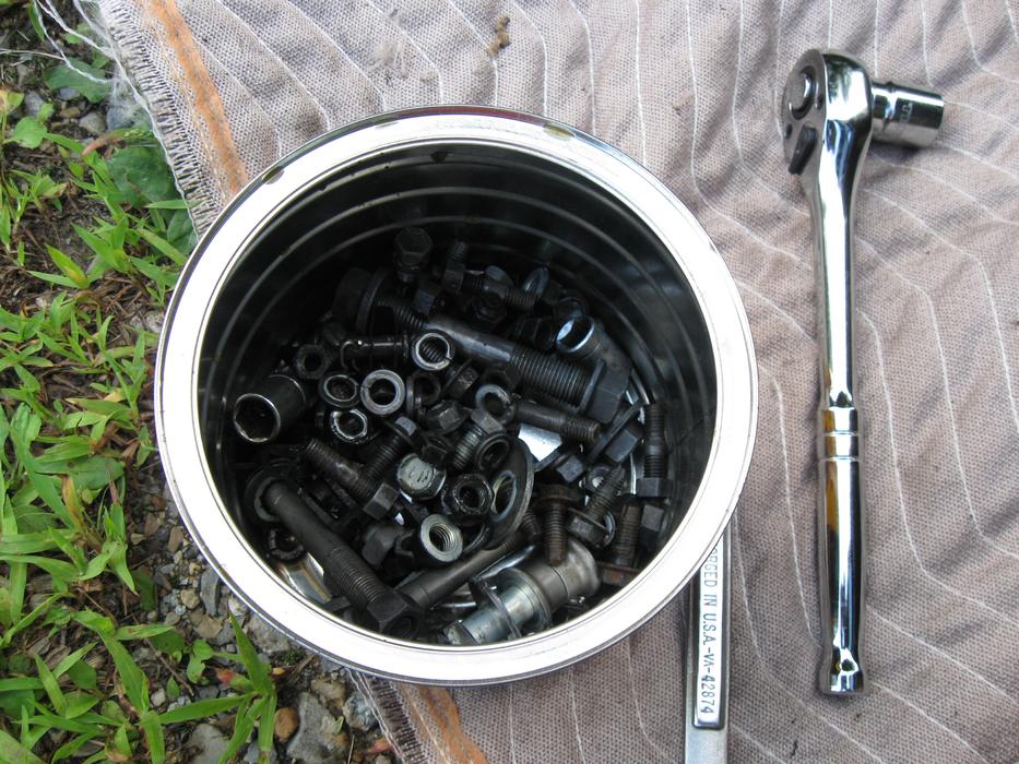

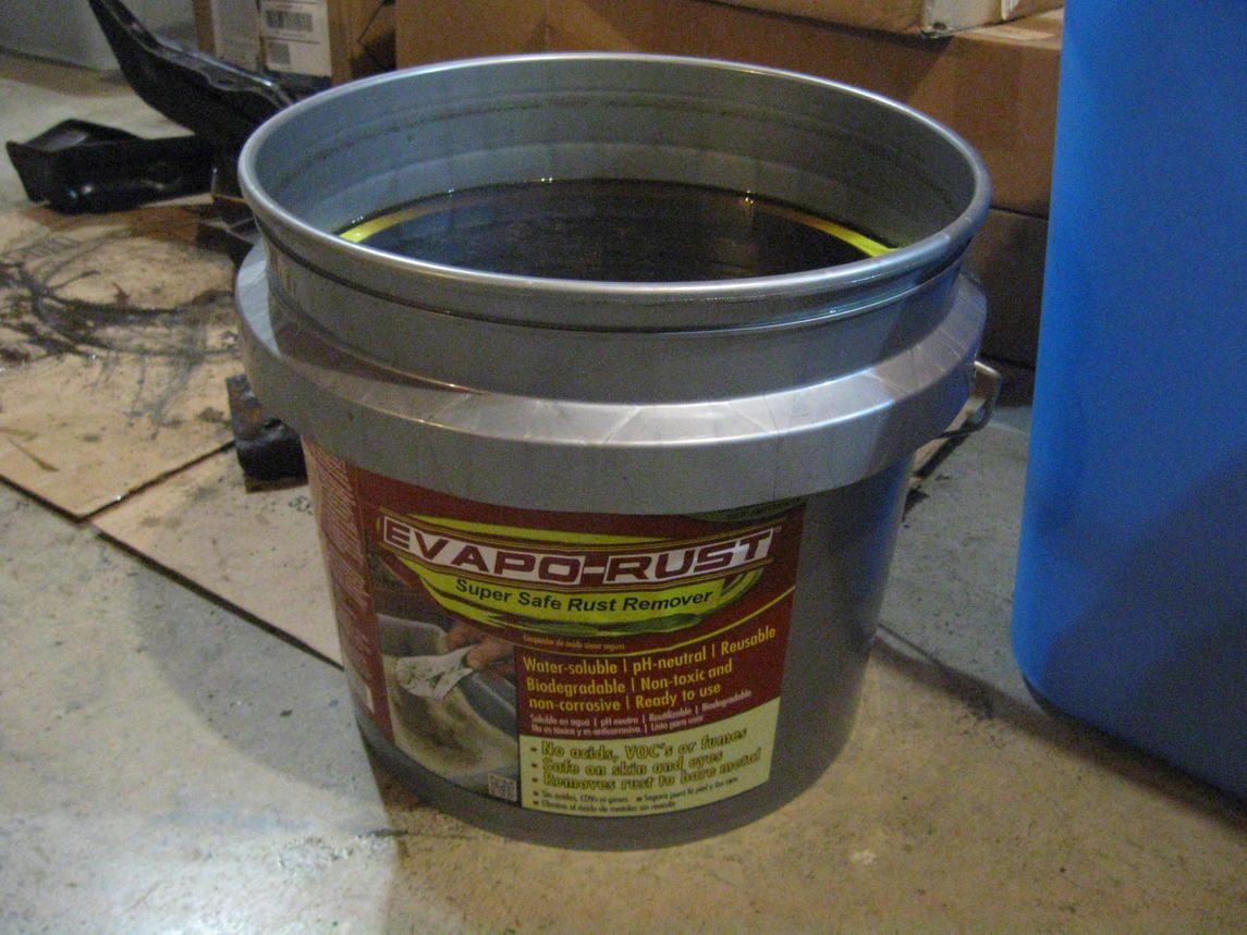

Soak all reusable nuts, bolts & washers in Evaporust & use anti-seize when you replace everything.

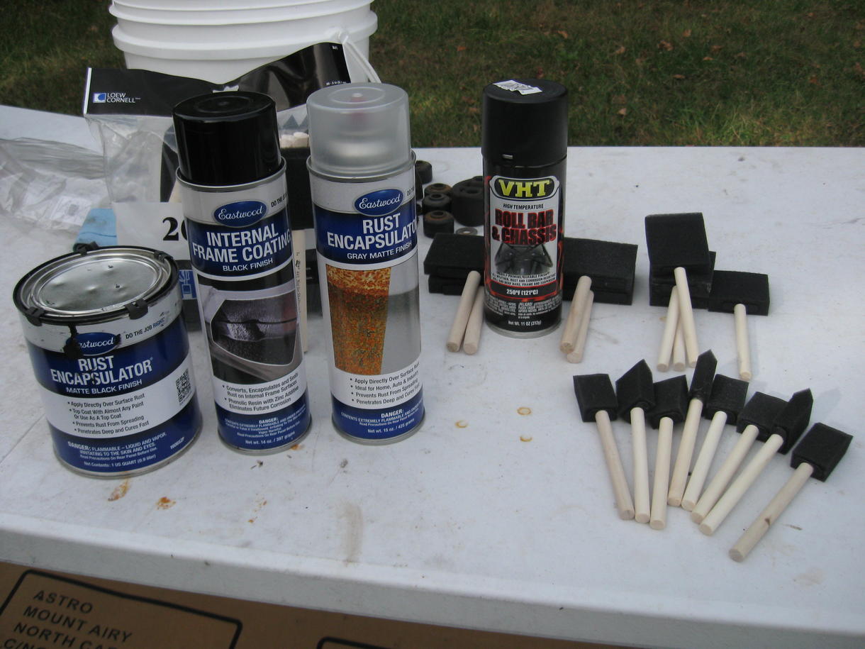

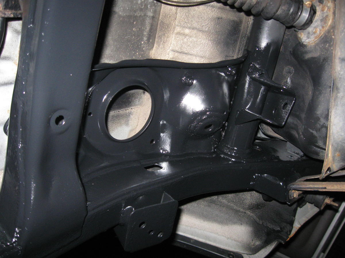

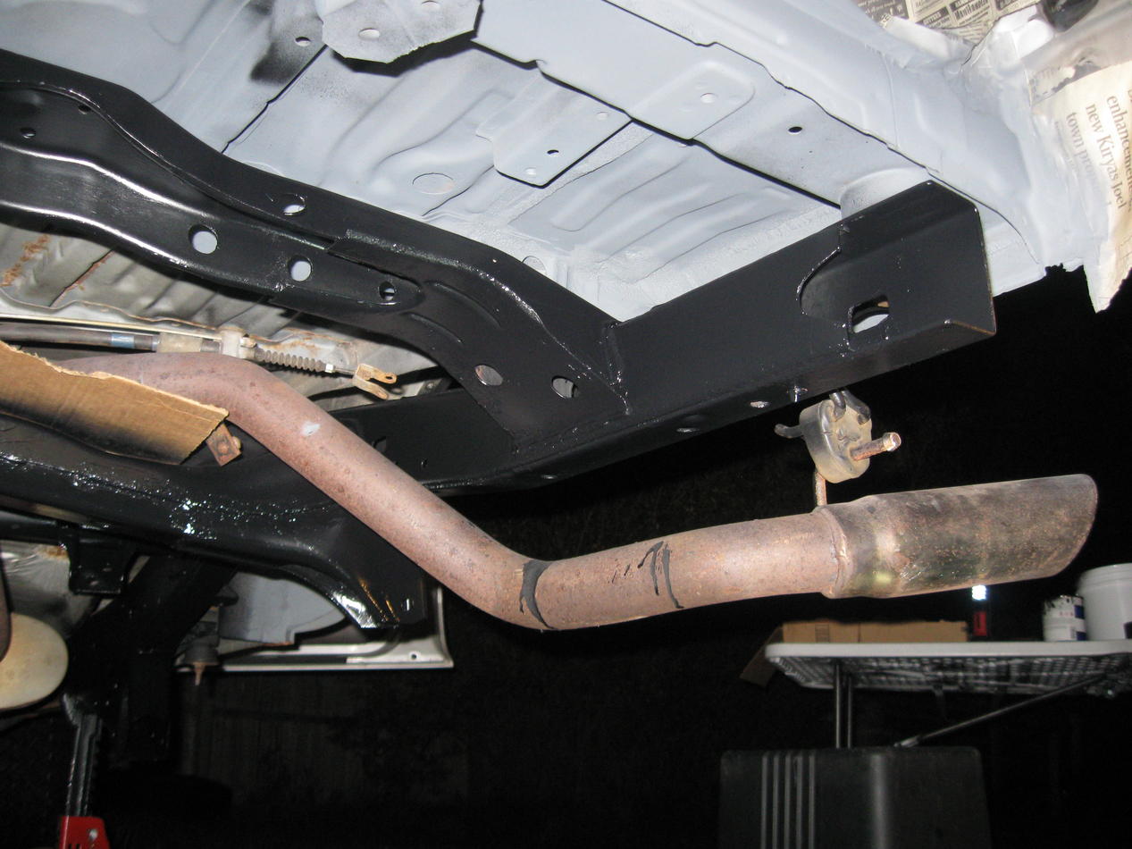

Get your paints & brushes ready! POR15 or Eastwood rust converter both dry quickly so you have to work fast. Thats hard for me because I like to take my time. Also use a little at a time in an old soup of coffee can. Leaving the product can open will ruin it quickly.
Buy pints or quarts & brush on, much cheaper in the long run over spay cans. Use the 360* tube spray nozzles to get into the frame & nooks & crannies of the cross members & places that brushes wont reach.
It def helps to remove the axle, springs, shocks etc.

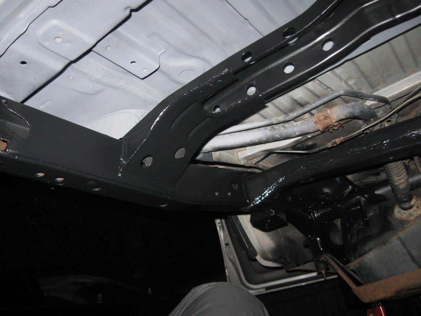

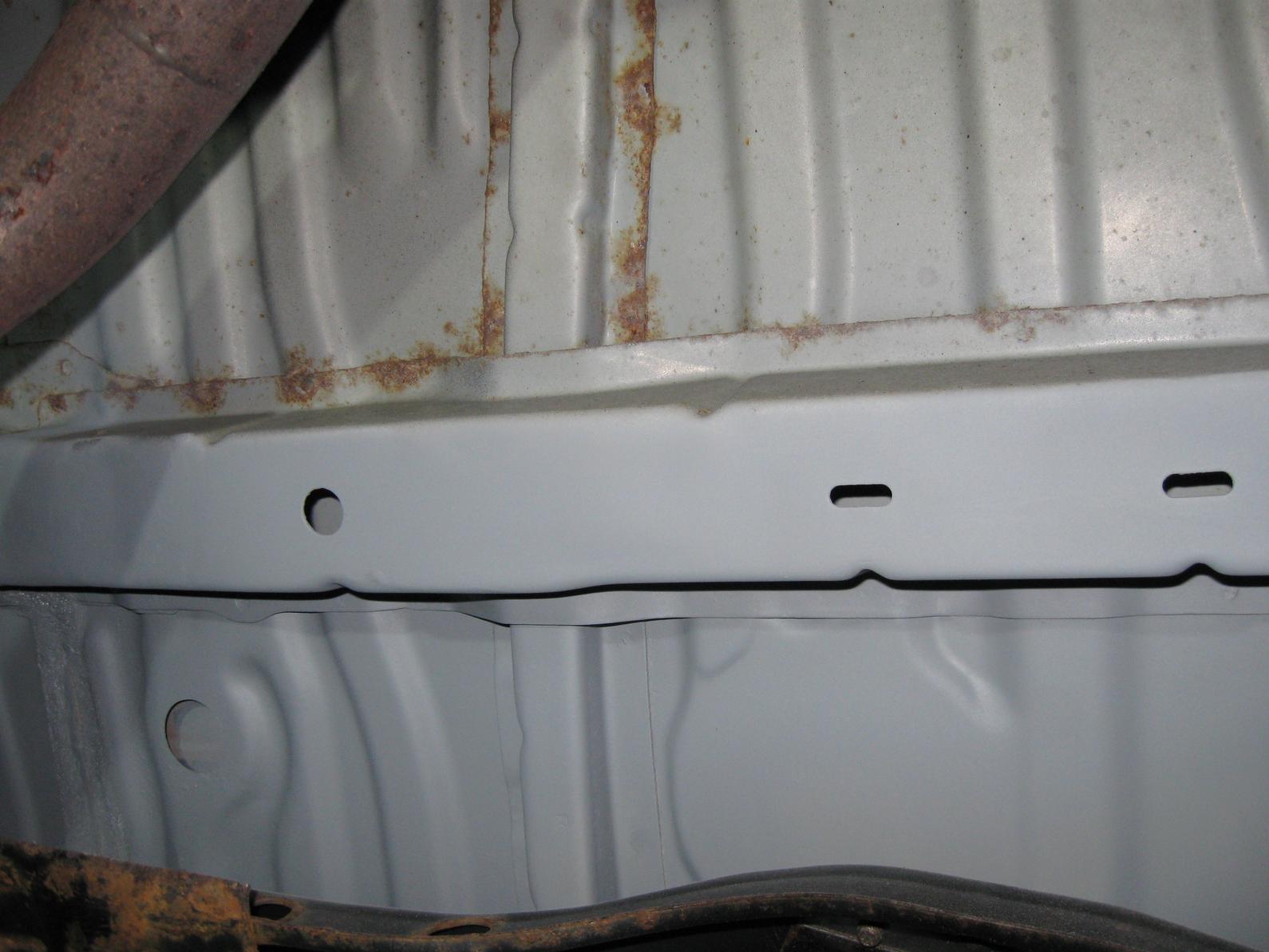

Forget about doing this in a weekend. To do it right takes many hours.
I did a few hrs every weekend for 2 months & have only completed from the LCA mounts back. Work in smalls sections & do it right otherwise the time you did spend will be wasted. I dont have my lift set up yet & I was doing this on my back too. I used two old queen size bed pillows to prop my neck up while I was working. I also recommend some percocets & good music to hum you along. ;-)
I also had to work on the body because the spot welds were starting to rust.
You can see some of the floor below. I wire wheeled the rust off & sprayed 2 coats of Eastwood Grey rust converter. No top coat because I'm never driving this in the salt again.

Scramble - here it is blown up. This is actually the worst places on the truck. besides the skid plate under the gas tank - you can kinda see in the pic. I'm trying to get that off so I can steel it and paint it up too.
