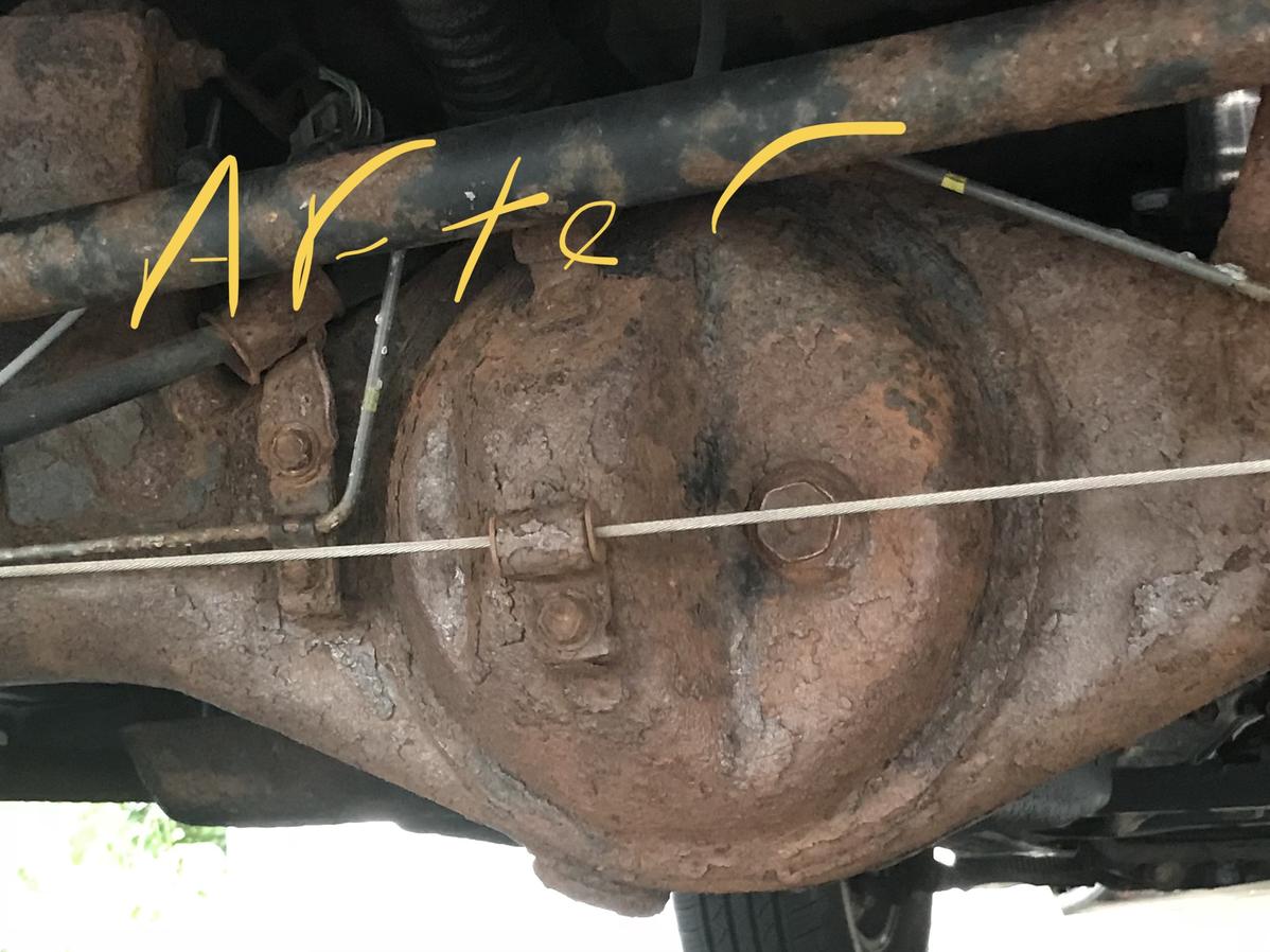

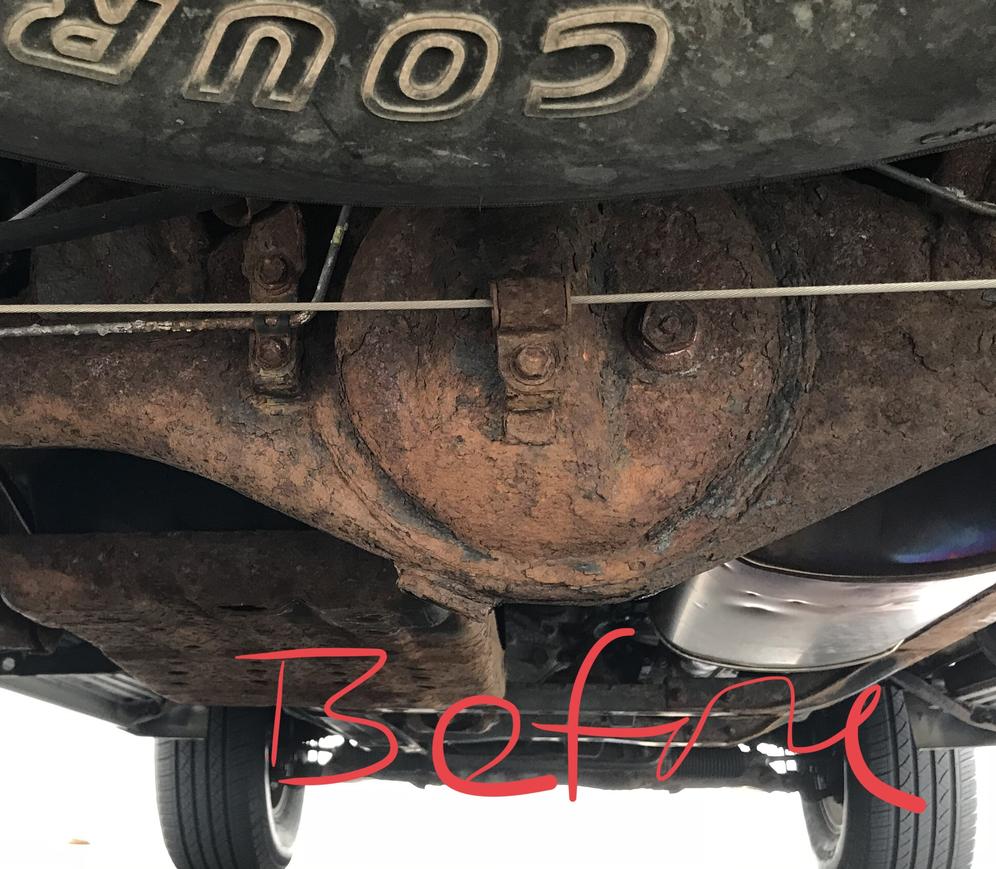

Scramble - here it is blown up. This is actually the worst places on the truck. besides the skid plate under the gas tank - you can kinda see in the pic. I'm trying to get that off so I can steel it and paint it up too.
Damn that's crusty! That metal is thin on the back of the diff when new. Be very careful with the wire wheel on a drill. I dont see any wet spots so thats good. I'd put a rust converter on there. Coroseal or Eastwood will work. Then a rust encapsulator & top coat.
I wouldn't waste my time with the skid plate, chuck it & get a LIL Skips.
[MENTION=175800]TrexRunnerGirl[/MENTION], I mentioned the soda blaster, HF sells sand blaster there is a difference. You really don't want to use sand it gets in places you can't wash it out of then holds moisture paint won't adhere to metal rust is next, Soda can be washed out very easy. The HF blaster is a piece of garbage more headache than its worth for what your facing. Try checking in your area for someone that does blasting (soda preferably) see what that costs, then you do the prep n paint.
Your rearend is scary, paint more than likely not curing that.
So I spent time today relaxing and rust busting. I feel a bit accomplished. Here’s a before and after of that crusty diff.
Now beer thirty and a shower.

With that level of rust damage to the rear end housing, your at risk of perforation and a leak. Don’t waste your time cleaning it up, just get a rust free housing and swap it in.
I didn't think that was a possibility since these are welded unlike others where you can switch them out a bit easier.
And since it's a 99 limited it has the e-locker that everyone is so keen on - I think - correct, so not an easy task to find a replacement?
