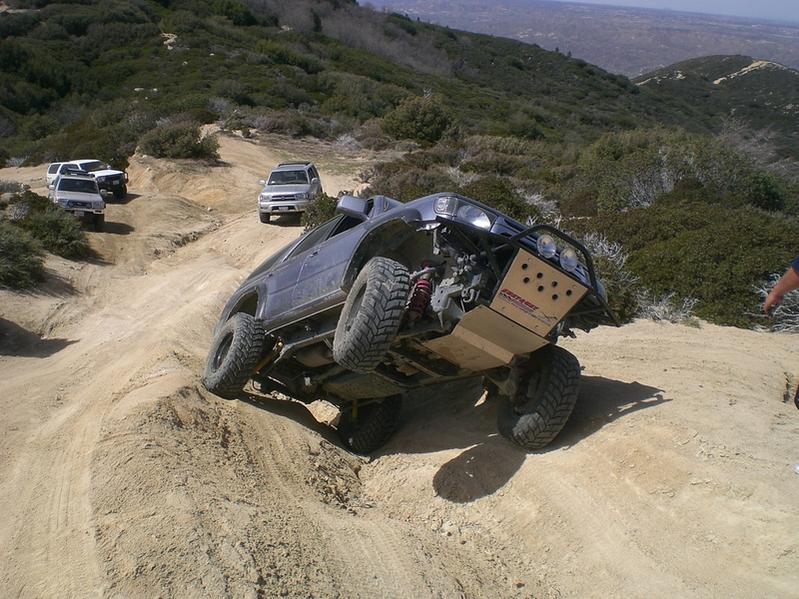

Even though you have the right tires, and the Sonoran 1.2 lift.. you can still get stuck from being stupid.. :D

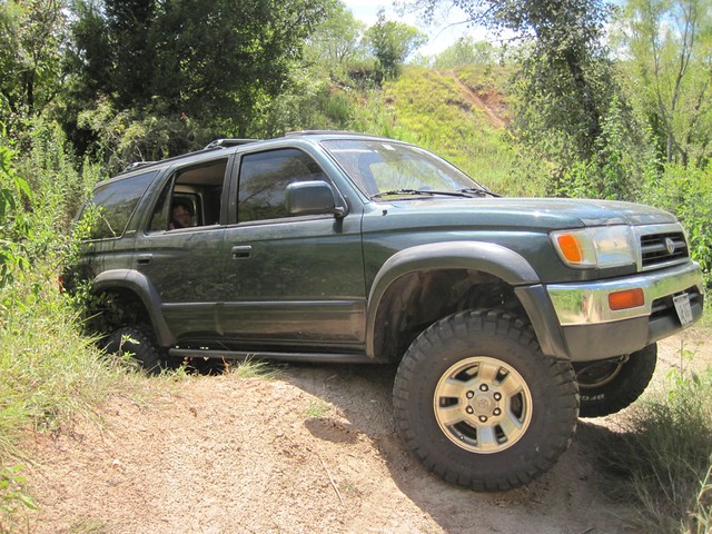

High Centered.. and ironically the only picture I have of my own truck on the trail this past weekend. the Rig did great, but both front and rear bumpers gotta go!! I hit both, and had to pull them back out. It pushes them into the wheel wells, and rubs horribly..
Did you cut the legs on your sliders or is that the length they came? I know you can set your own angle, but I like how far yours stick out - not too much that they hang up on rocks and not so far in they don't protect enough.
I just ordered the same ones a few days ago from 4xinnov. (my TG sliders don't protect my rear doors enough and I got scars to prove it now!). They're getting cut off and I'm putting the 66" DOMs on like you.
What up! Hey are those KM2's E rated? Is the ride harsh/stiff?
Whazzup Mauzer!
Yes, E rated.. ride harsh: Um, not so much.. any at/offroad tire is going to ride rougher/make more noise. I love them honestly.. when I 20 psi on the trail, it was like I had a Cadillac on the dirt roads. You are welcome to drive my Caddy and see for yourself if we meet sometime.

Yeah I'm use to the A/T's on my Jeep (shhhh) but I've heard the sidewall on the E rated tires are too stiff and makes the ride harsh on road (since I DD my runner). I think I'm gonna put some used 285's on first then save up for the Maxxis 255's since they offer them in an 8 ply flavor. I don't think I'm gonna make it to the Padre meet but hopefully I'll get to see the caddy in action soon.
Well, I was going to do the 285/75/16 but.. was told the 255/85/16 on the stock 7" rim would clear the best through full travel of the suspension, so that is what I did. 285 on an 8" rim rubs, and maybe a little on the stock 7" wheel... just what I hear. Acutally, Brian can probably answer that better than I. 255 is not "too stiff", and works excellent overall for my needs. :D
