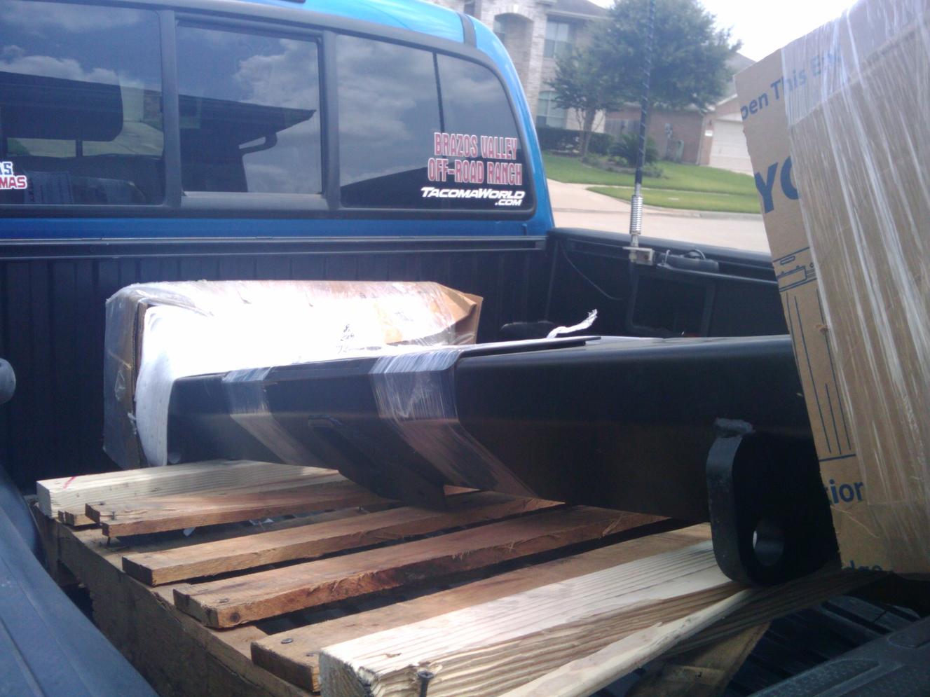

Not this one, but probably the following weekend. We will need to cut some support beams and re-weld them. For those that don't know, I got a smokin deal on a "Scratch and dent" bumper from CBI.

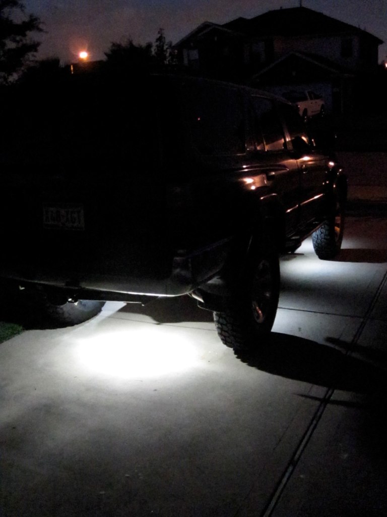

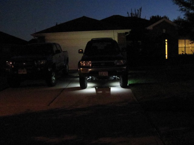

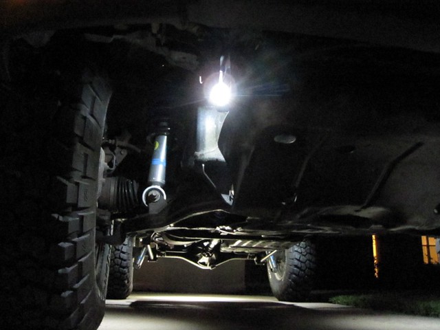

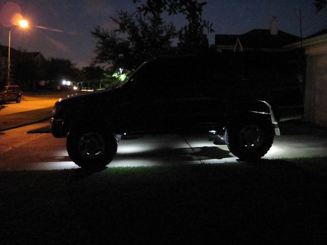

Ok, here are some rocklights I installed this past weekend, super easy.. super cool. I wired 6 lights in Parallel, just ran one 20 Gauge wire around the truck, and taped into each one for power and grounded them to the frame. In the rear, I used a "Sound off signal" Mini3 surface mount spotlight.. truly it's overkill, but if someone is following me down a hill.. I wanted to flash them. :D
I bought 10 Lights from Oznium.com $2.99 each.. I used 6 LEDS plus the Surface mount spotlight in the rear.
12V LED - Pre-wired Waterproof SuperFlux LEDs
If you angle them out you will get more use out of them. I set all mine at a 30 to 45 degree angle... and they are very handy during those night wheeling runs.
Well, I didn't think the LED light "went the distance" at an angle, so I got some 14.99$ little fog lamps for that purpose. 45 Degrees in the front corners.. Definitely more effective for night wheeling.

wait it doesnt fit right? is it made for our 3rd gen 4runners, bc thats sad that it doesnt fit like it should and requires some mods to make it work.
Yes, 3rd Gen bumper for this vehicle.. I asked for deals and a beat up model, and he had a brand new one that he said "shrank" more than he expected when he welded it. He said you could probably hammer it on there, or you "might" have to cut the supports and shorten them before welding it on. Either way, I got it covered and Steve gave me a hell of a deal.. and I didn't have to wait for 4 months either.. :D
