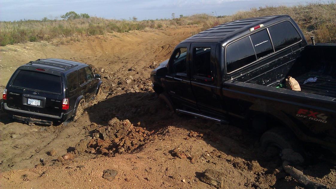

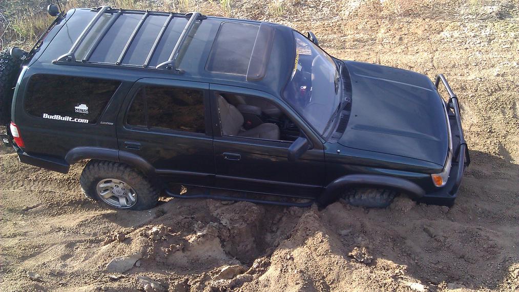

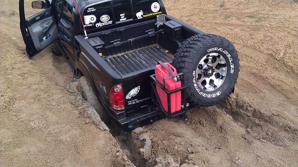

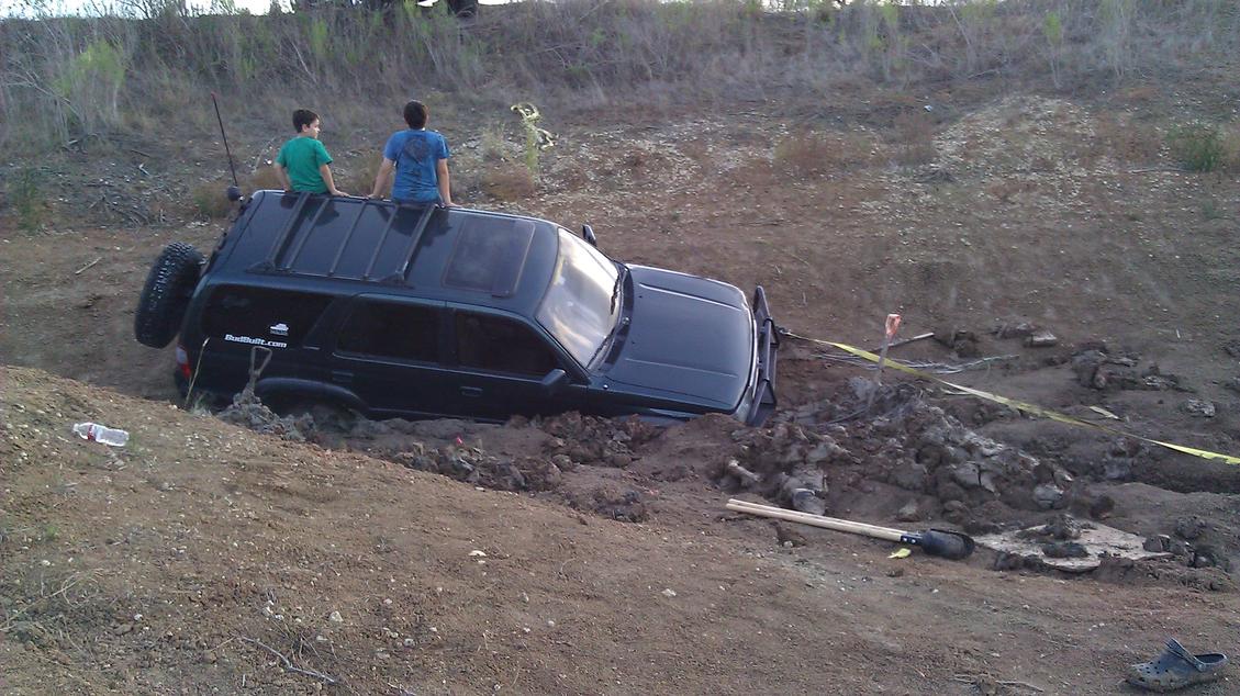

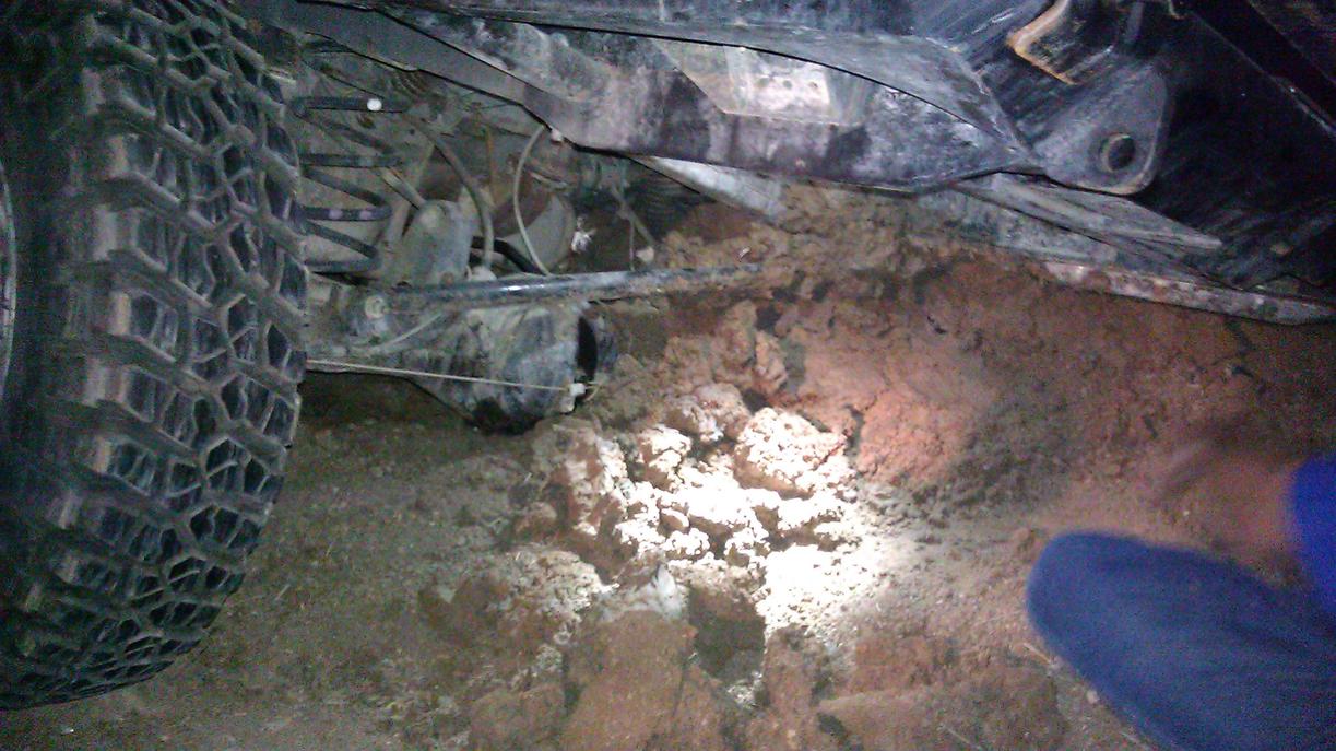

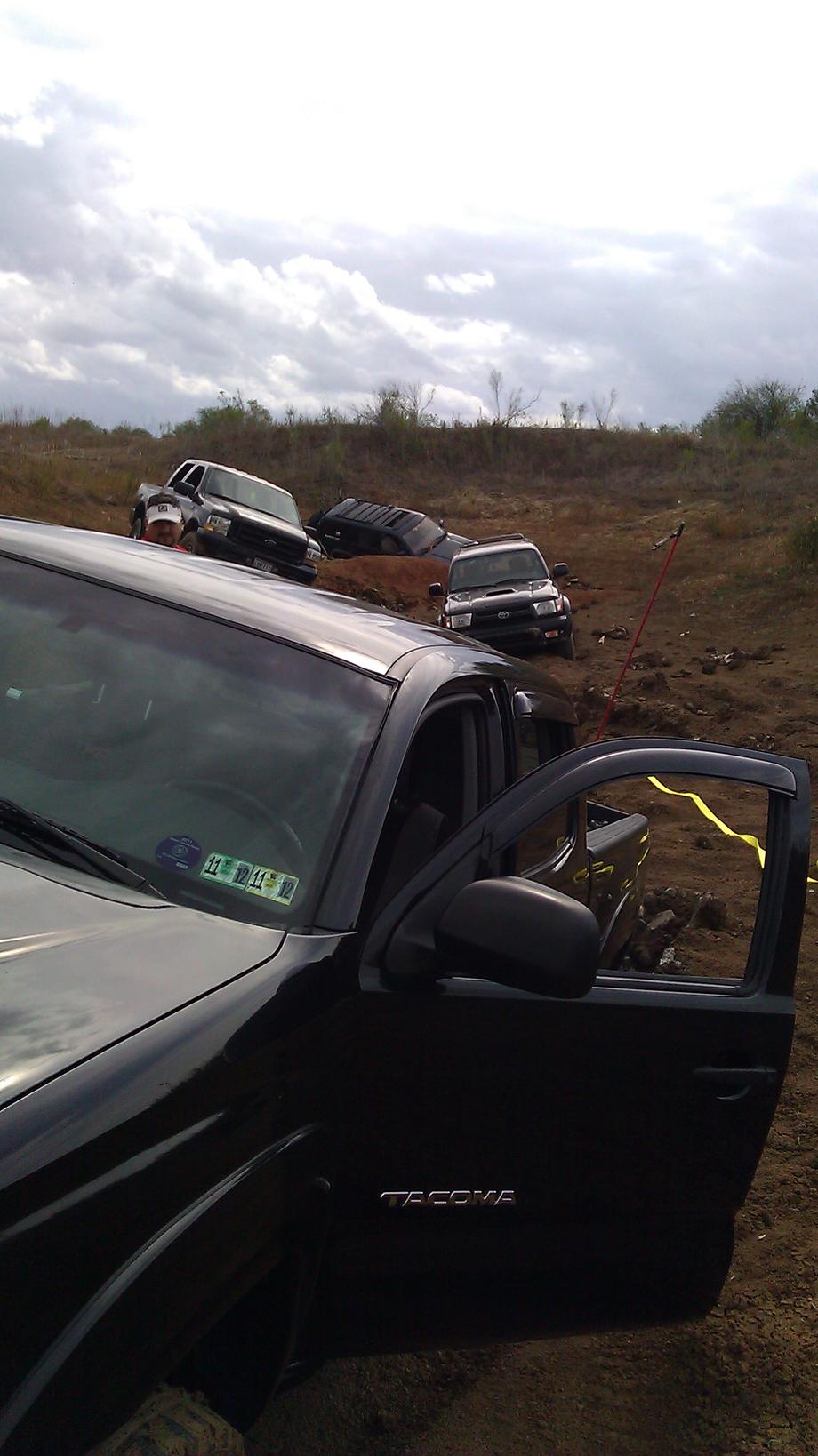

This past weekend, got stuck in the mud for 10+ hours.. I had my Kids with me at the time. Had a fellow forum member get stuck 15 minutes from my house so I decided to show up and help.. got stuck before 9 am and out after dark _7:30 ish).
Enjoy..
[/ATTACH][/ATTACH][/ATTACH][/ATTACH][/ATTACH]
The 99 SC runner was the first to get stuck, then the Ford 250, then me, than the 2nd Gen Tacoma.. The Tacoma got out first, then got the 99 and the Ford out but couldn't get me loose. it took a tow truck and the ford 250 4x4 to pull at the same time to break mine loose.

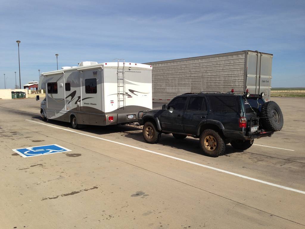

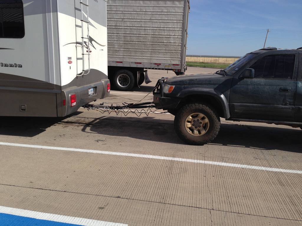

I now tow the 4runner behind my Winnebago, it works great. @4500 lbs, it's not really a big deal for the v10 E450 chassis. long trips, I remove the driveline and leave it in 2hi.. for short trips (100 miles one way), i just shift the transfer case into Neutral. I have been checking the output bearing on the transfer case with my hand, it's barely warm.. so pretty sure it's ok.

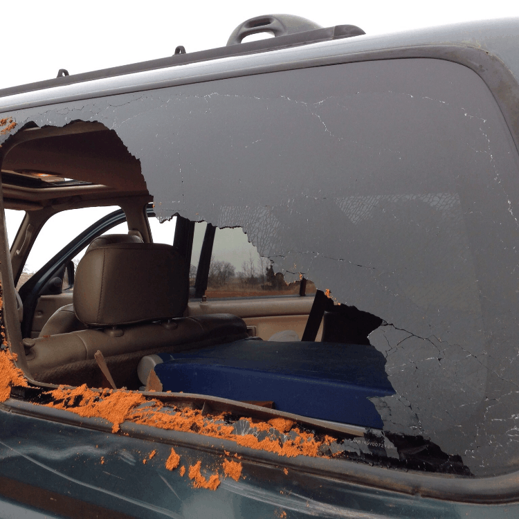

yes, I know my truck was very dirty.. towing it behind the Winnebago seems to do that. I busted out my passenger driver rear quarter glass... tried replacing it with Lexan... glued it back in I don't know how many times.. I have now given up. I got new replacement glass... should go in this weekend.

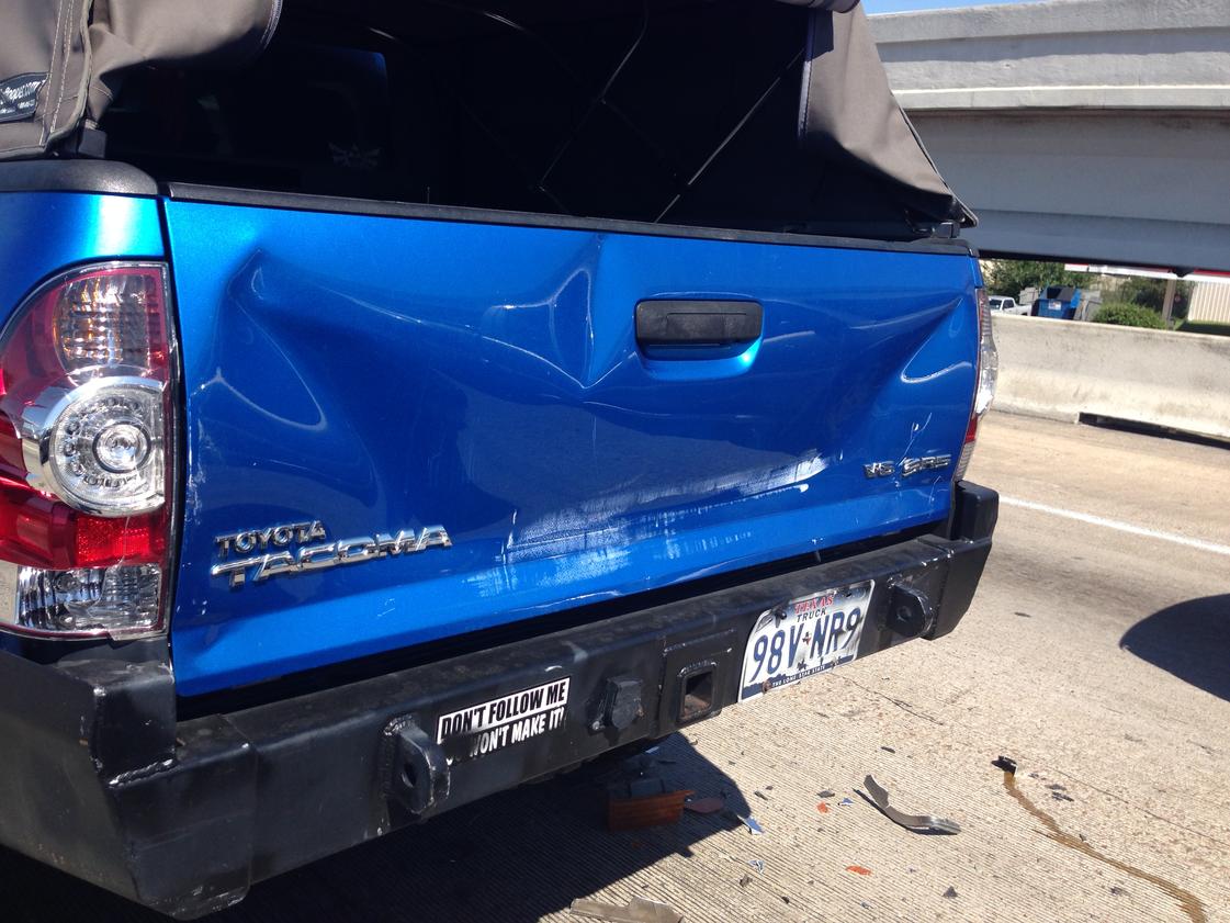

I have to get it out of the garage because my other truck is going in the shop.. wife got rear ended on the freeway..
