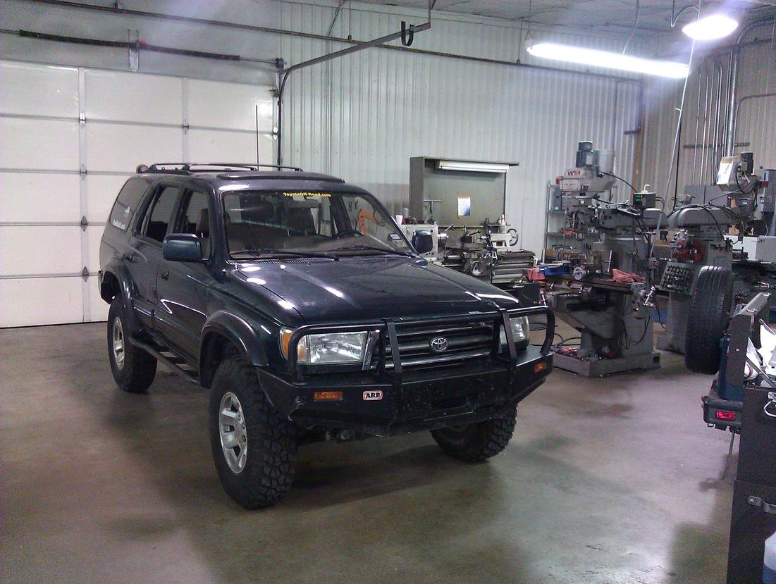

Thanks for the compliments! I have been working hard on it. Current pic here:

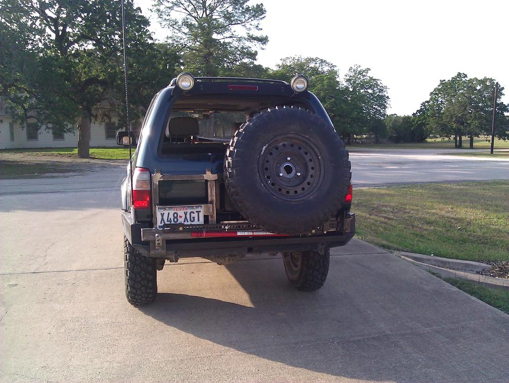

Long time since my last post..
in the last three weeks, I installed rear Hellas from the back for more lighting, they work GREAT! re-installed the CB, and ran the wire better this time, mounted the antenna on the CBI bumper. Replaced my AC compressor, installed a Bud Built front skid, and wired up my ARB fridge in the back.

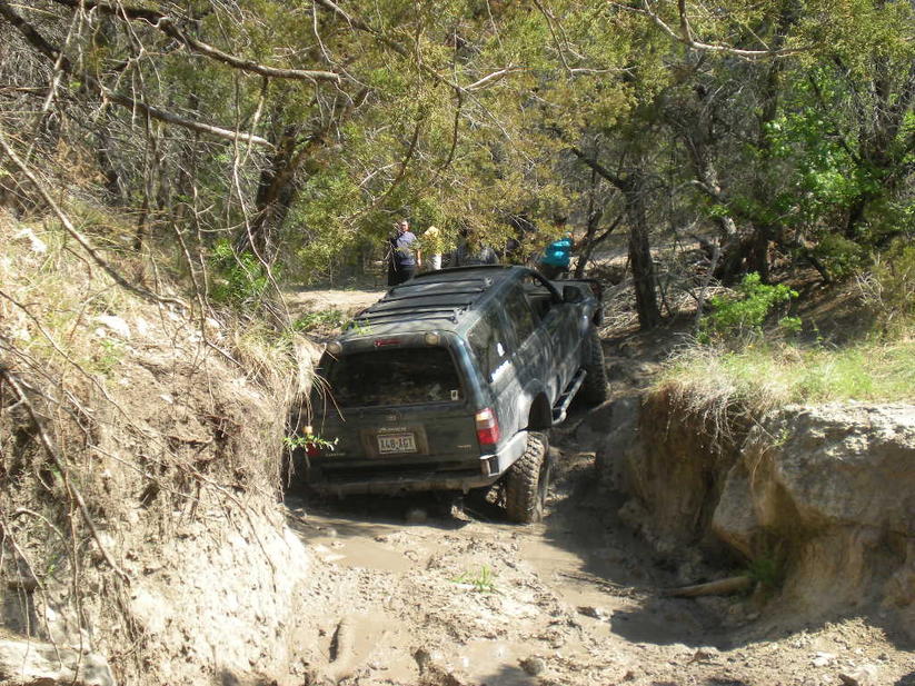

Spent the past weekend at Hidden Falls in Texas. Got some rock damage, and got backed into by Drunk Rock buggy.
Before Rock
After Rock
Repair
After Hammer repair
Front fender popped back out..

Pulled into my Friends shop for some more work.

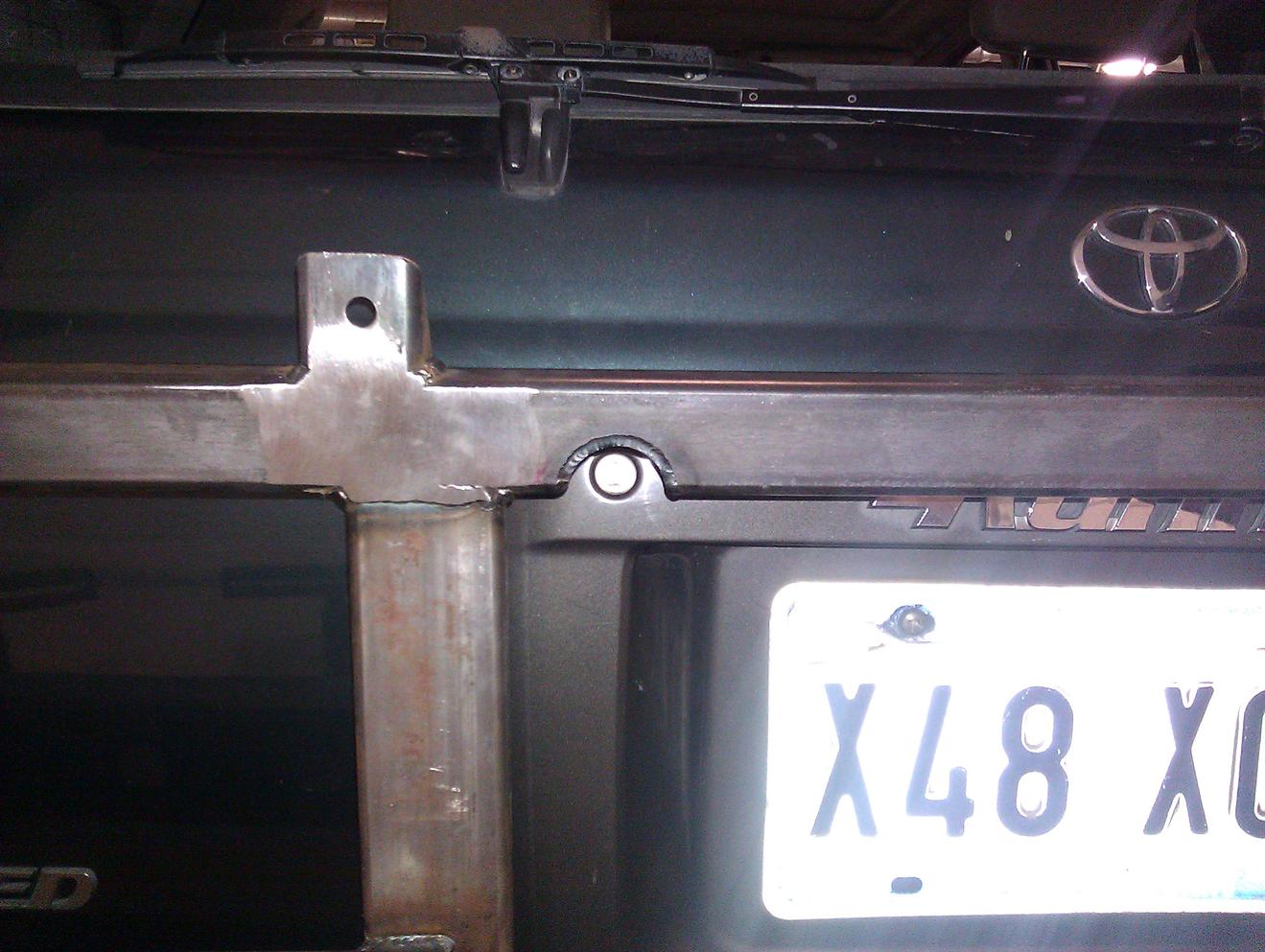

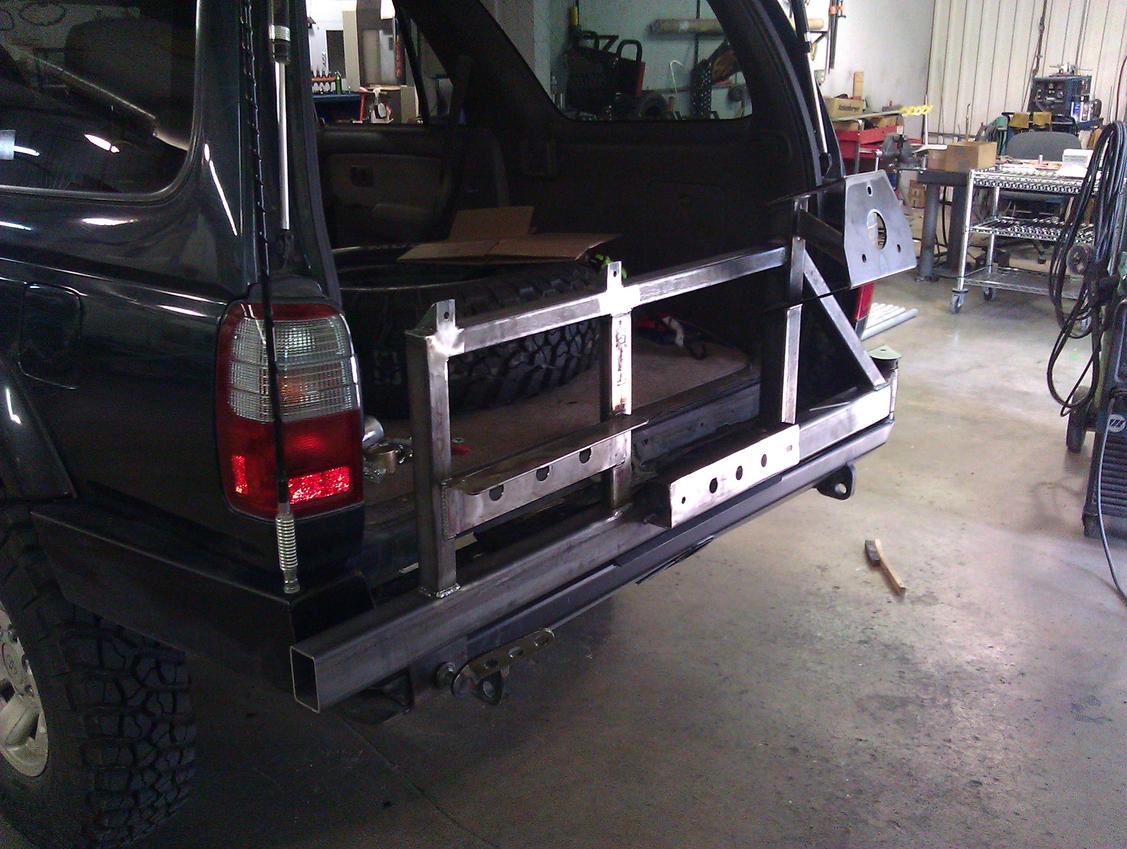

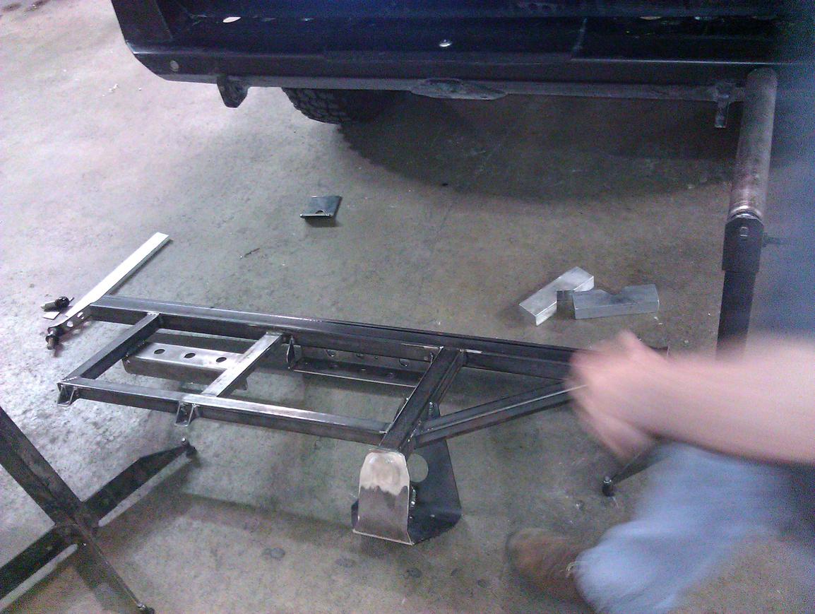

Swingout from CBI - Very Nice!

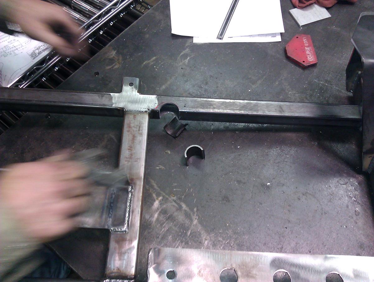

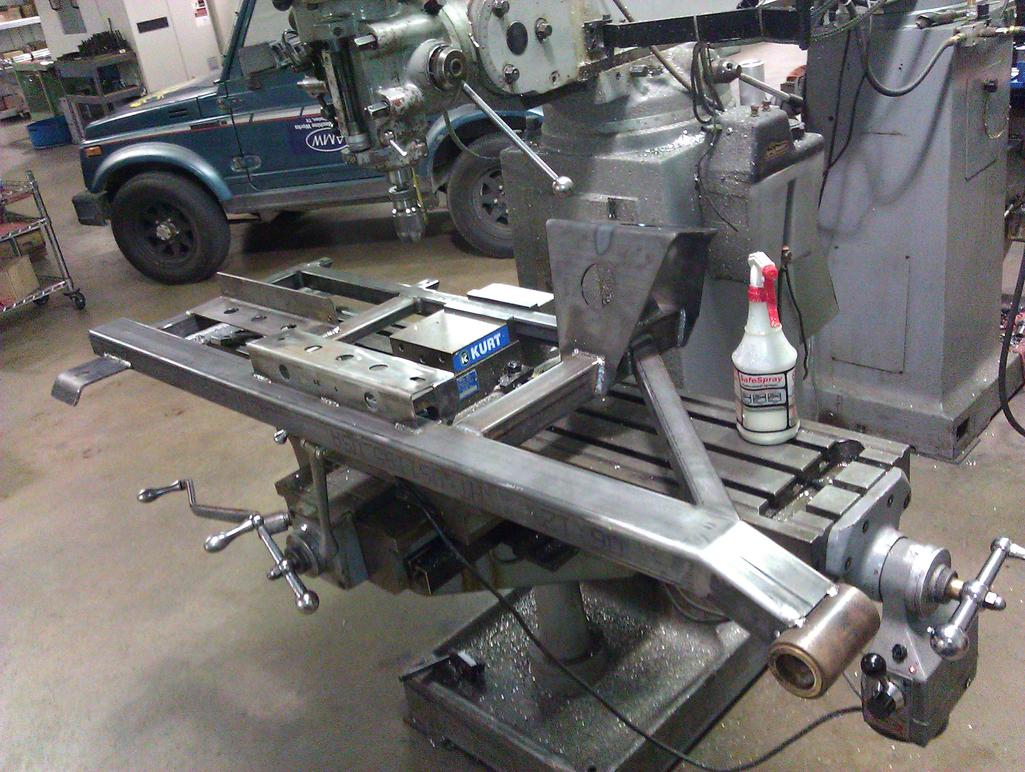

As you can see, it needs some work.. a little long

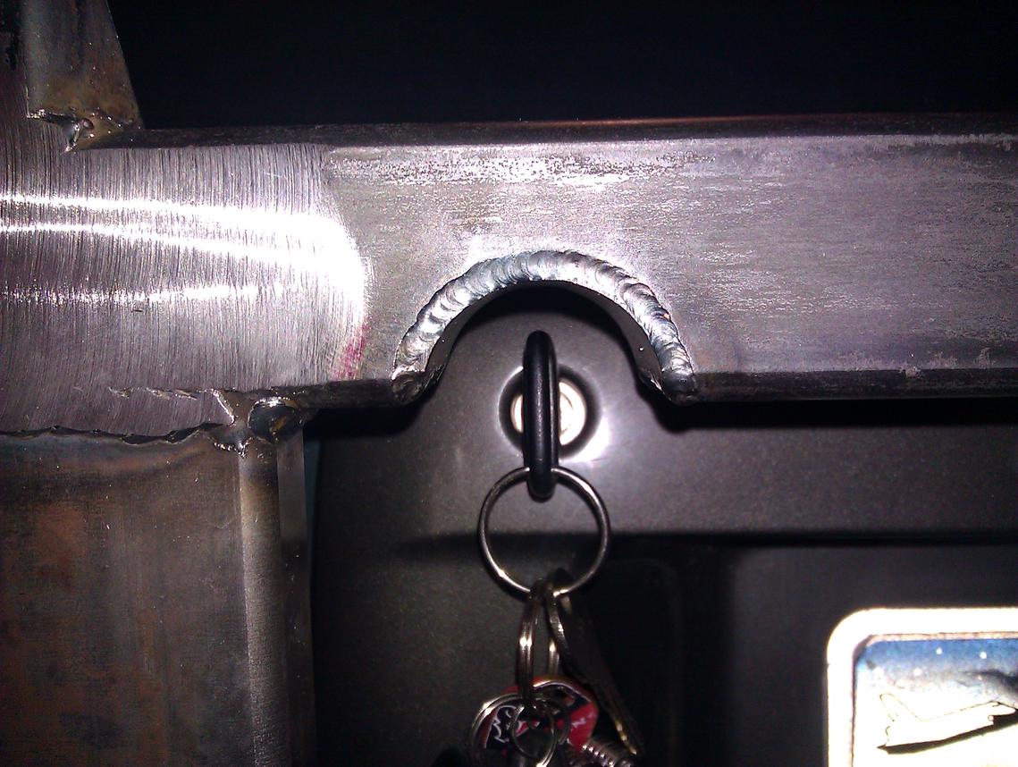

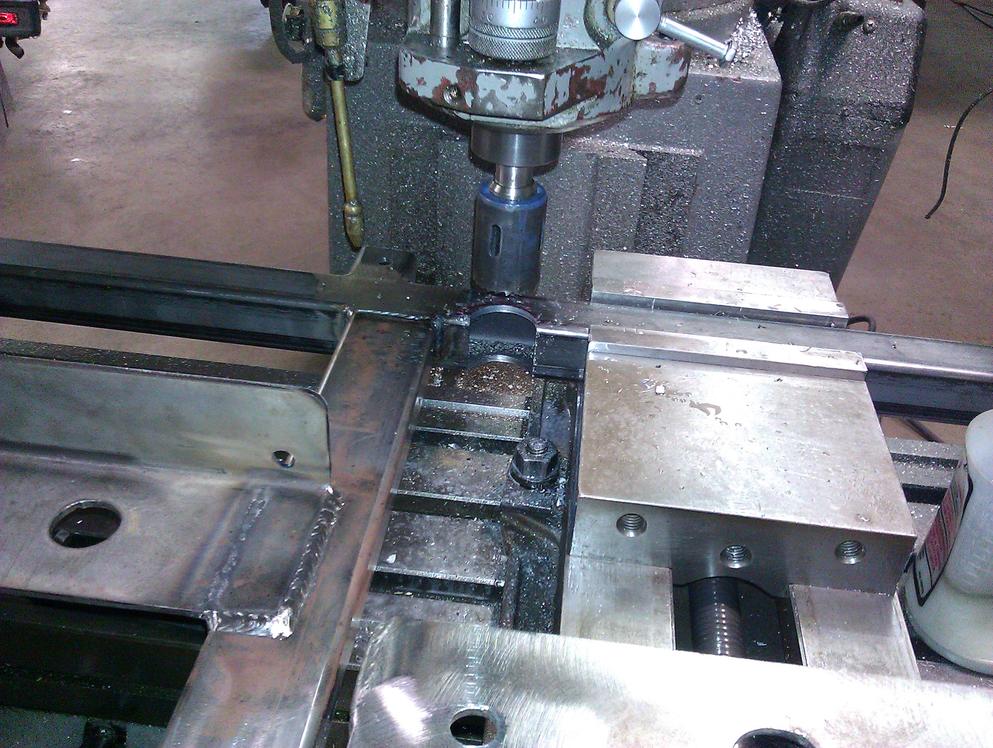

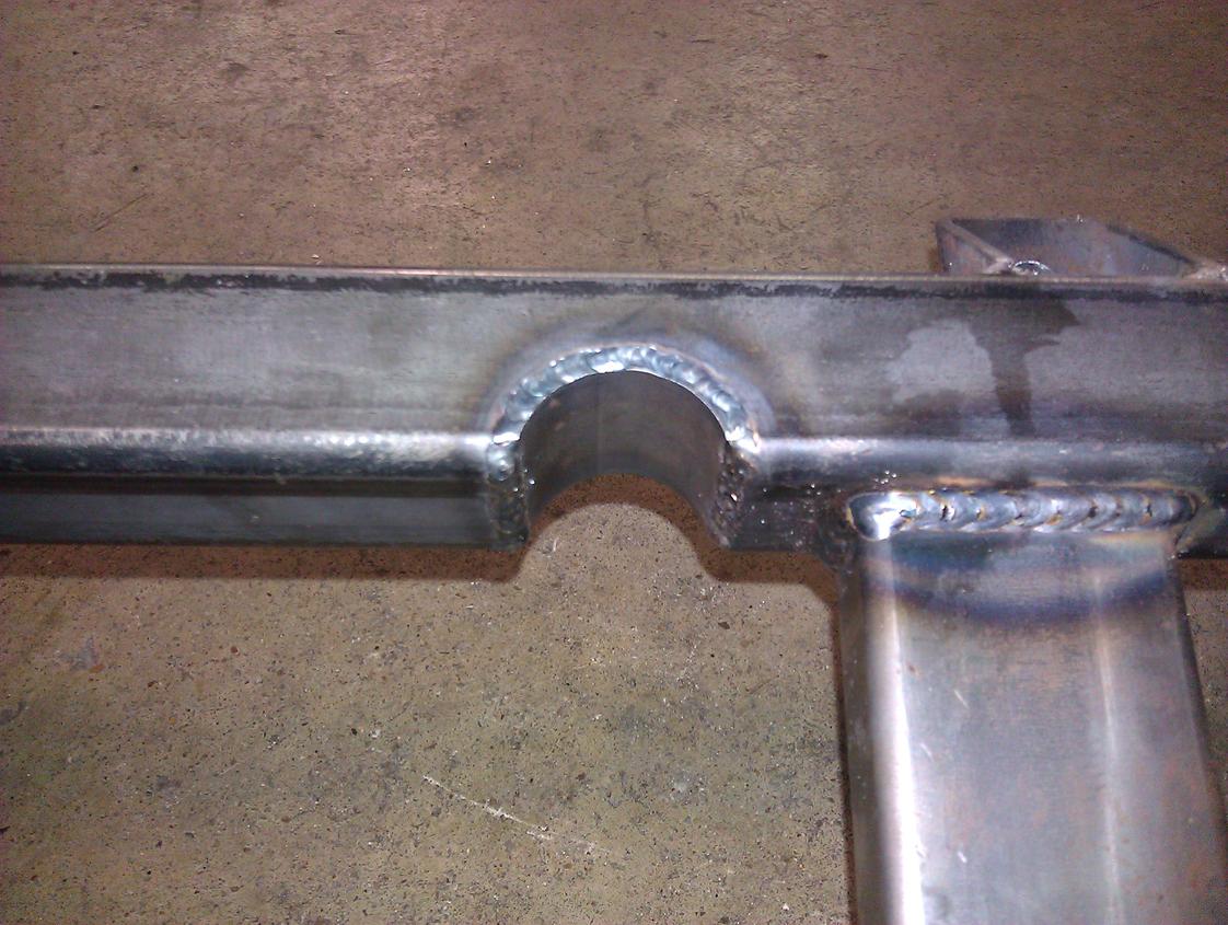

Wanted to make a hole so I can slide the key in and out. It's always nice to have this kind of equipment laying around..
TIG weld.
Viola, the key hole Lines up so I can roll the window up and down with the key without having to swing it open. It's important to note I purchased the bumper and swing out seperate. The latest models will NOT need this mod, I noticed CBI moved the whole swing out up almost an inch.

As you can see, the key is usable now without having to swing it open first.
