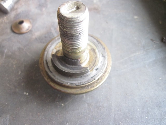

Developed the most awful noise you could have on an engine. A kind of metal on metal make you grind your teeth sound. Changes with RPM, and with the AC cycling. never "actually" goes away. Under visual inspection, the clutch plate on the AC Compressor wobbles.. has play.. I would call it excessive. Well last night, I took off the belt and pulled the front of the clutch apart. Looked like an old worn out brake drum.. what a mess. I am going wheeling this weekend, and can't stand the sound so I cut the belt.
I am going to research the AC clutch now.. sounds like the have a rebuild kit for about $130.00. What do you expect for a 13 year old AC compressor in Texas.. yeah, it got used a lot!

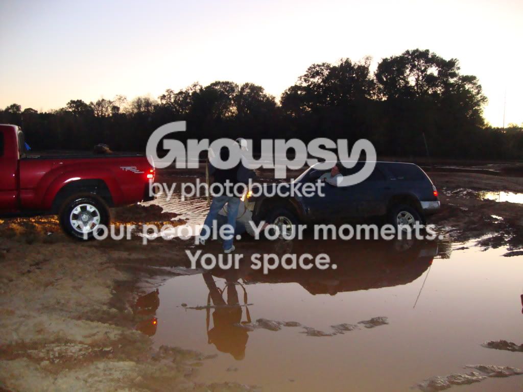

Check out this mud hole.. Mud in the cab!
DSC02266.jpg~original
052.jpg~original

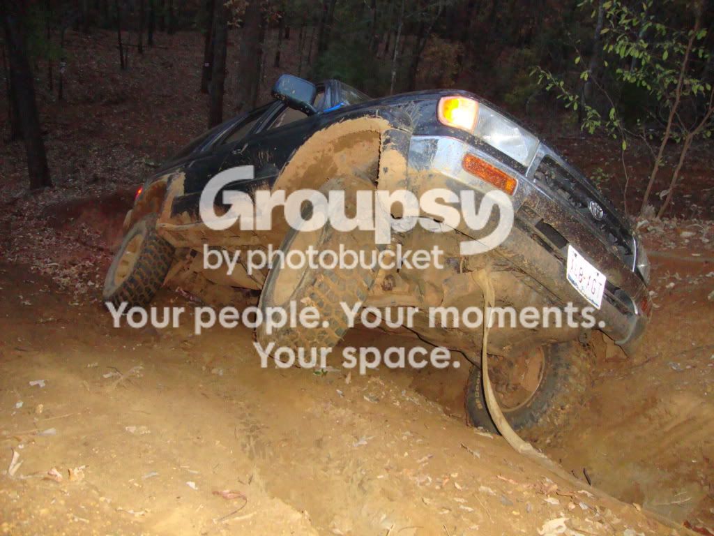

I'd like to use a lifeline, phone a friend? Hmm.. how am I going to get myself out of this one?
DSC02305.jpg~original

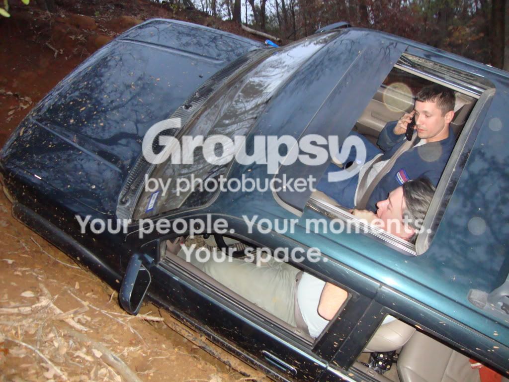

View from the other side.. Passenger front is almost a foot off the ground.

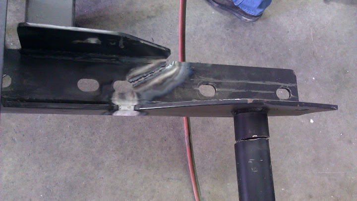

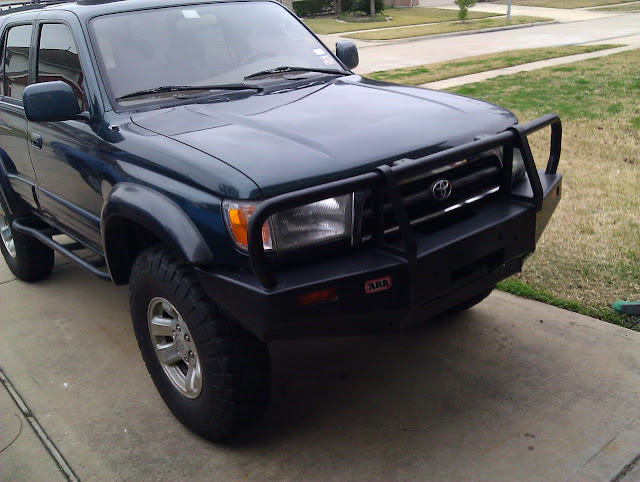

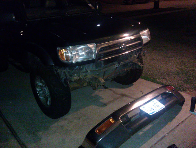

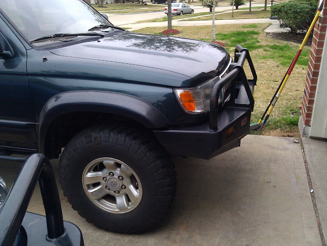

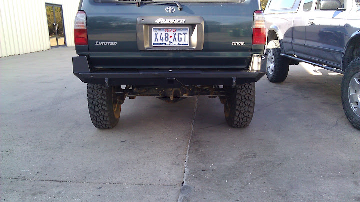

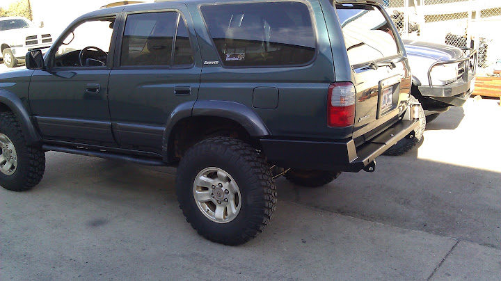

Ok, Bumper is Done!

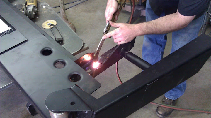

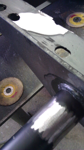

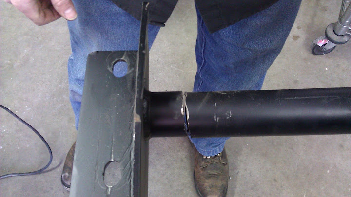

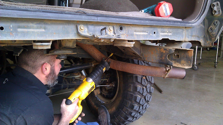

A little Background story.. I bought the bumper from Steve at CBI. I asked for a "Scratch and dent" type of deal, and he happened to have a bumper that didn't fit right. Somehow or another, it shrank after welding and didn't line up. This thing is freaking solid, Steve did an amazing job putting it together and it is extremely well put-together. Ultimately it took about 4 hours, we had to cut it with a torch. Pounded on the truck and then put the bolts in before spot welding it. Took it back off welded it, and reinstalled it... Pictures below.
All cut up, we forced it on like this and got things to line up. Todd spot welded it on the truck before finalizing it.
Check out the super clean work after it was cut and welded back together!

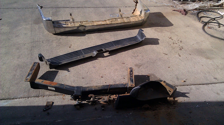

Had to cut the Muffler for the bumper, and it needed to be done anyway..
97 & 98.. Good Years.
Know anyone that needs this junk?

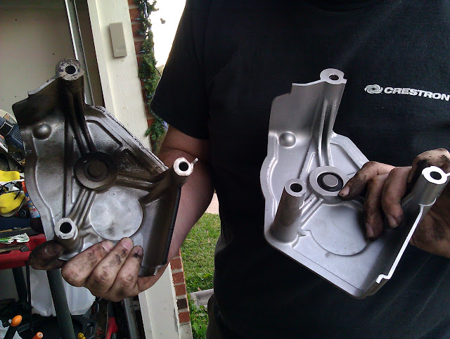

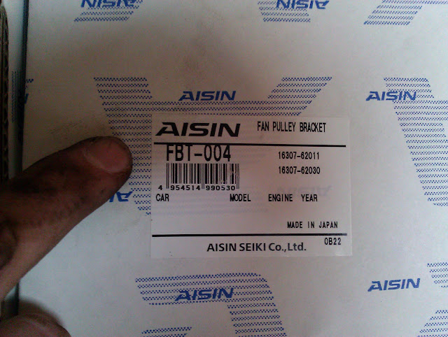

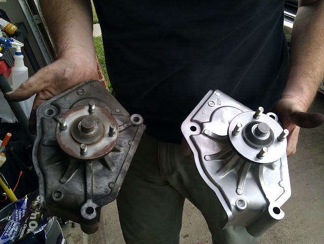

Replaced my Fan Bearing Bracket while trying to get rid of a noise.
Rockauto has the Aisin OE piece for $135.99. That's sure to be the same as what Toyota WON'T sell you, except as part of the whole package. AISIN makes the OE fan clutch, too.
I think I'll go with Aisin, thanks alot for the info.
I did this yesterday, very easy to do. I took pictures of the new part from RockAtuo (FBT004) and the old one.. likes like the same thing to me.
Sadly, this was not my noise I was hearing.. so if anyone wants buy my old one... :D

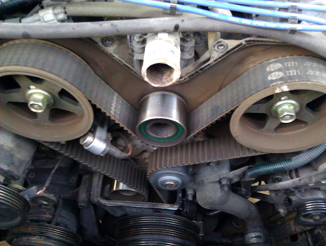

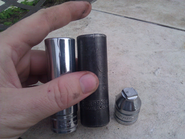

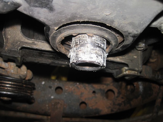

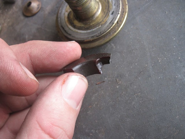

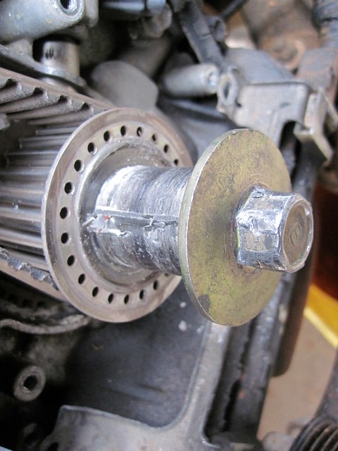

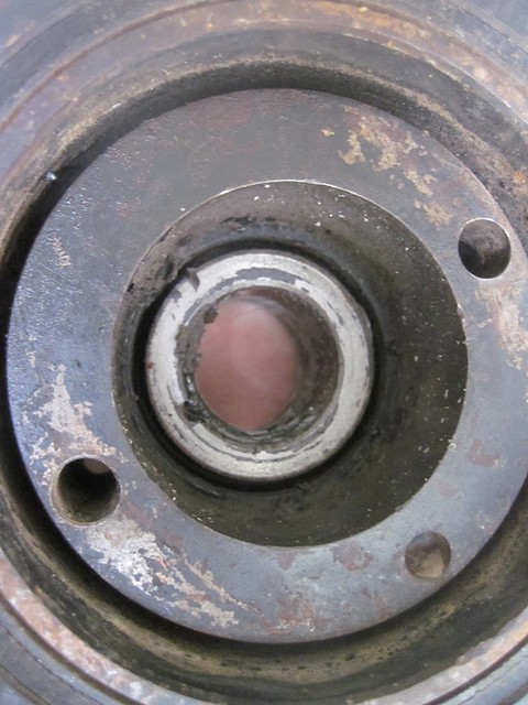

I have been working on chasing down an annoying noise. I had to remove all the accessory belts, Inspection cover and Fan bracket & run the engine on the battery alone to locate it. The pulleys on the timing belt were making some noises so I replaced the Belt, and both pulleys. While I had it apart, there was no leak and no play in the water pump so I just left it alone. It took me a week because of the holiday season and timing + I broke 3 deep 19mm sockets on the freaking crank.. I wasn't sure if I was moving it or not. I decided to take a break from breaking sockets and wait for a fried (YotaRob) to come over and help me out.. Never done the timing belt on this engine before so..
OK, after a long week of breaking sockets.. Robbie showed up with two brand new Deep Impact sockets that were made well (Reinforced). I had a New Years eve wrench party.. PhdNPrerunner, Taco4x4Rar, YotaRob attended.. With their help, I finally got my Crank bolt out. Apparently, the previous mechanic put some kind of epoxy to keep the bolt from coming out. It looked like JB weld, and it was smeared on every thing.. This harmonic balancer/bolt fought us every step of the way. Below are some photo's..
Aftermath..
The magic bolt and what was left of epoxy..
The glue that held it on PITA
Left crap on the Crank shaft..
It was all over the Harmonic balancer..
Check out the Key..
Once it was cleaned, and reassembled.. the engine was very quiet. It sounds better than a brand new engine.. I love the 5VZFE!
