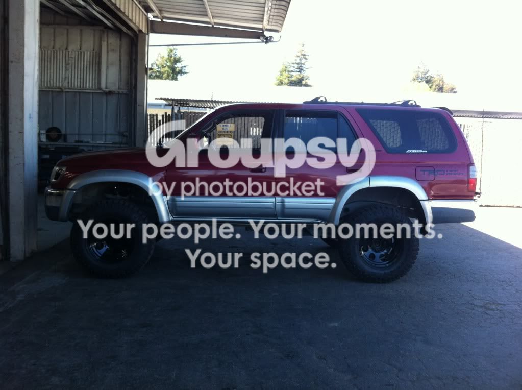

i think i made the right choice. at least for what i want. the ride isnt bad for me. as long as the front isnt taller than the back i am ok with it. maybe later ill put them down but for now i like it.
ya it looks great, the thing is eibach coils are a lot taller than tundra coil, its a softer spring so if i put it on the second or top notch the shock would overextend and break.
I was planning on the second one with my Tundra TRD coils because I have 8 wraps for the rear of it. I thought with the 1st perch it would have way too much rake.
Since you have LC coils I would run it at least on the 2nd perch. Mine are on the first perch and i have a rake in the rear with 890s so I can imagine it would be a pretty good rake with 8 wraps. I am going to be moving mine up to the second perch soon
thanks dude. i didnt know that about the eibach's. do you know anything about the TW hollister trip later this month?

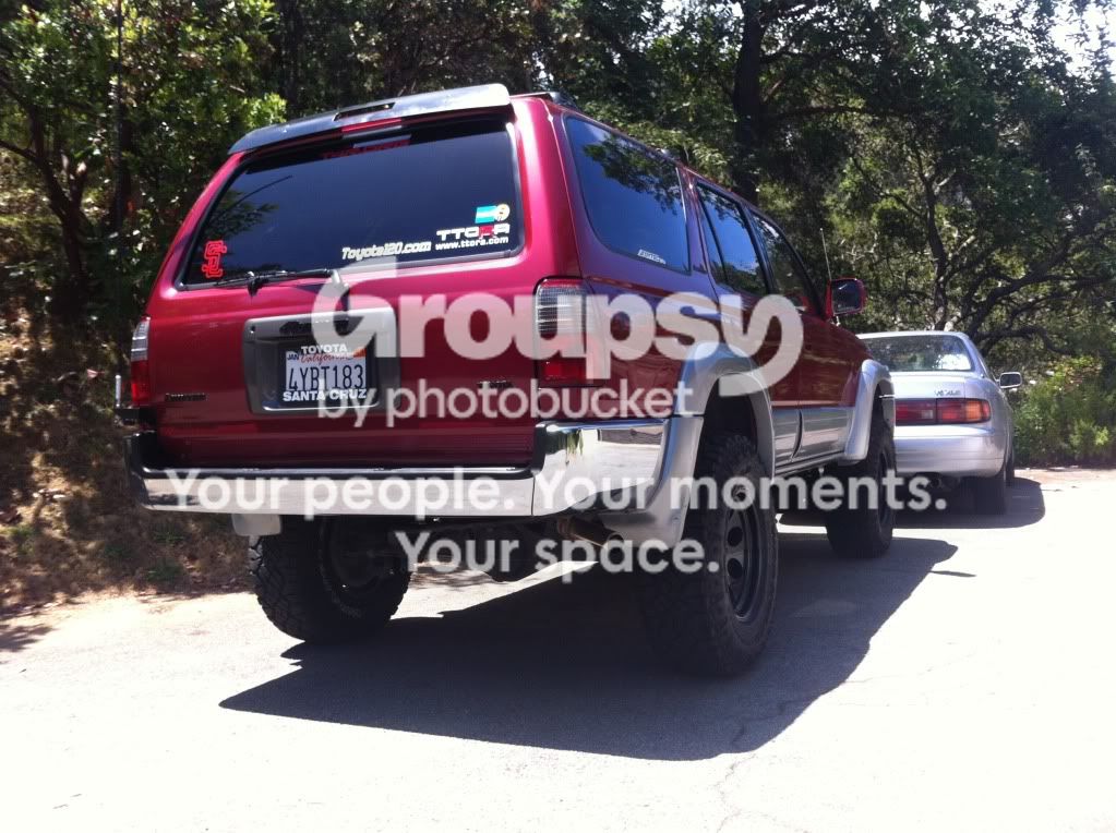

forgot to post a pic of this: took of the tow hitch. brought the back up some so the rake is better now.
IMG_3351.jpg~original
Perfect IMO. I'll be going with a nearly identical tire/suspension setup, and it looks great! Just on the edge of stock...any more and then you are into re-gearing, bigger tires etc...messy! and slower!
Why did you go with Bilsteins? Adjustability? I am trying to decide between OME and Bil's...

LOL, yeah I know. I was just surprised you went with the 3rd, I heard it takes a lot away from the ride. It also didn't look like the 3rd from the pics, thought it was the first. Looks awesome though.
im running mine on the 3rd setting and its perfect IMO, not stiff at all, feels factory and ive even considered going to the 4th -will don once i add a bumper and winch...
i have a good 1.5"s of rake with my 8 wraps, its more than i care for -again im also running the 3rd setting, just something to think of...
with 5100 its best to set at the lowest one. thats where mine is set and i have eibach coils.
yeah i think its best to run the lowest setting maybe the 2nd setting if your nose heavy, ie bumper, winch, and armor with the eibachs
