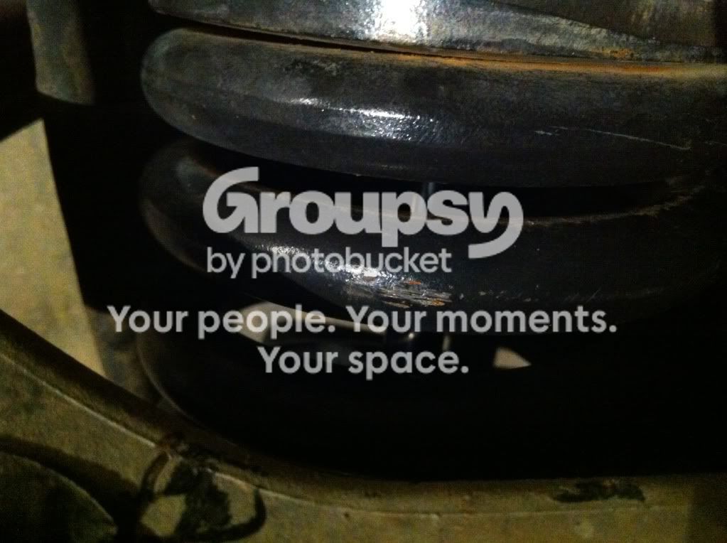

so i went out to see what i could find, nothing that i can see on the passenger side. but this on the driverside.
IMG_3364.jpg~original
so what can i do exactly to fix this??
Did you try rotating the spring 1/3 turn?
If you rotate them, give that same section of coil a fresh coat of paint. :driving: Then check the paint for rubbage.
Hard part is compressing the springs, safety first :police: use new spring compressors! Don't rent!
no i havent done that yet, not exactly sure how.
Well depending on your mechanical comfort level: you can remove the strut assembly and take it to a shop to have it rotated, you could take the whole rig to a shop and have them do it for probably not a whole lot of dough, or what I recommended. Buy a set of spring compressors, and DIY!
You attach the compressors to each opposite side of the coil. Using a standard ratchet wrench, start tightening back and forth between the two compressors a little bit at a time. Eventually the coil will compress enough for some free play, that's when you (mark the coil in relation to the perch first) rotate the coil 1/3 or whatever you think is a better angle away from the rub point. Release the compressors SLOWLY and bob's your uncle. Now you can do shock work yourself to boot :trophy:
thanks, ill have to go out and get some compressors.
good luck :thumb3:
:police: remember, you are attempting one of the easiest and simultaneously most dangerous jobs on a vehicle. Safety first and work slowly! :police:

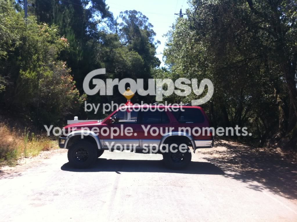

Went on a drive today in the Santa Cruz Mountains, i forgot how beautiful my backyard was! I have no idea why i did it but i just kept going till the road ended! Havent had that much fun driving my runner in a long time. Even on the twisty mountain roads she handeled amazing. Love my truck that much more!
