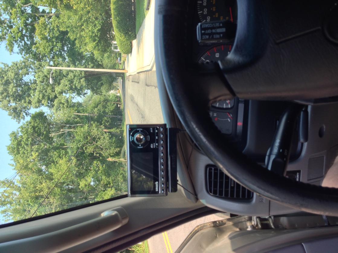

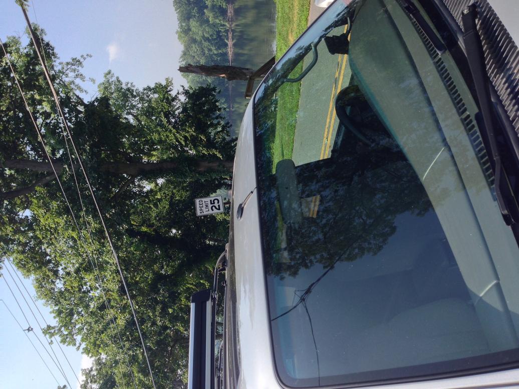

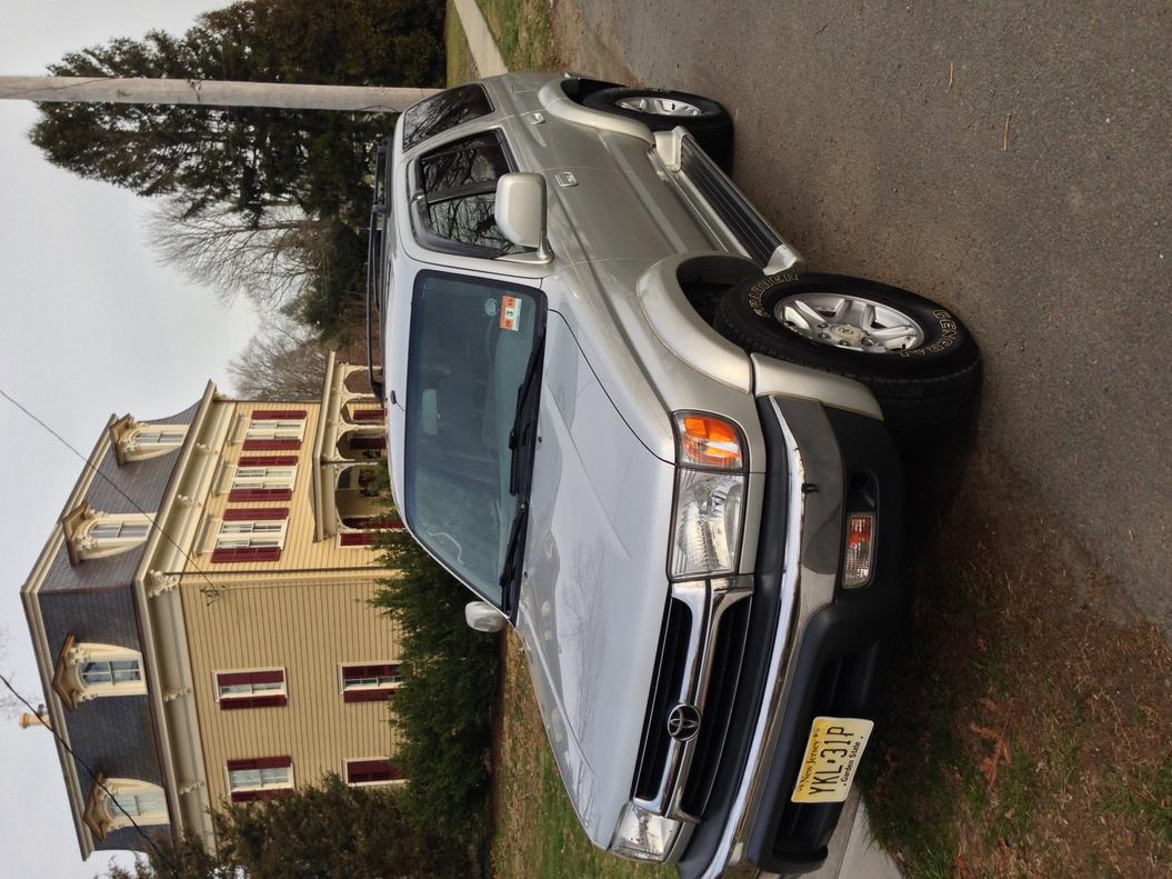

I went a bit of the easier route when I did mine. I just went out front and snapped a couple pics for you. I installed it right above my rear-view mirror on the hood of the truck. I ran the wire and tucked in the windshield trim and through to the inside. I tucked the rest of the bulk wire inside in between the dash and door.
