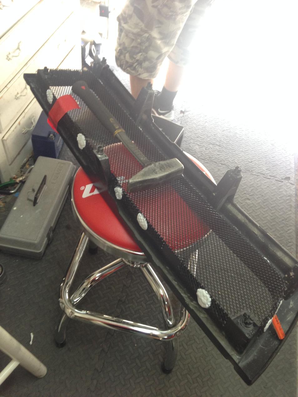

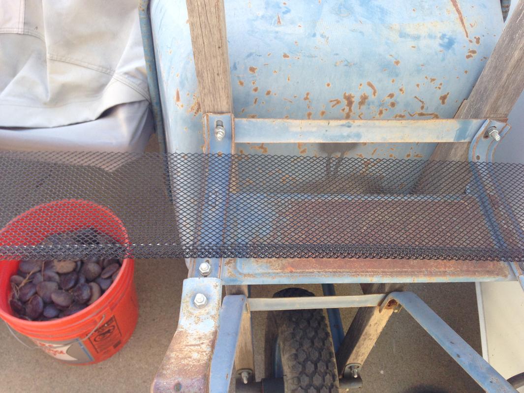

First thing was cutting it out. Worked best with Jig saw

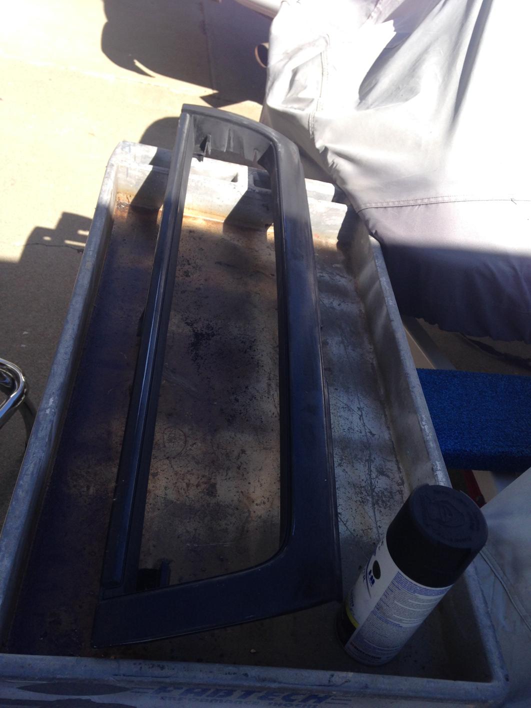

Second was sanding it down for paint. We decided to not fill the gaps because as we bent the wire over they would not show.
Third painted with mesh fitted over we applied epoxy instead of screws too make it easier.

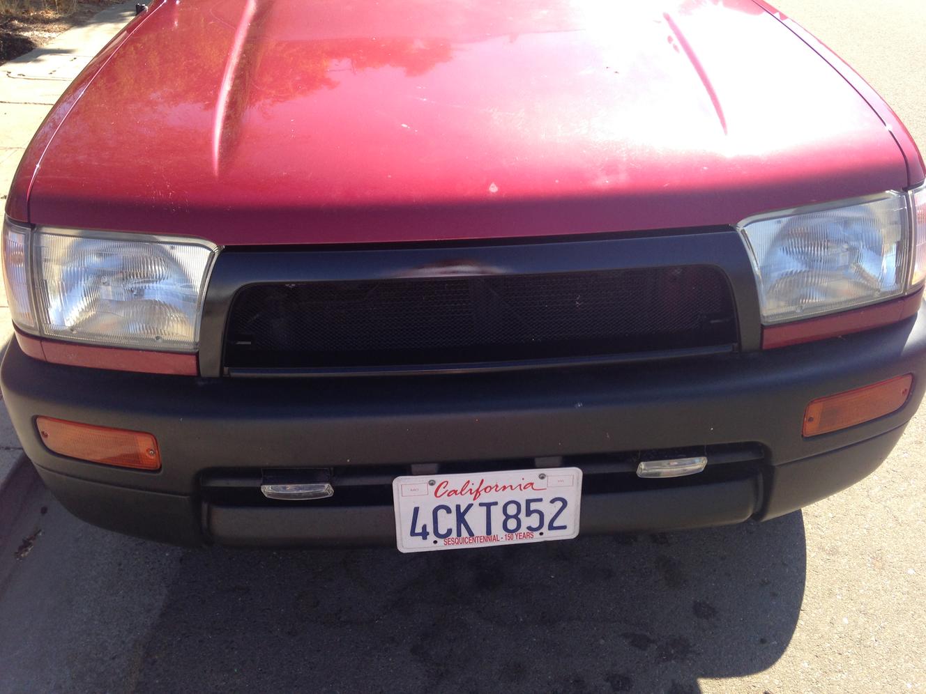

Fourth Finished product I love!!
