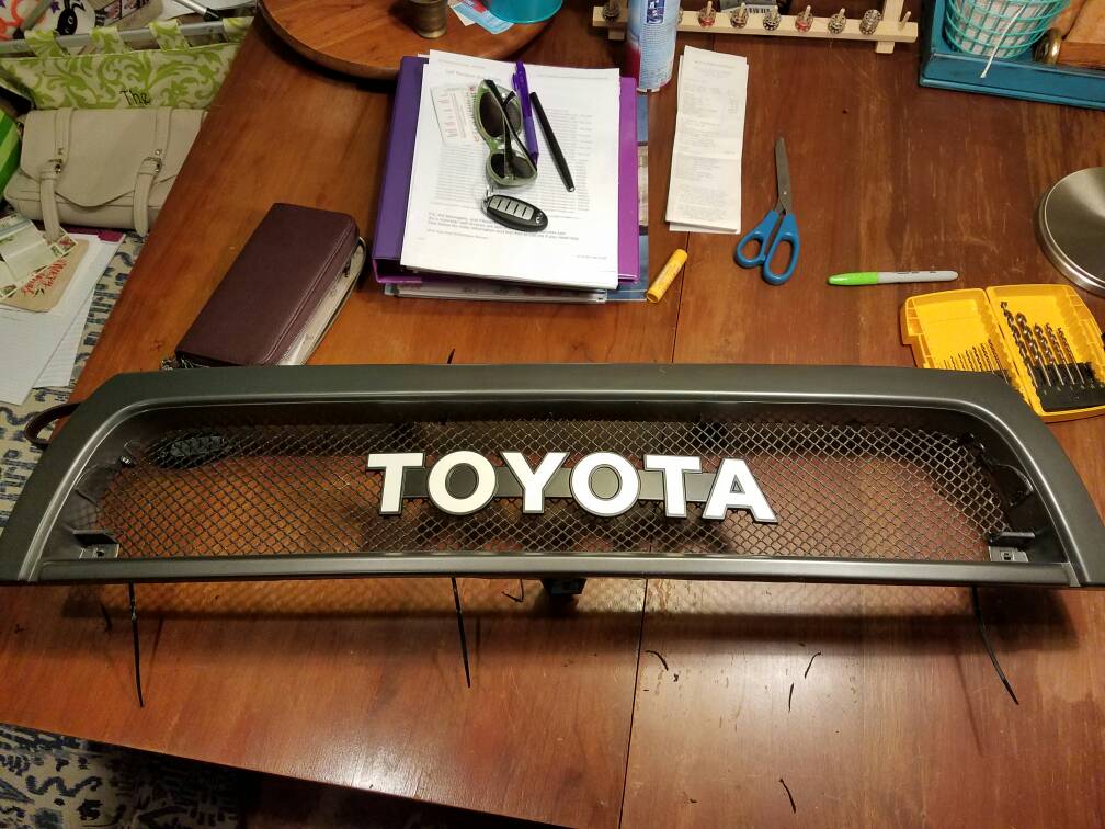

Here's a rough draft. Still need to sand and paint so the mesh and emblem aren't permanently on, I wanted to see how it was going to look. That grille worked out nicely
Looks good!! I am still working on mine. I see you went with the non-chrome. Like Mstudt said, the chrome version is a lot more work...ask me how I know.lol I like the way the all plastic looks. Think I will make one of those too.

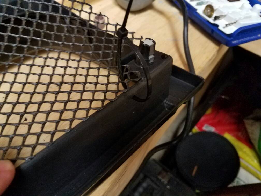

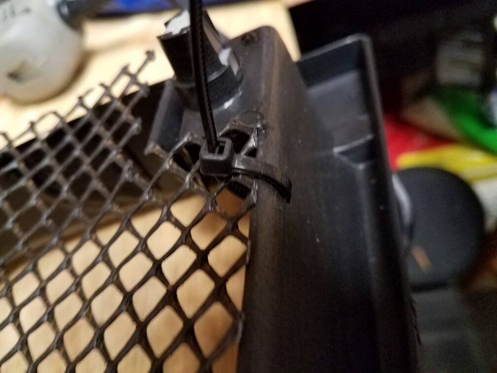

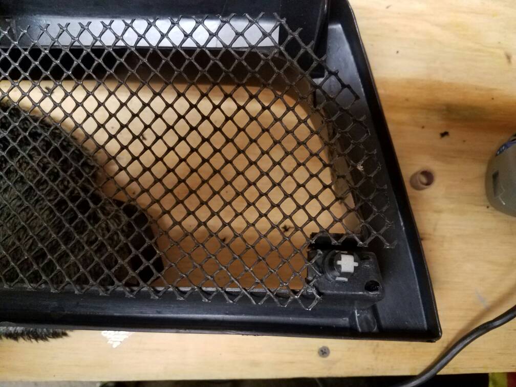

Looks good!! Would you mind posting a picture of how you attached the mesh to the back?

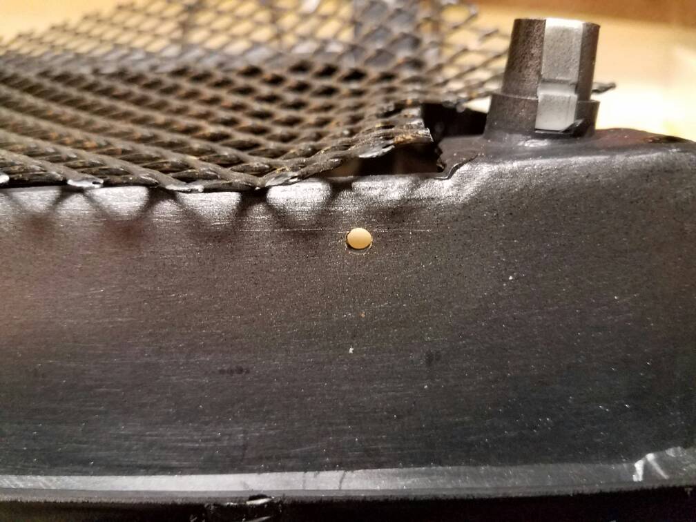

So I drilled small holes around the edge on the back side. If you're looking straight on this hole is on the bottom of the grille
The mesh is cut just slightly larger than the opening in the back
I ran zip ties through the hole and through the mess. I drilled the holes as I went in order to keep the mesh as tight as possible.
I still haven't figured out how I'm going to secure the Toyota emblem. Once I figure that out I'll post again.

Great! thank you so much for posting! Did you just buy the gutter mesh from home depot?
Yes. Comes in a roll of way more than you need but it's like $5. I had tried it for actual gutter guards so I had some left over. Great for the grille...terrible as a gutter guard haha
