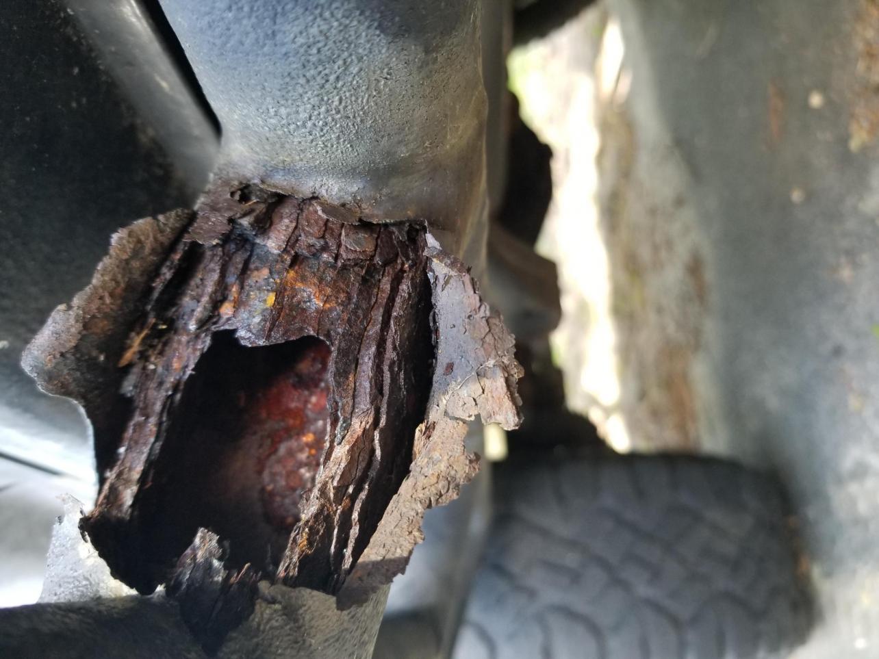

I'll have to search out my invoice. My Rails dues to improper prepping are rusting..i had a friend ask me what gauge steel was used. So that's the question.
Thanks again.

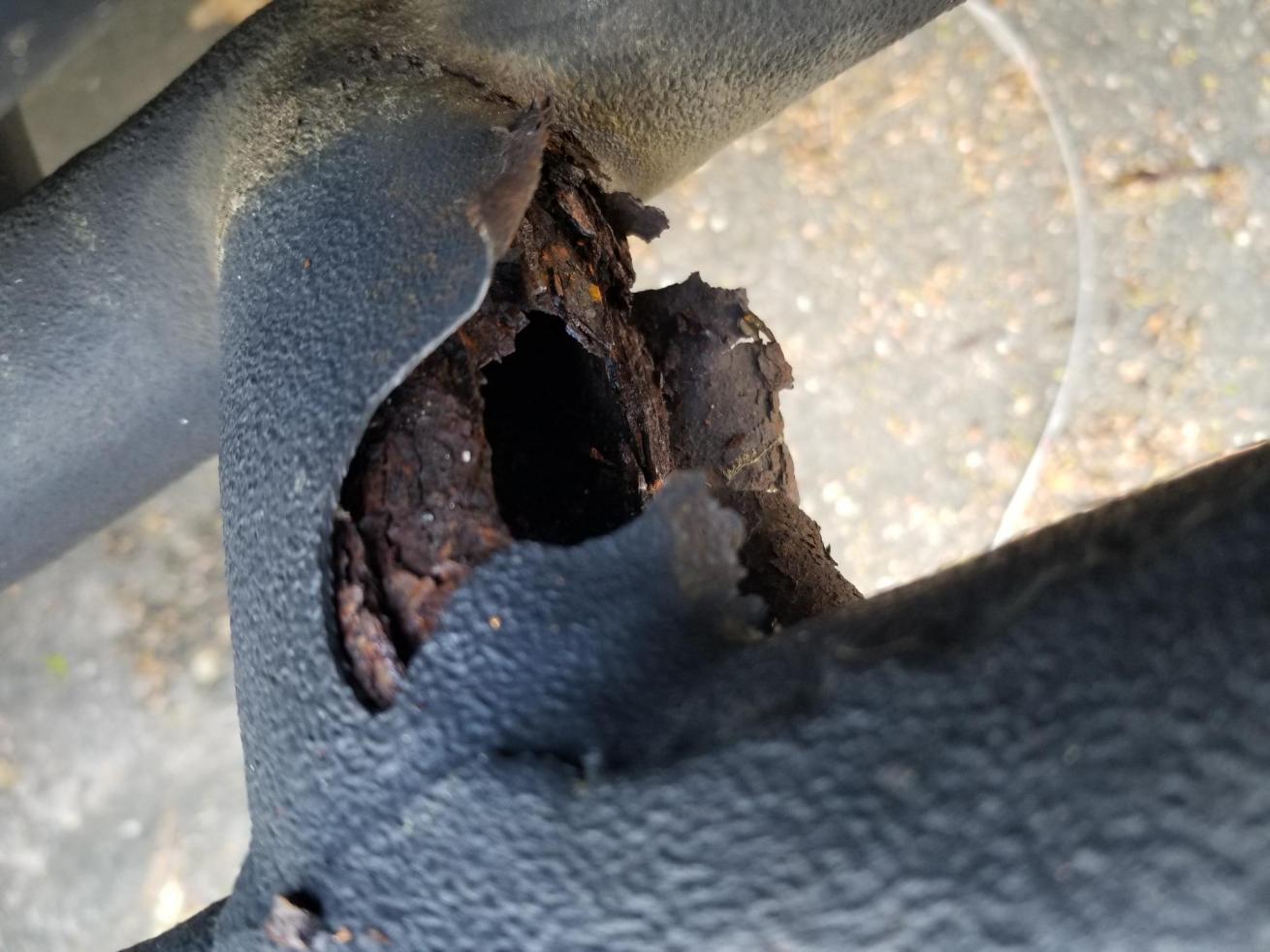

Another issue.... prob not due to the Bars... but just prep
you get the idea.... Remove from the vehicle and then fix? or fix while on the truck?
oof! That looks pretty rotten...
Most tubing is typically .120" wall DOM or ERW
You may be able to replace on the vehicle, but weld access can be tough,
and the notched tubing might fight you a bit since you usually need to rock it into place.
