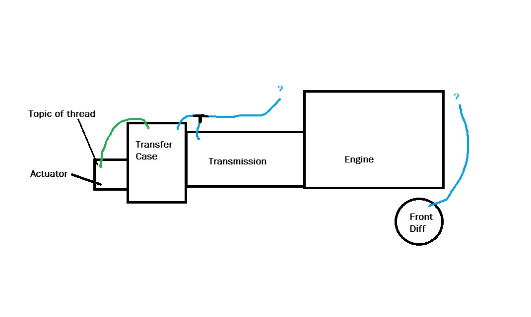

Okay, I'll take pics later today and post them. But here is a quick block diagram of what i'm talking about.
The green line is the breather that i'm refering to as the topic of this thread.
The blue lines are the ones we were discussing and i'm still not 100% sure where they end up. I have a breather near my battery/ fuse box on my truck that I assume attaches to the front diff. Maybe if someone can clear this up i'll edit the diagram.

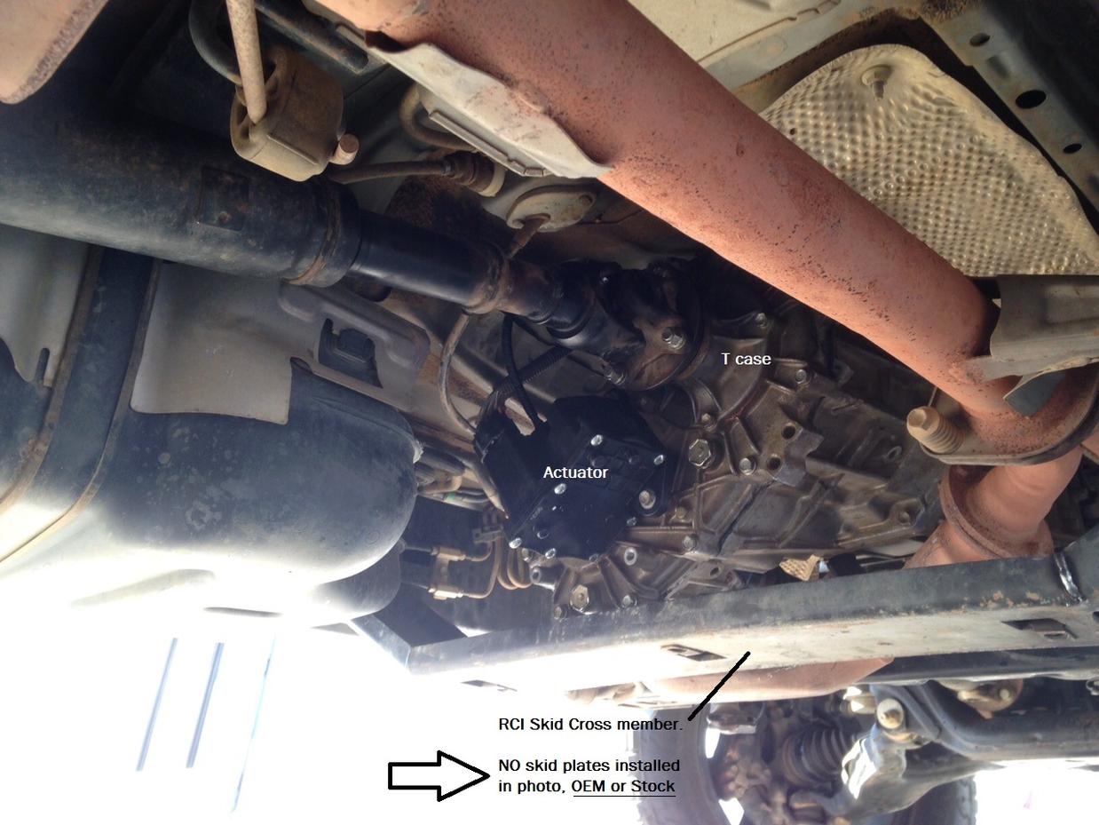

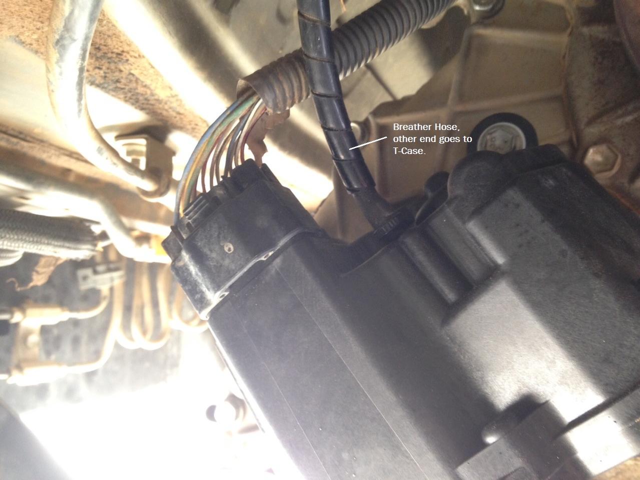

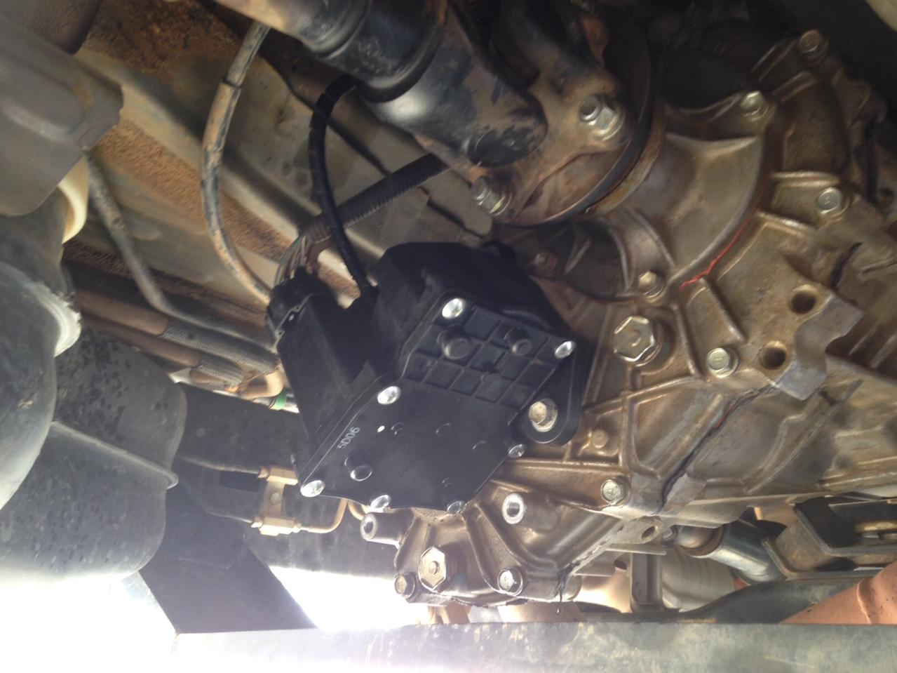

Okay here are the pics.
Please note! I don't have any skid plates on in these photos. So what you view will look like may vary. But behind any OEM or AM skid plates, this is what you'll see. These photos were taken from the Passenger side of the truck.
