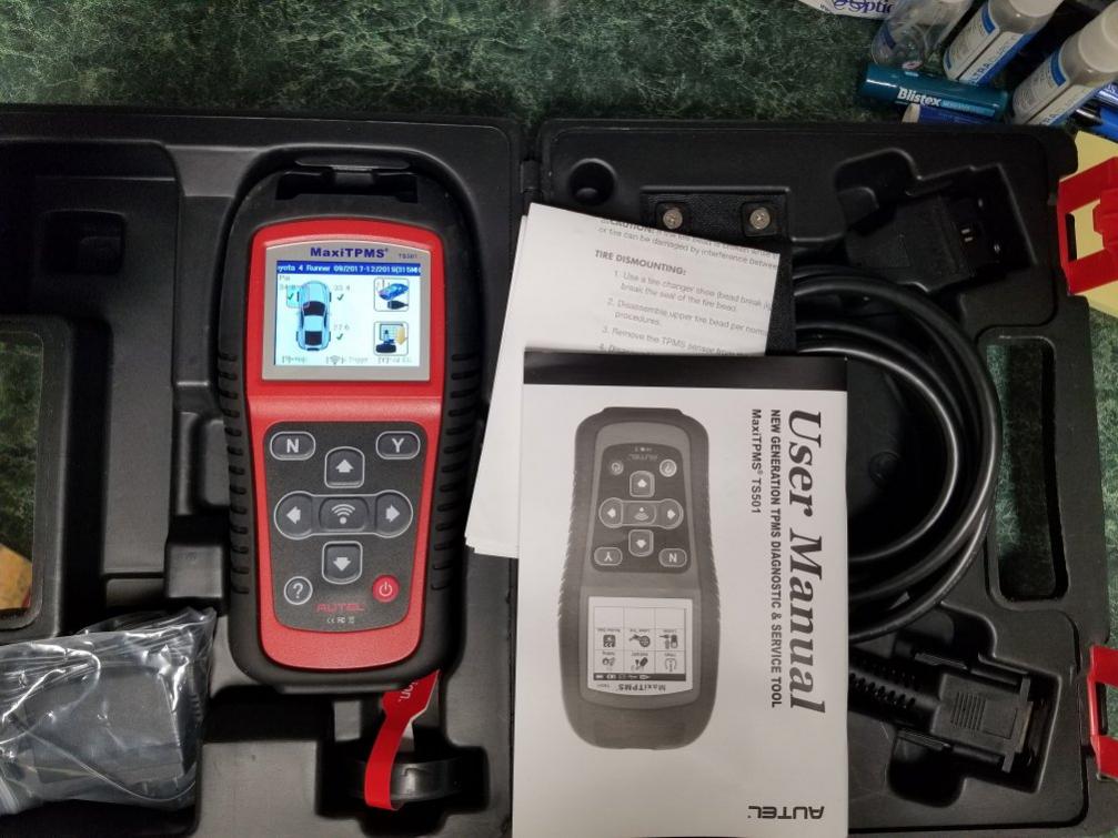

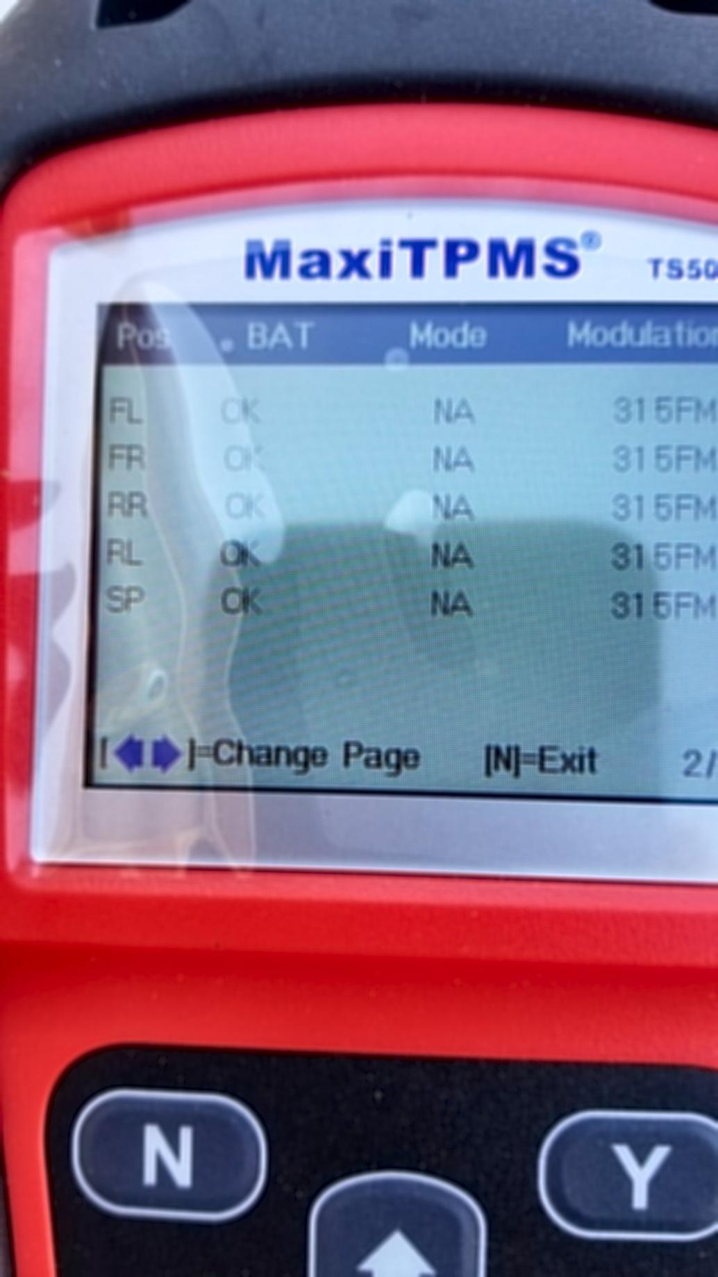

I use the Autel MaxiTPMS TS501 and Denso sensors. Got both off Amazon

thanks, i bought this and it works like a charm on my factory sensors.
the unit gave me the option for a 5 wheel setup but i just stuck to programming the 4 wheels/sensors being used.

Will this read the OEM sensors as well? My TPMS light is on and I think one or more sensors have bad battery .
On their Amazon page they say it only reads/programs Autel sensors.

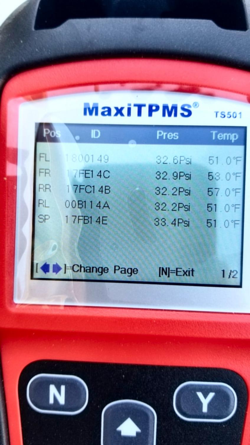

My Autel (see my post, above) read the OEM 2004 Denso sensors and it reads all 5 of the new ones I got on Amazon. You just use the menu to select your model and year. If you have a problem call their support number. They were very helpful. Last year my 2004 sensors were 1 dead, 2 good and 2 weak.

So to confirm, your Autel can read your OEM sensor ID's and write them to the vehicles ECU with the included cable? Nothing else required?

It reads the 5 Denso sensors wirelessly but you use the cable to write them to the ECU. I had trouble reading them, choosing my vehicle from the list. I contacted them by phone (best bet) and they weren't able to help me. They said they would open a ticket with the support team in China. i got an email the next morning that told me to try a newer year and that worked perfectly. Mine is a 2004 and I used 09/2017 - 12/2019
It writes all 5, I don't think you can just pick one to write but it's a simple process. Start at front left and read that sensor then read the others clockwise. It tells you which one to read next. Connect the cable to the unit and the car's OBD port and follow the instructions to write them.

Perfect. Thank you.
