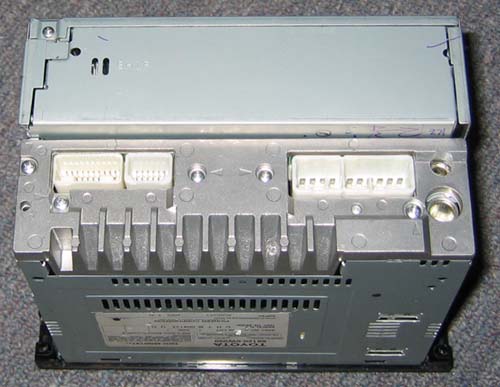

I have read about taping up the extra antenna wire. However, I was curious so I started looking at the back end of the unit. I found that the SCION head unit DOES HAVE A SECOND ANTENNA SOCKET for the smaller antenna wire! However, it is covered up.
I removed the thick metal heat sink, and one half of the sheet metal cover. The smaller jack is right next to the main antenna jack. (Remove the screws with the little arrows next to them.) I measured the location of the second jack and drilled holes in the sheet metal, and the thick cast aluminum heat sink. Reassembled, and installed.
I can attest that the reception is better than my original 4R unit.
WARNING - Do not drill holes with out removing the parts being drilled. You DO NOT want little metal chips in your Head Unit!

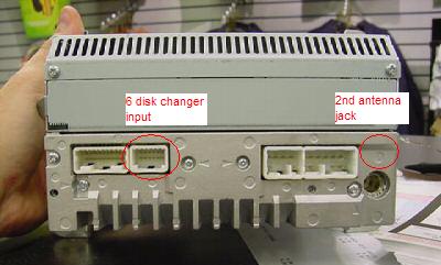

Sorry bud, I don't have time to take my dash apart again... :(
I did however find a pic online, I circled the jack that my 6 disc changer plugged into, as well as the location of where you will need to drill the hole.
Hope that helps.
oops!
Oops, Here's the pic.

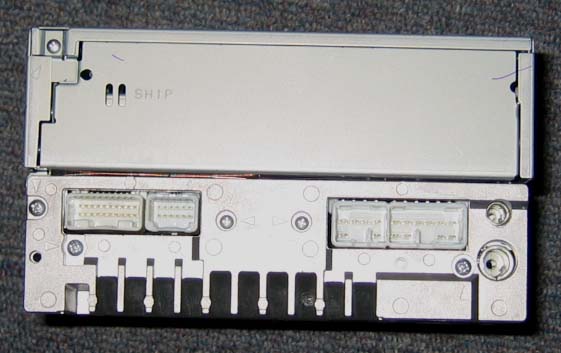

Well, the 6 cd unit was broke and the seller wouldn't take it back. I tried to work with PayPal but they weren't any help. I called my credit card and did a chargeback and I bought a single disc unit from ebay for $92 shipped. It came today and I installed it in about 15 mins. Really easy.
I just cut the metal covering the 2nd antenna plug and swapped the rear heatsink with the one on the 6 cd HU so I wouldn't have to drill another hole.
Everything works great! I burned a mp3 cd with some folders and it's better than having a cd changer.
2k34r - I used a drill bit (3/8"?) and then used a dremel to open it a bit more for an exact fit. The metal is very soft and it took a short time to drill the hole. Took another 5 mins with a dremel to get it to the size I needed. Definitely take the parts off before you start drilling/cutting.
