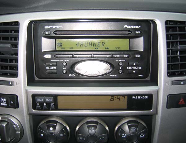

Here's HU installed.

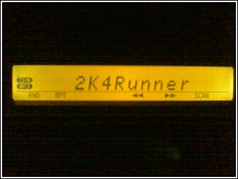

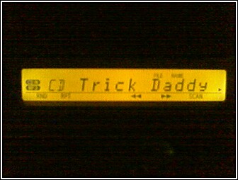

Got my Scion HU...
Thursday.
I love this radio, 100x's better then the OEM factory crap.
I don't understand why Toyota would put such a better radio in a less expensive car.
