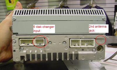

After installing the Scion HU the FM reception has suffered.
Stations that previously were clear are now fuzzy at times.
I drilled the hole for the 2nd antenna lead, both are connected.
Cd's are fine......
Any suggestions ?? For FM reception??
Thanks
Do you remember if you reconnected the antenna amplifier power wire back up? It would be the single wire connector that is square in shape and not rectangular like all of the others. It also had some foam on it to stop it from rattling about.
Every plug on the back of our radios, be it the Scion or the Toyota, has a corresponding port. No plug fits into any other connector. No 2 are the same size or have the same pin pattern.
So the is no way to mess this up, really. It's like those block games we had when we were 2 years old, the the square block only fits into the square hole, and the circle only fits into the circle hole.
If you have a lose plug behind your radio, you missed something. And there is no other port that it will fit into, so just plug it in.
Hope this helps.
Here is a picture of the back complements of whitney8
I don't think I left anything unplugged.
Every wire that came off was plugged into the new HU.
I may take another look, as it's probably easier the 2nd time.
The reception isn't horrible, just not as good as the original.
Thanks
