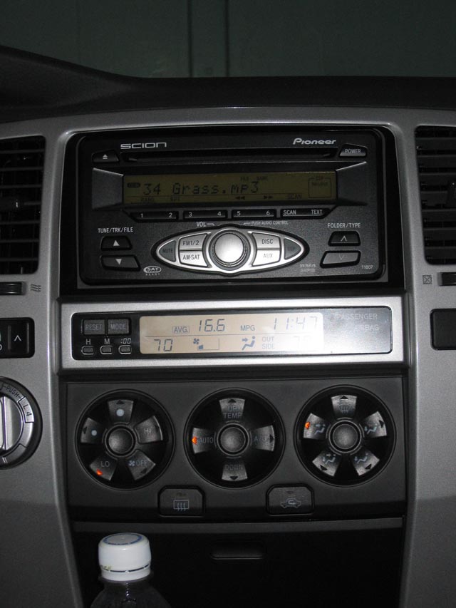

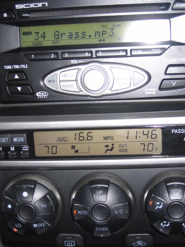

I just installed an 06' Scion HU model #1807 (out of an 06' tc), in my 04' Sport. Only mod required was drilling a 3/8" hole in the sheetmetal for the 2nd antenna. The aluminium heat sink does not need drilling on this model. No problems, one hour install time, huge sound improvement. If any of you were considering this mod, but had reservations like me, don't worry, it will not disappoint. I found my HU on scionlife.com for $100.00 shipped. Best $100.00 mod I ever made.
Just installed the 06 Scion HU. Looks good, sounds good, and now i can play mp3s off cd or my ipod... Life is too sweet.
