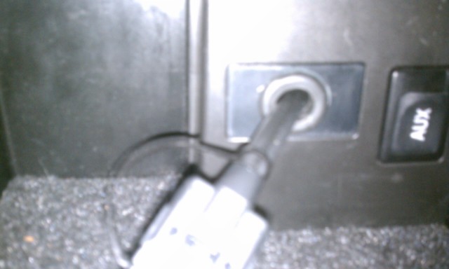

Id love to have a clean-cut finished product like this one:
Ive even though about ordering a "center console socket cover" but i cant find the part number.
Im also wondering how this person with the pic above was able to fish the cord thru without it looking mauled from the wide ends.
Yeah, i hear you on the easy accessability and all, but my wife will be using her Iphone...so she wants it in "its spot" :confused: which to her is the ashtray area.
The other end of the cable is a male USB and 3.5 mm connection, so it can be fed through a smaller hole. The hole I cut is awful because I didn't have a bit larger than 1/2". A 3/4" or 1" diameter drilled hole should work out well. You could then finish it off with a smaller inside diameter rubber grommet. Or just drill in an inconspicuous location so you'll never see it anyway!
