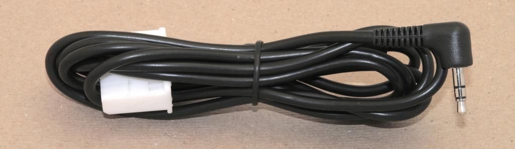

Good news, I found a guy who builds a cable for exactly what I want. He says that you can not only use the aux port with his cable but you can also splice into 3 wires to retain steering wheel control.
Here's his contact if anyone else has an android or other non iphone device and wants to play music through a scion HU. [email protected].

cable works great albeit something strange happens with my galaxy SIII when I plug it in. If I don't first connect my phone to my power cable from cigarette 12v, and connect it, any slight movements will cause distortion and will actually change songs or even queue up the galaxies equivalent to siri! It can even turn the screen on and off. Very weird. Doesn't happen to anyone elses phone I know though.
I think the cable cost like 8-10$ after shipping iirc. The aux cable has a connector that is pretty generic Toyota and plugs into the back of my scion replacement radio. Anything on the 06+ is a different story, they have a totally different system but I imagine the connector could be similar if not the same You would need to ask the guy in the email I provided above. Or search if the Scion aux connector is the same as on the 06+ stock radios.
My stock radio did not have a connector port for aux, hence why I got the SCion replacement.
Hope that helps.
