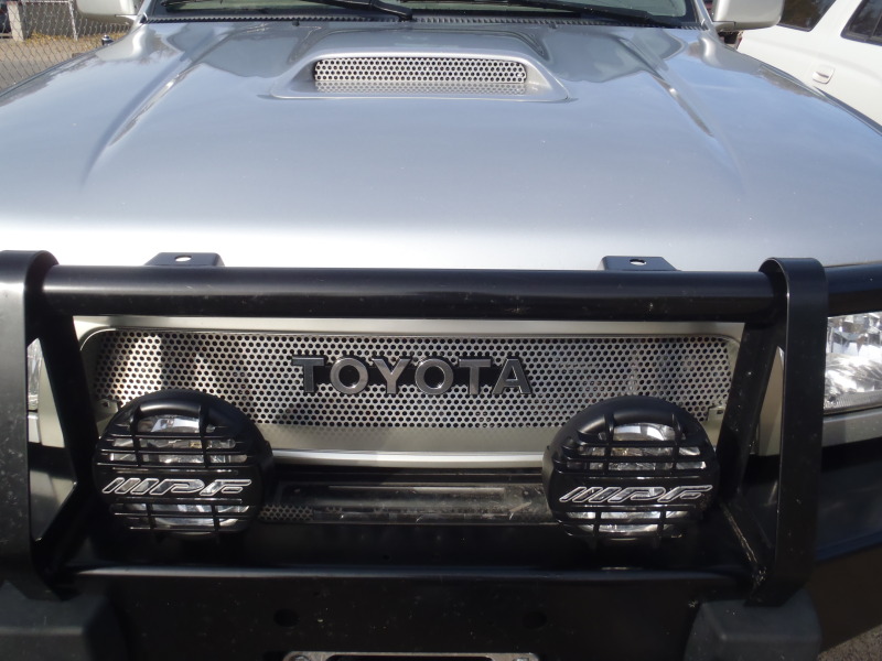

I also picked up a LC emblem & Master clutch cylinder from Camelback Toyota. I plan on making a custom grill someday but not a Satoshi. I'm not a fan of the "big black hole look" in the front of my truck. I think they look better with a Silver mesh like [MENTION=44220]BigFishAllDay[/MENTION] did.
IMG_0870 by Mike Campbell, on Flickr
IMG_0871 by Mike Campbell, on Flickr
BFAD's Satoshi is the only one I really like. I've always been a fan of Silver.
