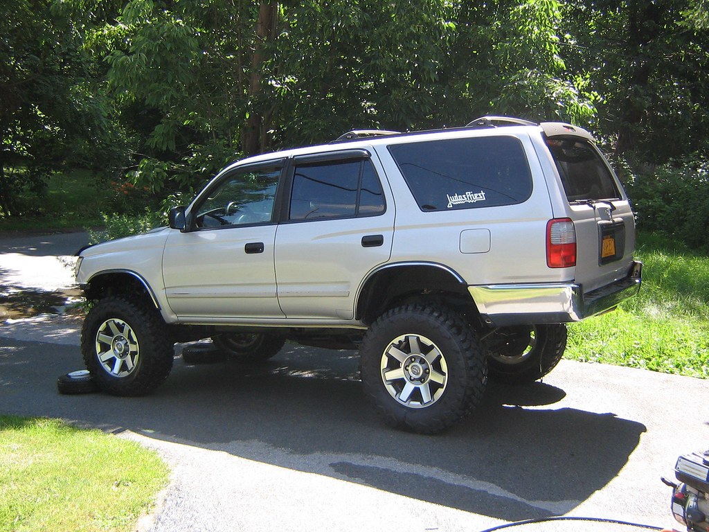

Man, I can't believe I still haven't seen you around the Meadowlands area yet.
I drive my 99 Limited to work almost every day. The 3rz hasn't been any where in a year & a half since the diff leak & rust repairs. Except around the block a few times. I put it away for the winter. I'm painting the bumpers this weekend & getting them back on. I have a wheelin trip on the 28th & need to get her back together & registerd & inspected. I'm under the gun.
Even still, I'd prob notice the Limited! Starting to see a lot more around here. There's a lifted 01-02 with Land Cruiser wheels and an ARB that I always see around.
Ever see the lifted Sequoia? I was talking to him at a red light one day. Looks cool.

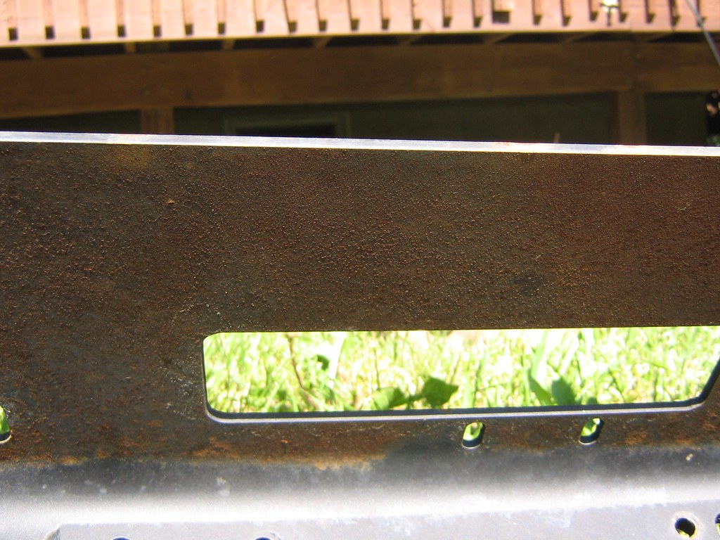

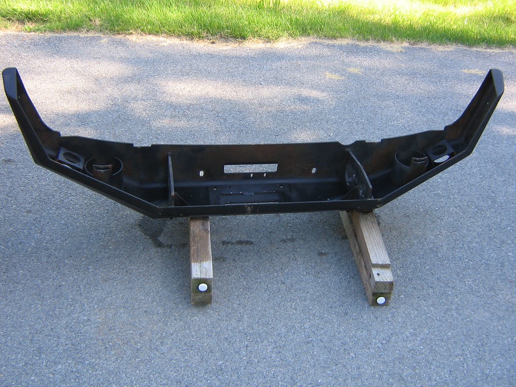

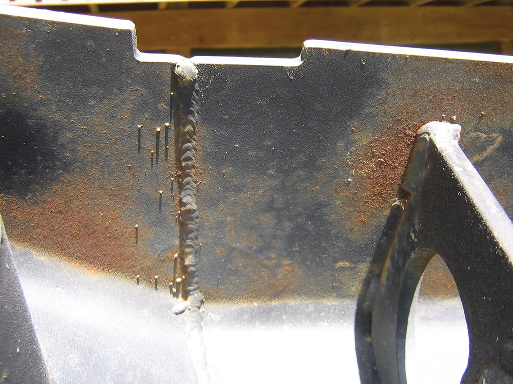

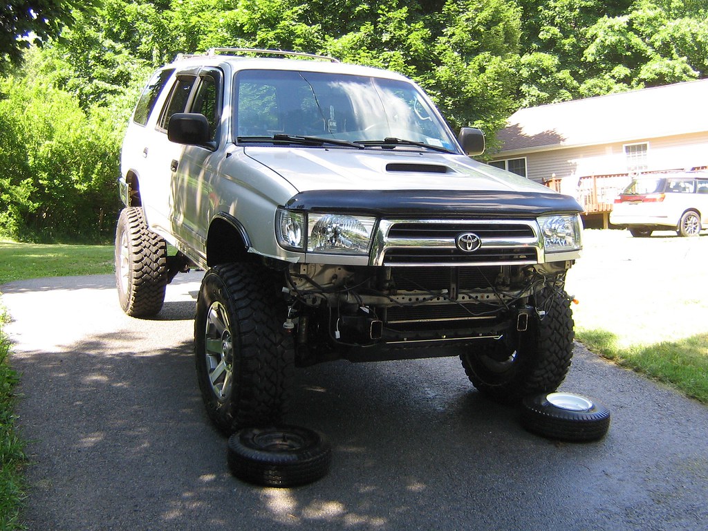

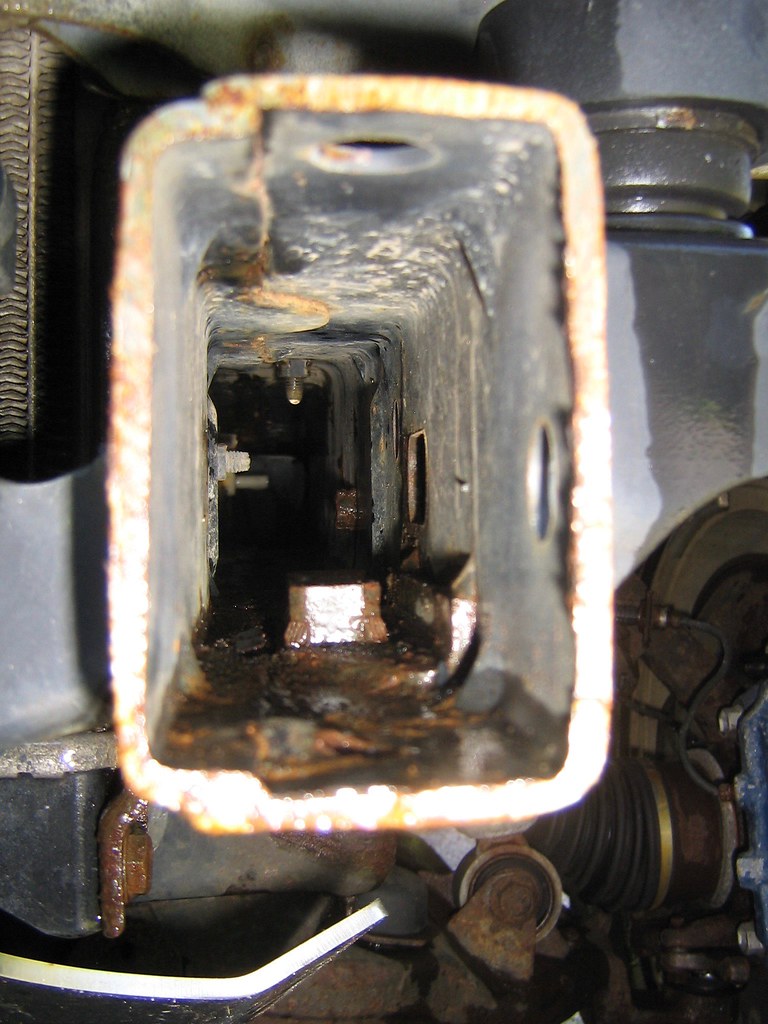

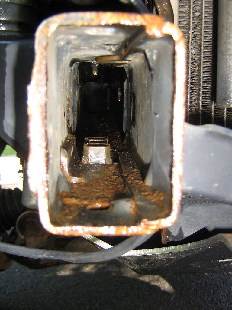

After removing the hitch I pulled off the front bumper so I could pressure wash the frame on the hill & let the dirt & rust out of the front. Then spray with Eastwoods internal frame coating.
This is only 3 NY winters. This bumper has 3 coats of self etching primer, 3 coats of regular primer & 3 coats.
IMG_1939 by Mike Campbell, on Flickr
IMG_1940 by Mike Campbell, on Flickr
IMG_1941 by Mike Campbell, on Flickr
IMG_1942 by Mike Campbell, on Flickr
Hit it with some Purple Power & the pressure washer.

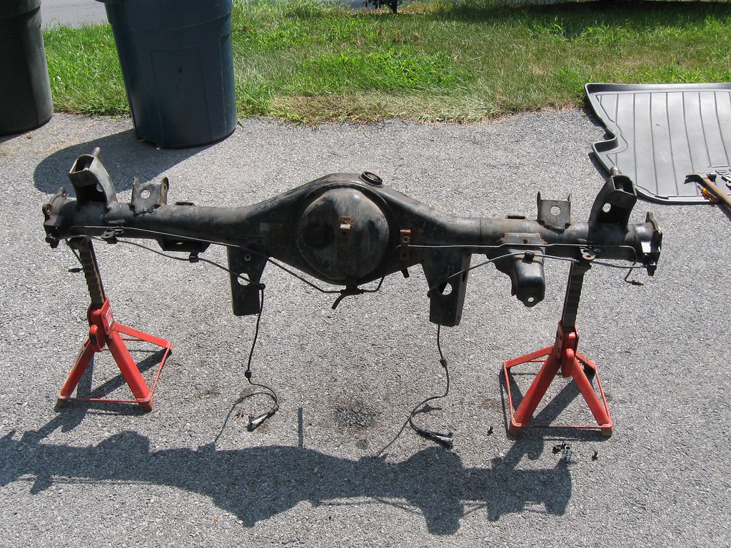

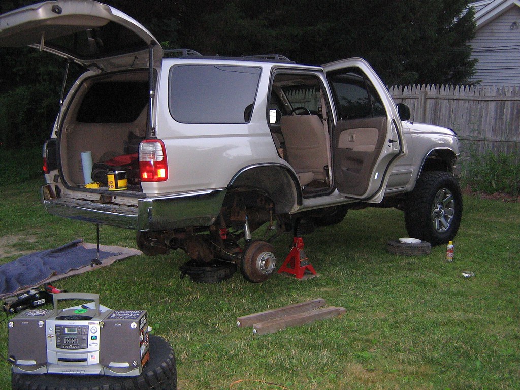

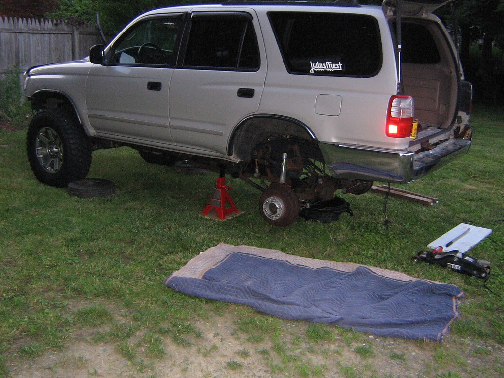

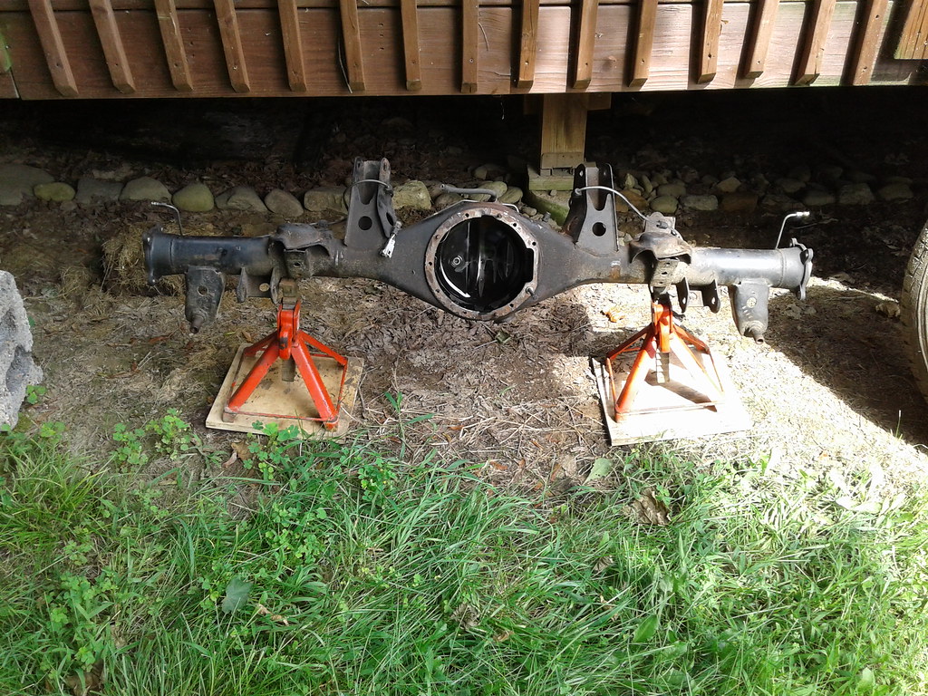

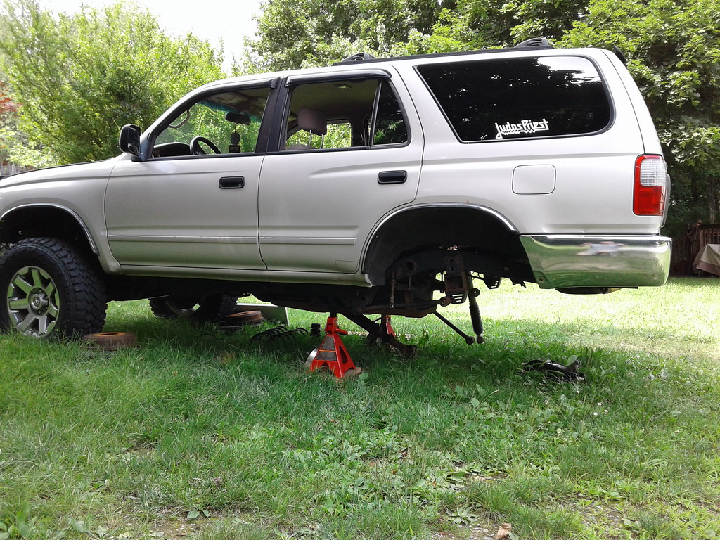

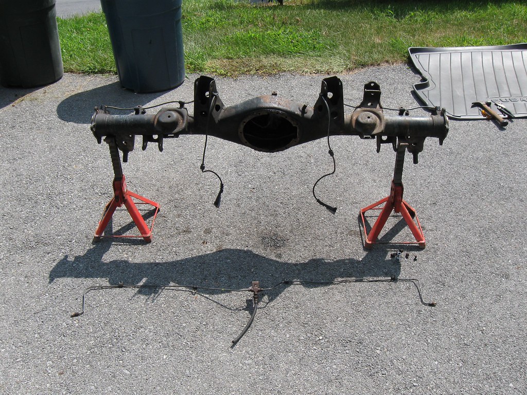

After rinsing out the frame rails I moved her onto the grass & proceeded to disconnect everything to remove the axle housing. You need to disconnect the ABS lines, brake lines, parking brake, shocks, panhard bar, driveshaft and upper & lower control arms.
I put the rear up on 6 ton jack stands set on 1" plywood so they wouldn't sink into the dirt. Chocked the front wheels, put the T/C in 4Lo & the M/T in 1st gear so she wouldn't roll on me. I couldn't use the parking brake & didn't want her moving while I was under there sanding & painting the frame.
IMG_1991 by Mike Campbell, on Flickr
Pulled the wheels off & drained the diff.
IMG_1990 by Mike Campbell, on Flickr

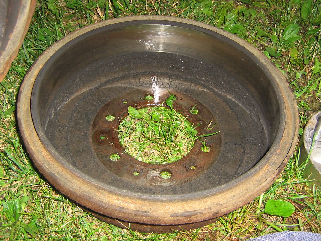

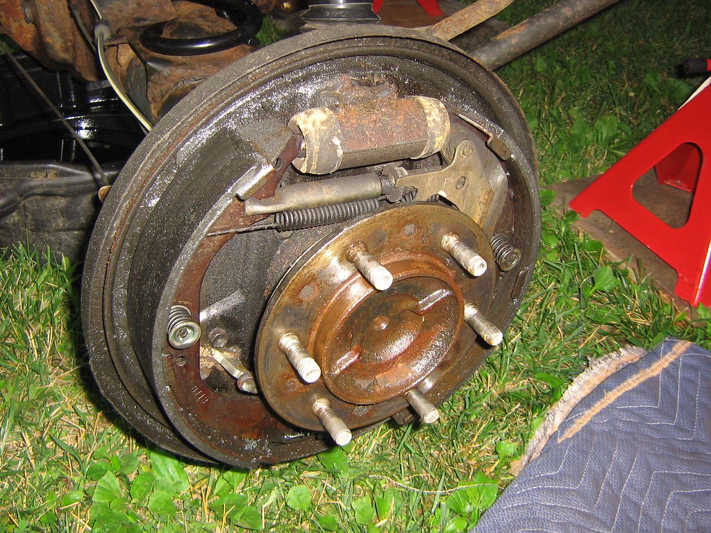

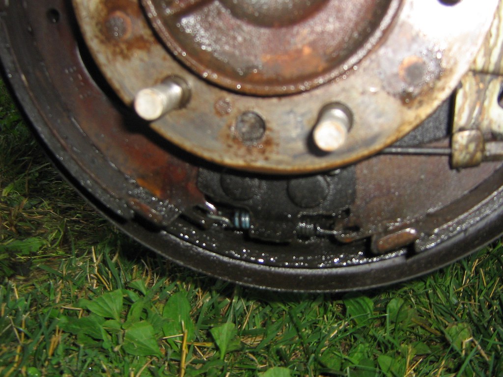

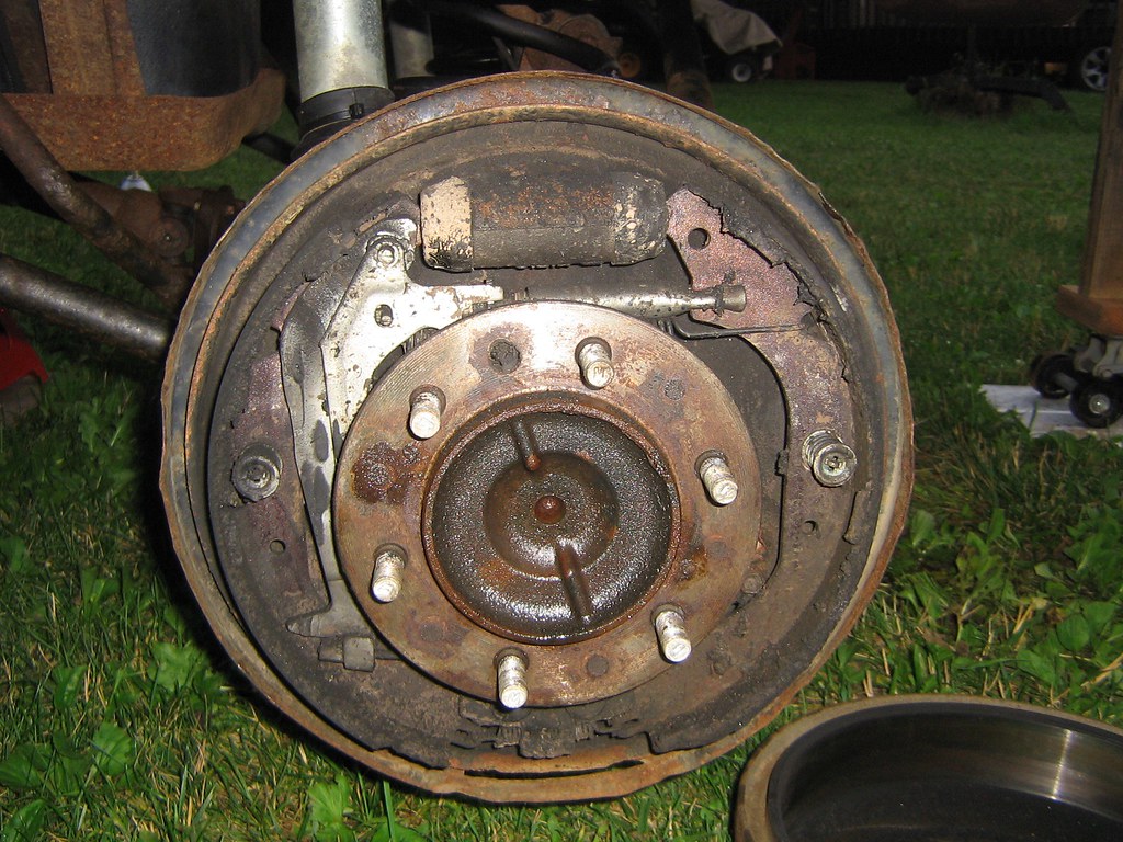

This is the PS rear brake, that gear oil is from a clogged breather. When I did the Ext. breather mod the leak stopped.
IMG_1992 by Mike Campbell, on Flickr
IMG_1993 by Mike Campbell, on Flickr

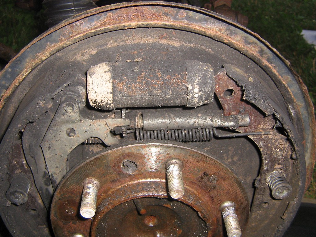

This is what an 18 yo original drum brake with 166k looks like.
IMG_1995 by Mike Campbell, on Flickr
IMG_1996 by Mike Campbell, on Flickr

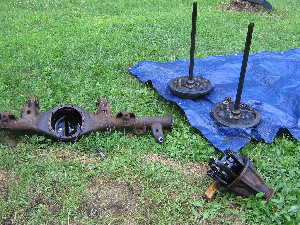

Housing, axles & Diff out.
IMG_2003 by Mike Campbell, on Flickr

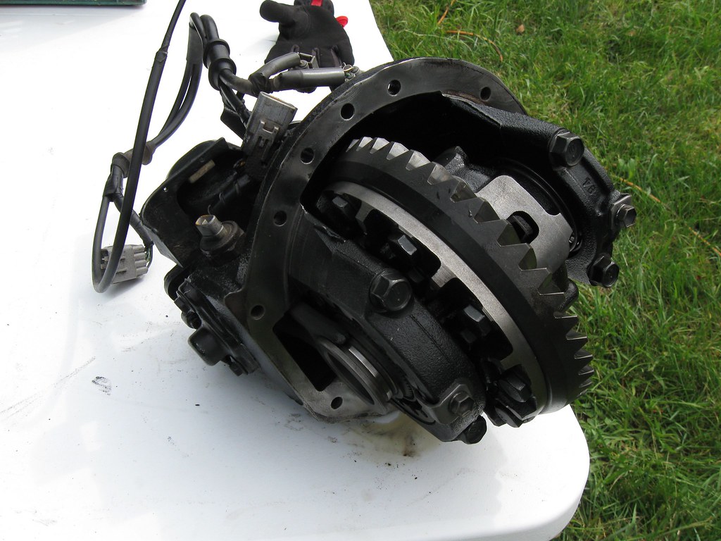

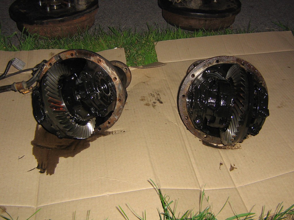

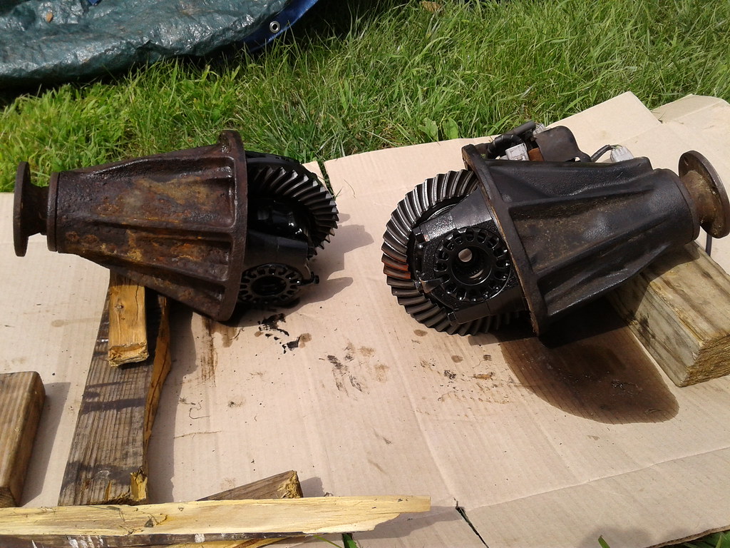

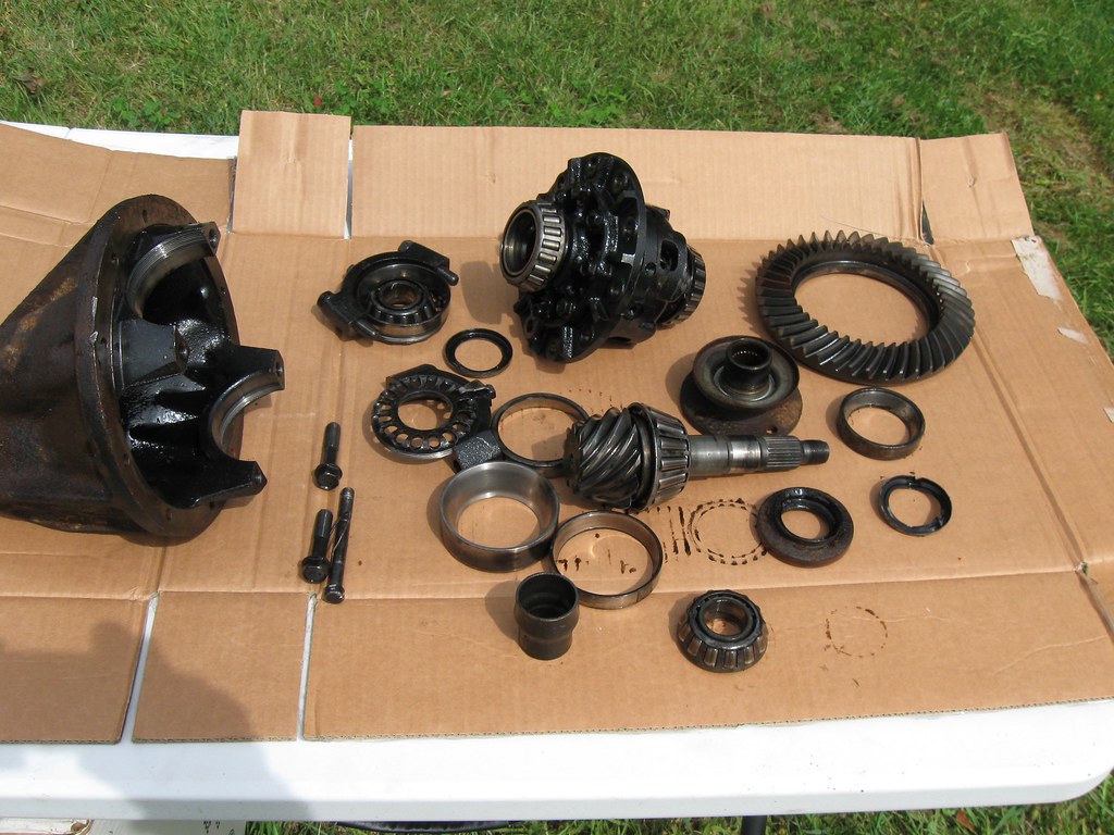

Factory 4.56 teeth are all perfect.
IMG_2004 by Mike Campbell, on Flickr
I pulled the 4.30's out of my new (used) e-locker housing.
20170806_150113 by Mike Campbell, on Flickr

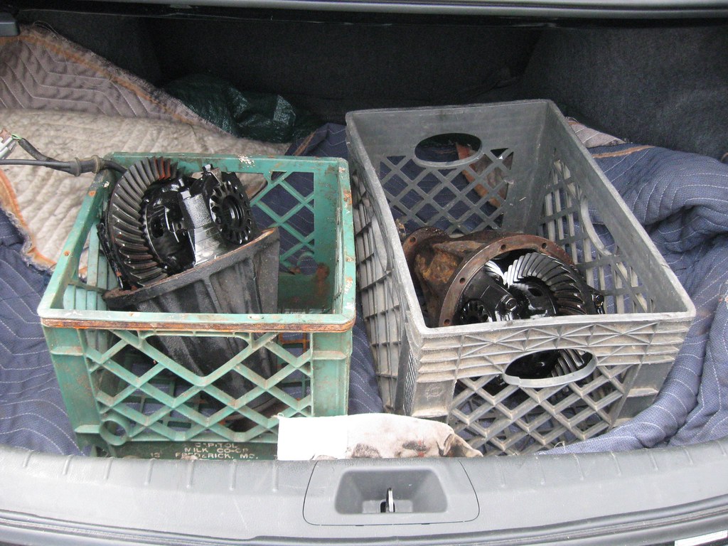

Left these out overnight to drain the oil. I brought these to my local diff shop to swap my 4.56's into the e-locker 3rd.
IMG_2005 by Mike Campbell, on Flickr
4.56 on the left & 4.30 on the right. The teeth on the 4.30 were perfect too.
20170806_150246 by Mike Campbell, on Flickr
I rested the DS on a 4x4 piece of wood so it wouldn't rust in the grass.
20170806_150033 by Mike Campbell, on Flickr
Here's the diffs on their way to the trans/diff shop. Gold Coast Transmissions these guys are the best. http://www.goldsealtrans.com/ These guys have been around forever & have an amazing reputation. Just read the reviews online.

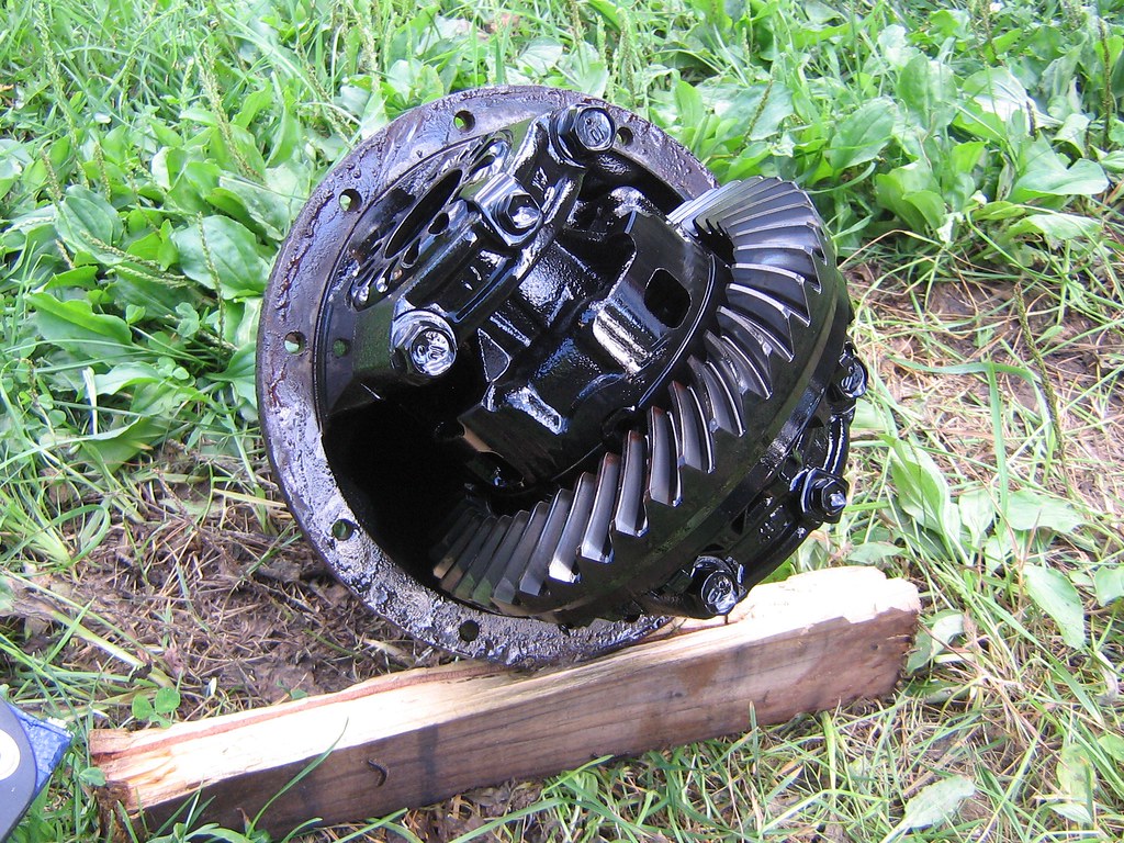

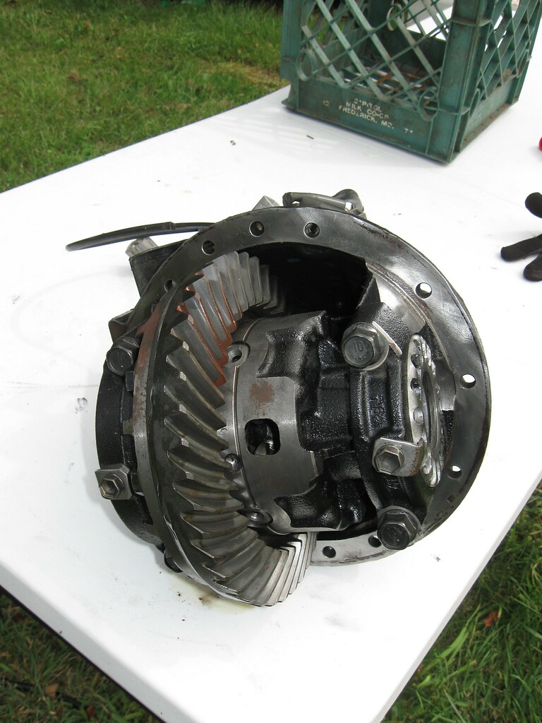

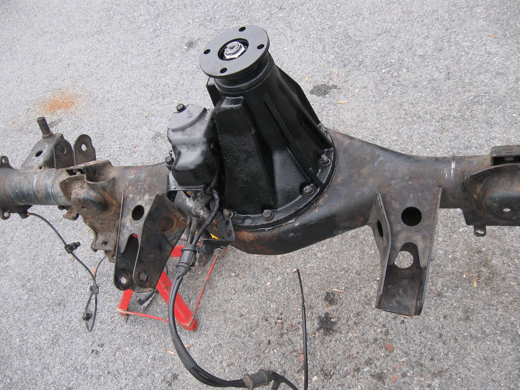

While the gears were being swapped & and a new bearing rebuild kit installed I started to clean up the housing. I couldn't get the ABS sensors out so I left them but pulled off every other bolt & bracket to get ready to sand & paint.
IMG_2523 by Mike Campbell, on Flickr
IMG_2522 by Mike Campbell, on Flickr

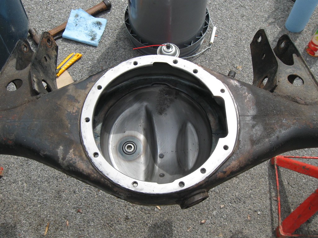

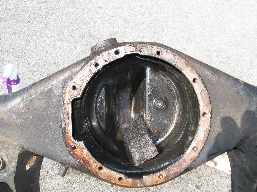

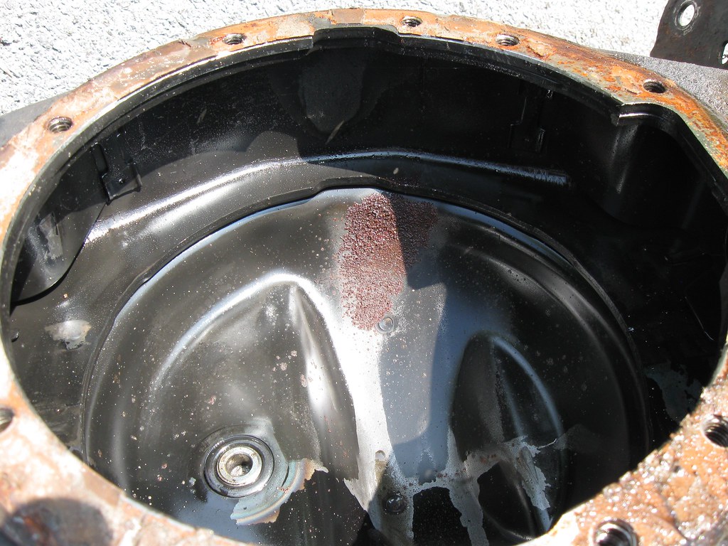

This e-locker housing came out of a 2000 Limited that was sitting for 2 years. Since the truck was originally from Cali before moving to Virginia it didn't have much rust but you can see here that there must have been some moisture in the housing.
IMG_2524 by Mike Campbell, on Flickr
I sprayed some WD 40 on it scrubbed it with a synthetic brillo pad. I didn't want to use anything metal.
IMG_2525 by Mike Campbell, on Flickr
The inside cleaned up nicely with brake cleaner & a couple of blue shop towels. I also scraped off the old gasket. Sounds easy right? It was a pain. Maybe if the diff mating surface was perfectly flat a razor knife or scraper would have made it easy but it's not. At one point I pulled out my new chisel set & scraped very carefully. I'm pretty sure this diff was never off before! LOL I also used brake cleaner, sand paper & steel wool going from coarse to fine to make it pretty & smooth. We dont want any leaks! I actually put a few gouges in it when I was prying the carrier off but I smoothed them down & made sure there was plenty of Permatex gasket maker on there when I put it back together.
IMG_2532 by Mike Campbell, on Flickr

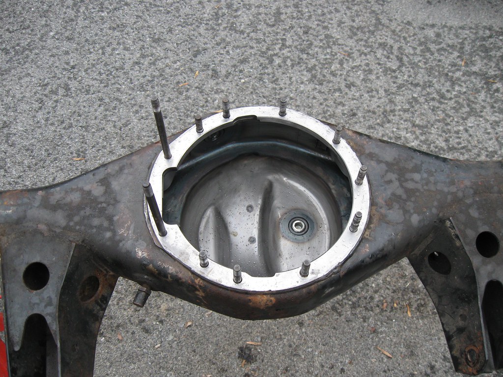

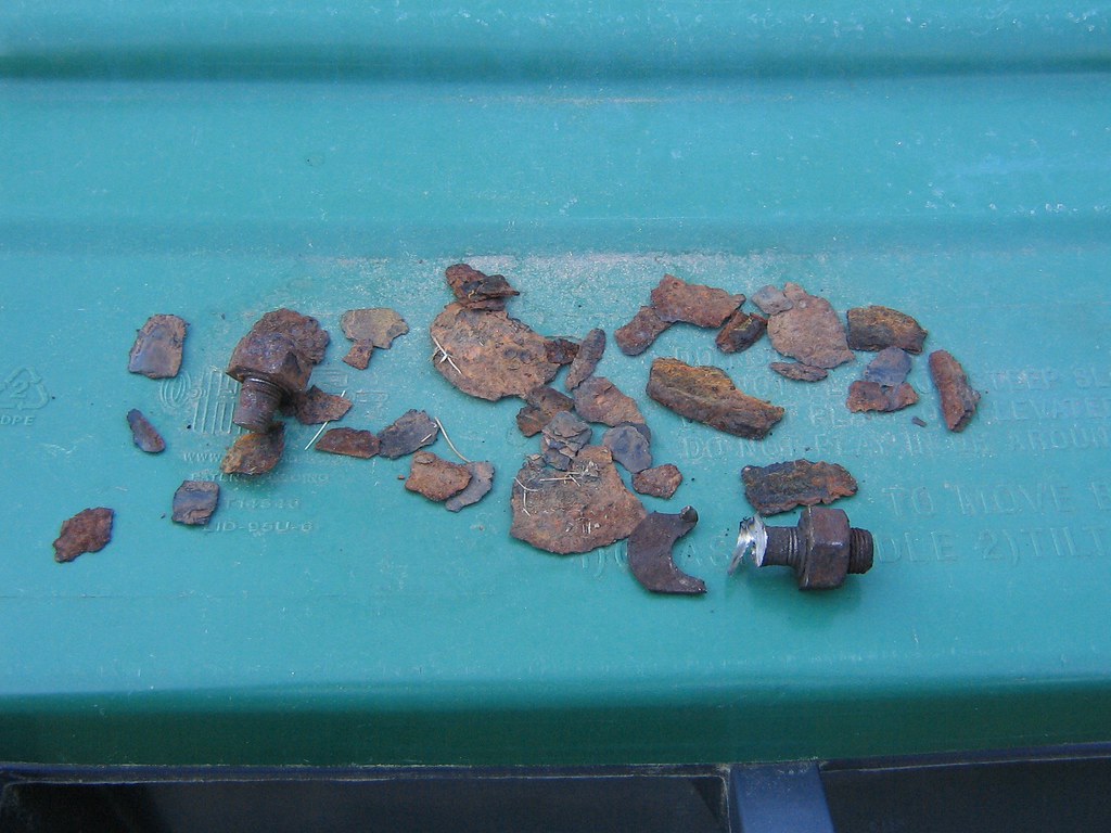

I broke a few studs on both housings removing the diffs but I had enough between the two to make a full set. Extra long ones for E-LOCKER actuator!!!! LOL
IMG_2533 by Mike Campbell, on Flickr

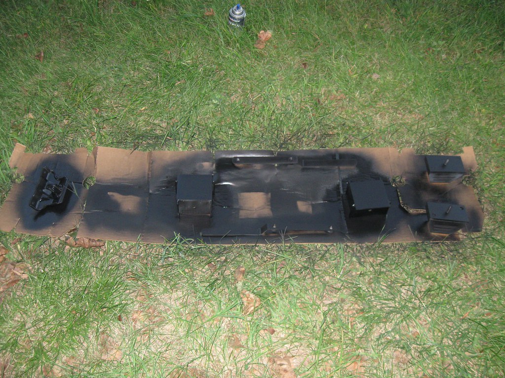

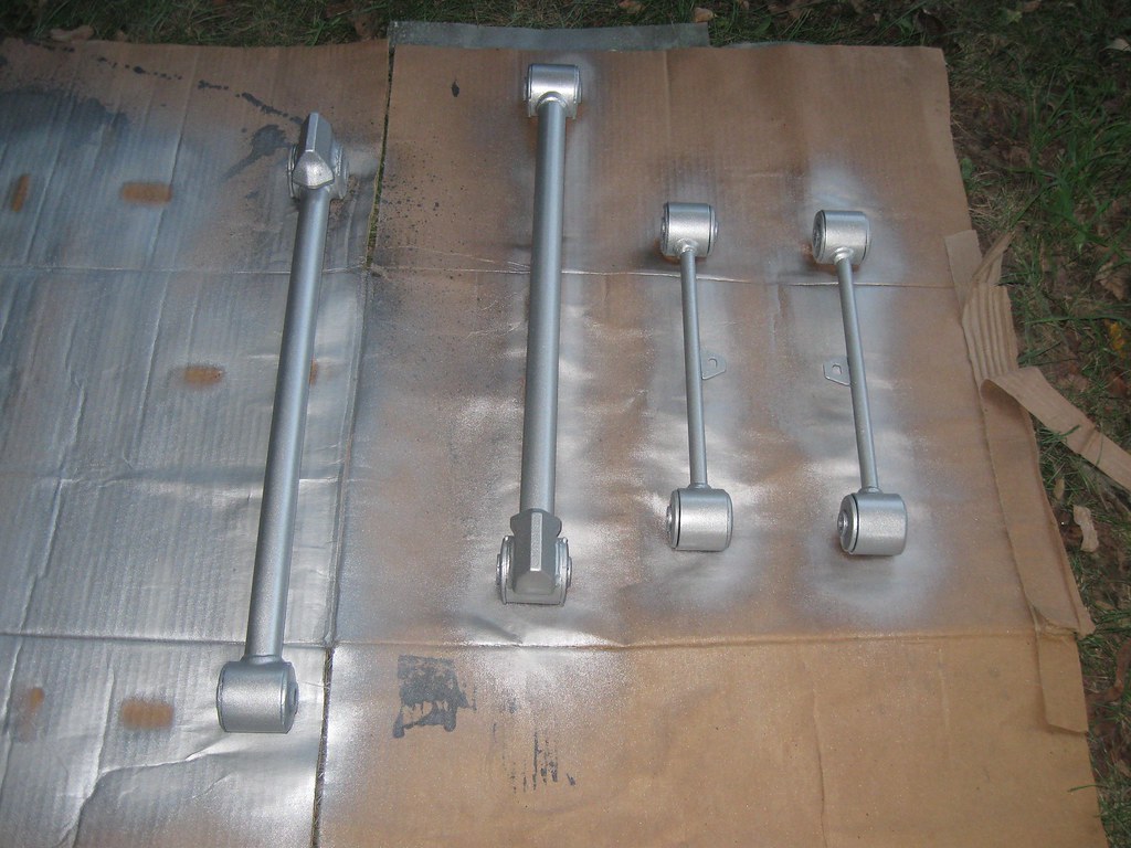

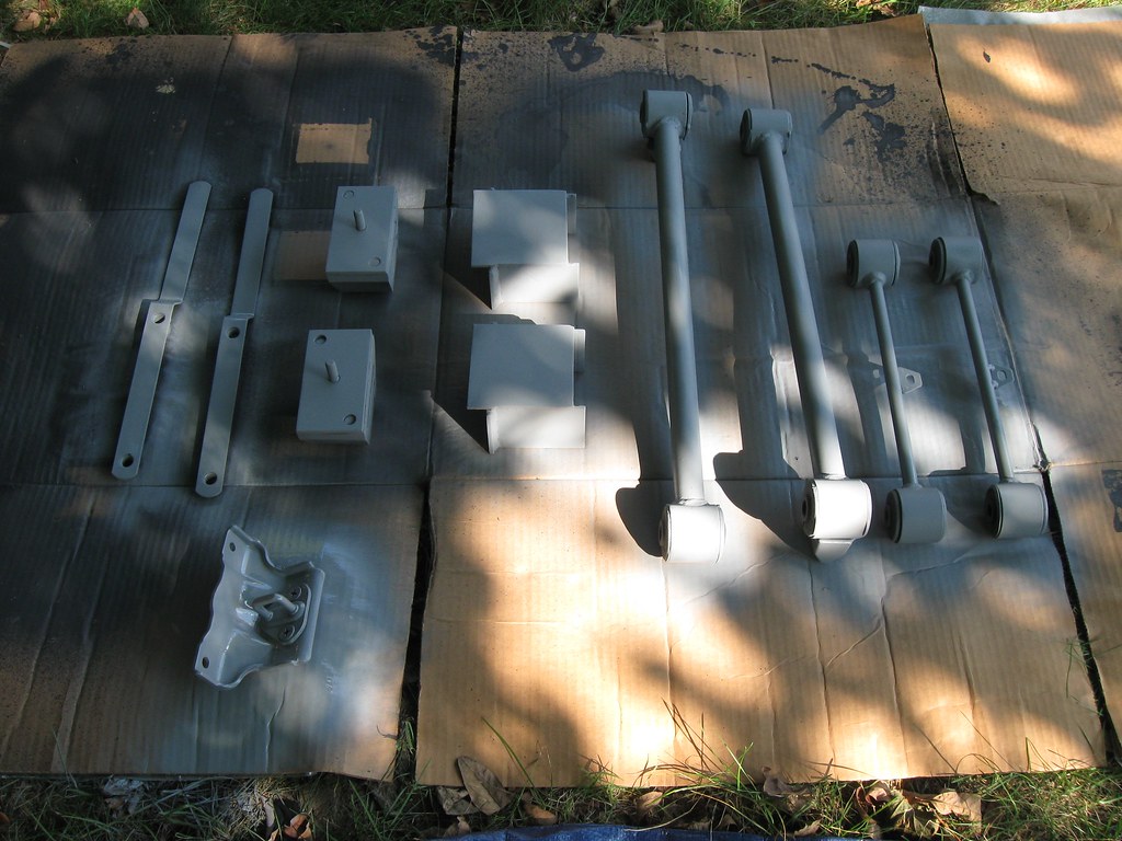

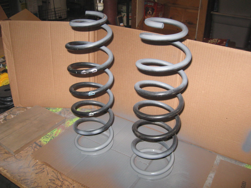

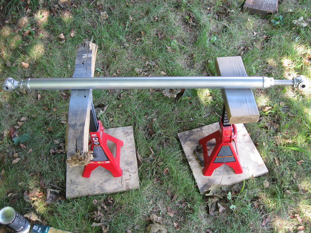

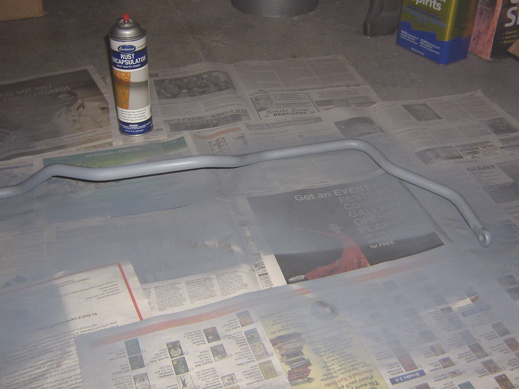

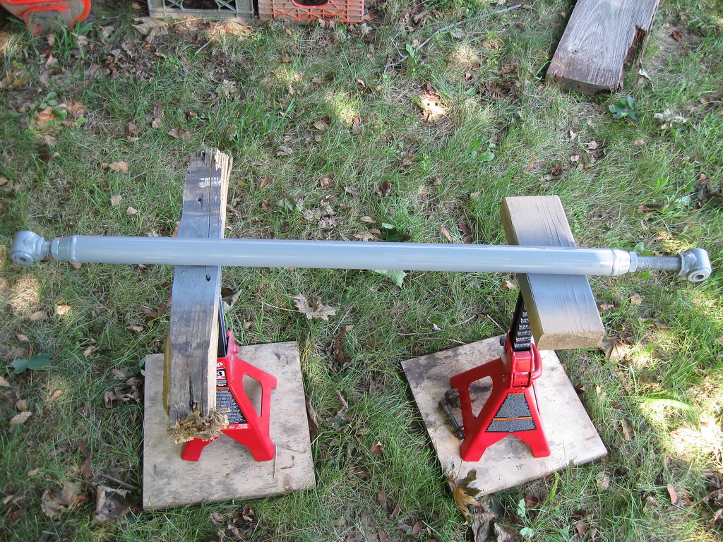

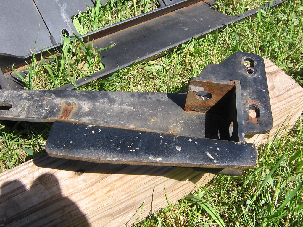

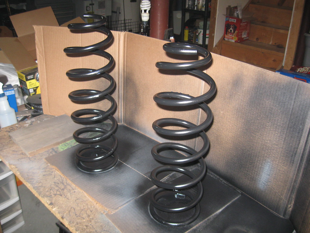

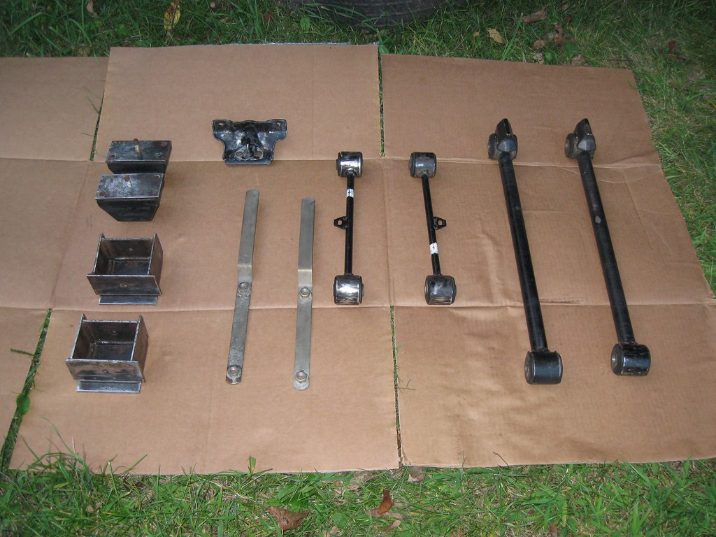

All parts were sanded down & sprayed with 2 coats of Grey Eastwood Rust Encapsulator. The Black parts were sprayed with VHT Roll Bar & Chassis paint. This is my new go to paint, it's an Epoxy & hardens like a rock. You can get good deals on Amazon if you look for 6 packs. The parts that are Silver I used Rustoleum Professional Aluminum that I had laying around.

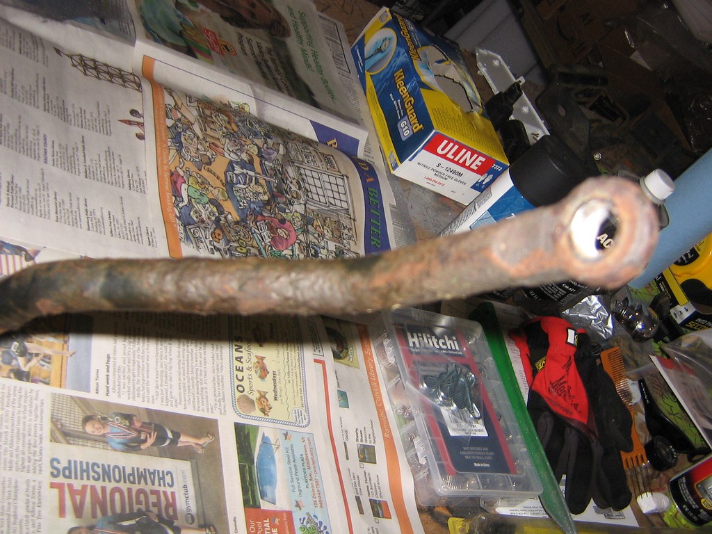

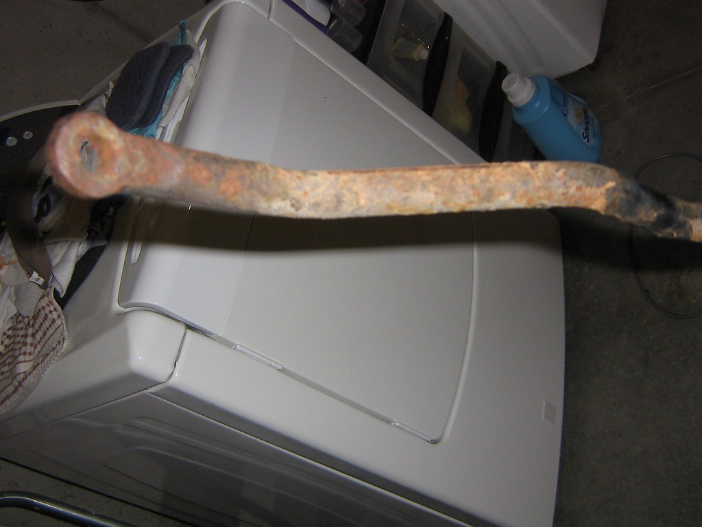

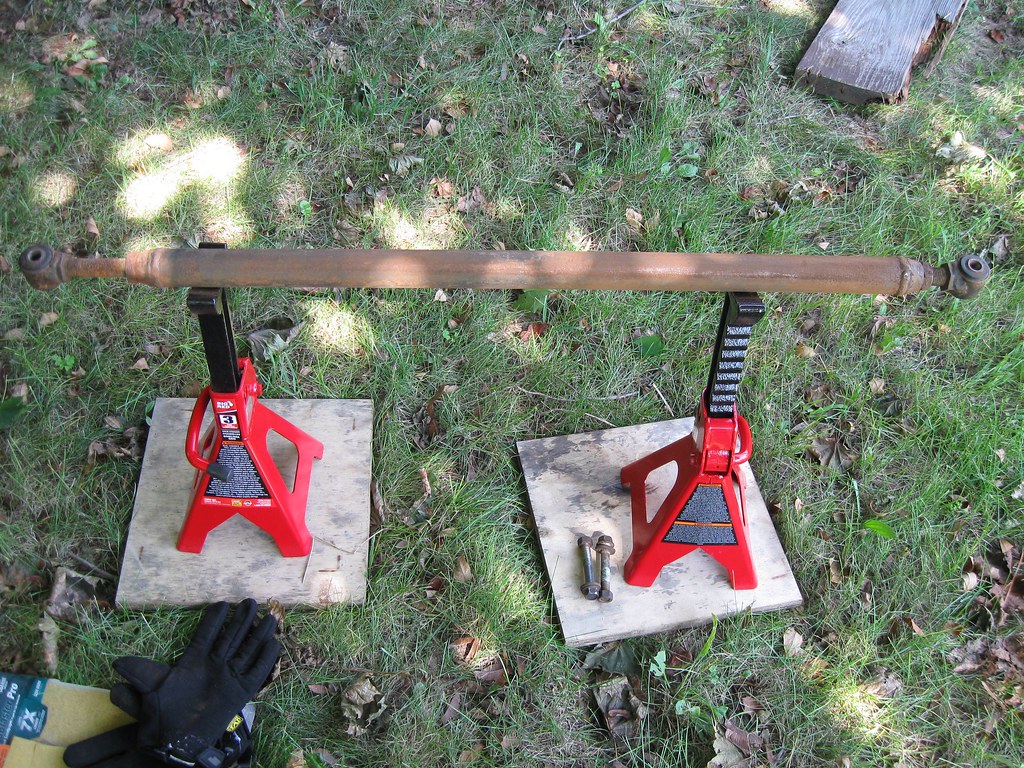

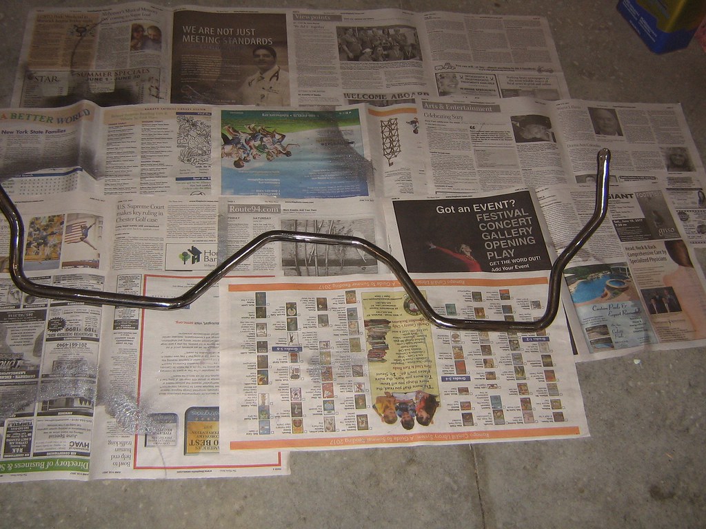

Rear sway bar. I had to use the grinder on this one, 18 NY salty winters.
IMG_1998 by Mike Campbell, on Flickr
IMG_1999 by Mike Campbell, on Flickr
IMG_2000 by Mike Campbell, on Flickr
IMG_2001 by Mike Campbell, on Flickr
IMG_2537 by Mike Campbell, on Flickr
IMG_2539 by Mike Campbell, on Flickr
IMG_2540 by Mike Campbell, on Flickr

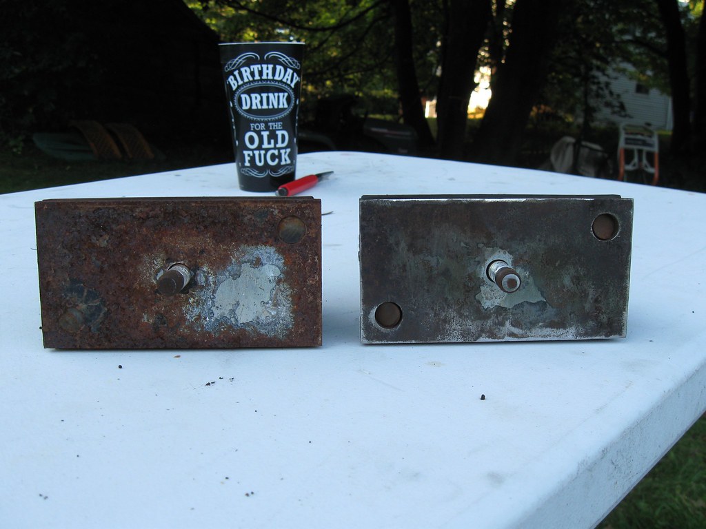

Bump Stop extentions. Like the cup? Yes I was working on my B-Day, Aug 21st. That cup was from my 50th party. :becky:
IMG_2546 by Mike Campbell, on Flickr
IMG_2549 by Mike Campbell, on Flickr
IMG_2566 by Mike Campbell, on Flickr
IMG_2570 by Mike Campbell, on Flickr
IMG_2571 by Mike Campbell, on Flickr

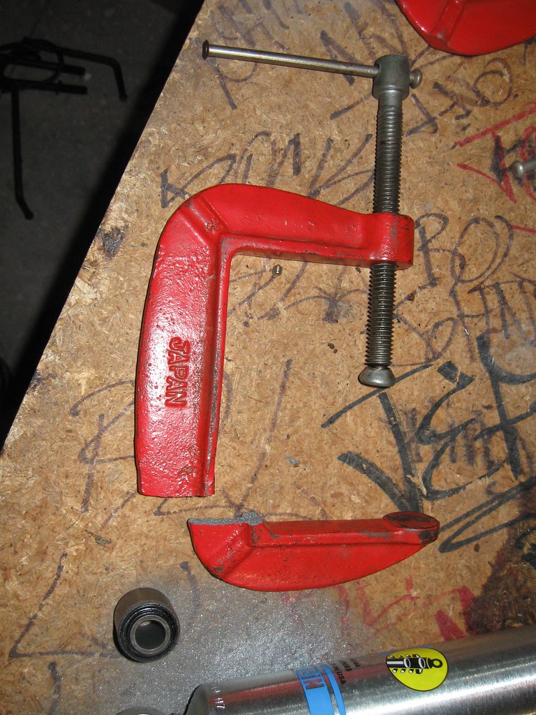

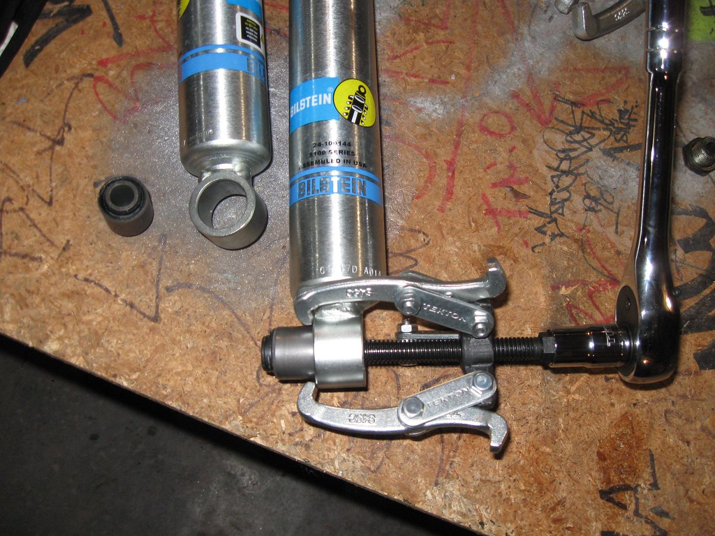

Swapped the bushings on my new Tundra 5100's. That broken c-clamp was my Grandfathers, probably from the 1950's. Luckily I have 2 more. I have all of his old tools, some dating back to the 1920's.
IMG_2573 by Mike Campbell, on Flickr
Modern tools! LOL
IMG_2572 by Mike Campbell, on Flickr

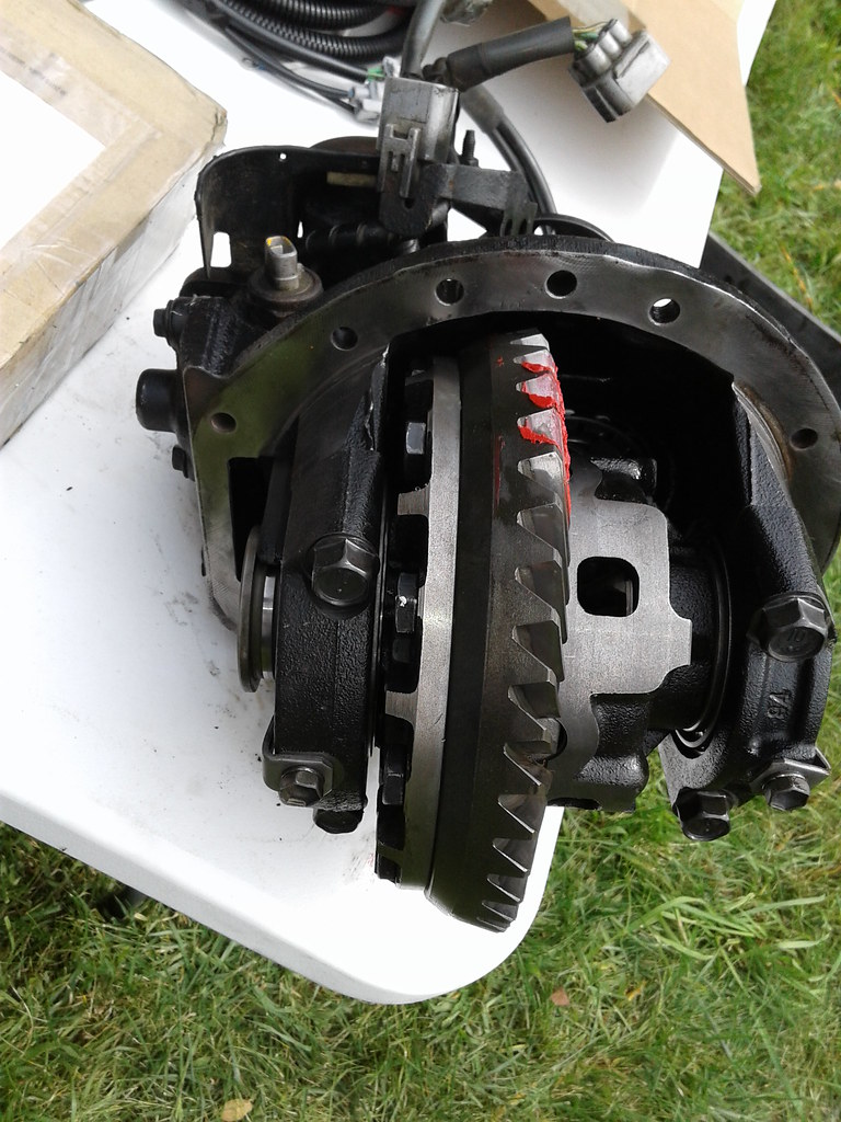

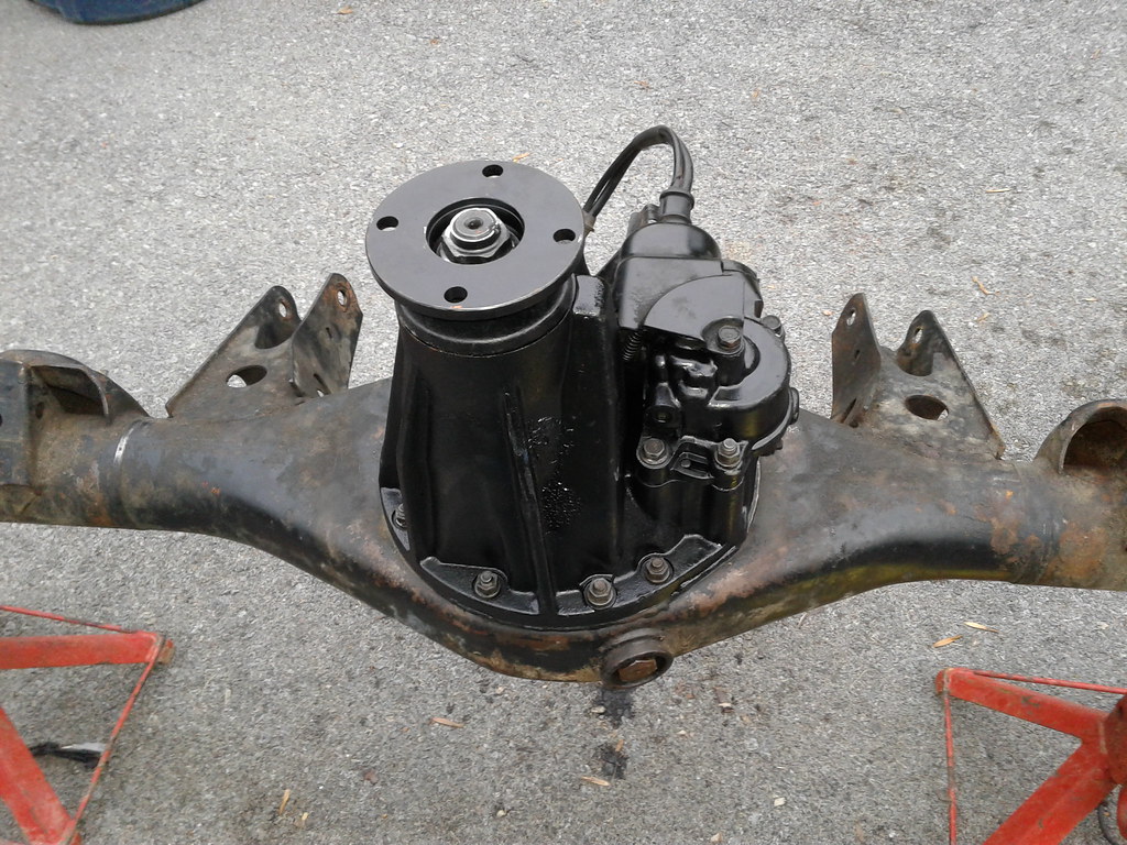

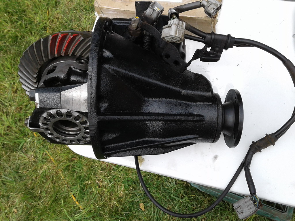

After 2 weeks at the shop my 4.56 E-Locked 3rd member was ready!
I put her on my outdoor work table & gazed at her beauty! :becky:
IMG_2526 by Mike Campbell, on Flickr
IMG_2527 by Mike Campbell, on Flickr
IMG_2528 by Mike Campbell, on Flickr

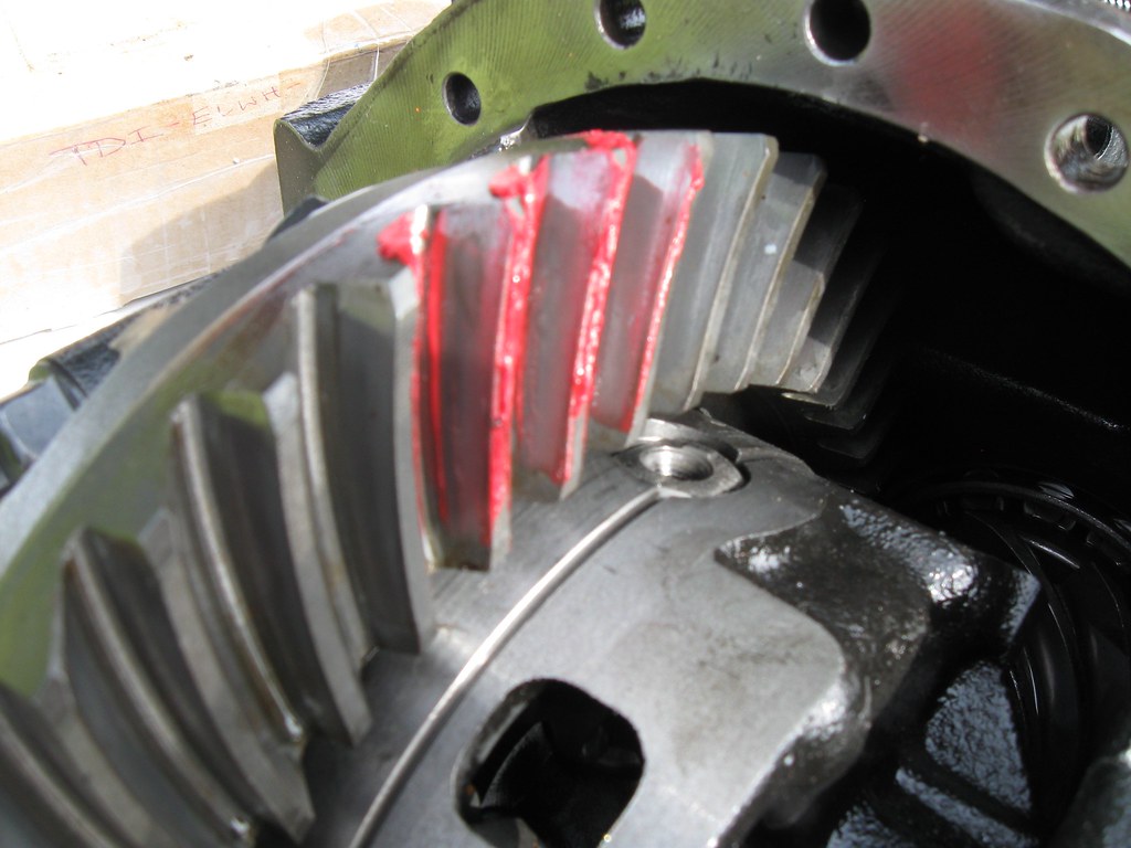

The shop doesn't use that backlash grease. They measure pinion depth before & after the rebuild. They said it was spot on. I wanted to double check it so I Googled what else I could use that I had around the house & lipstick was something that I had. Not mine! My GF's! LOL
It was dead on.
IMG_2530 by Mike Campbell, on Flickr
20170902_121132 by Mike Campbell, on Flickr
20170902_121150 by Mike Campbell, on Flickr

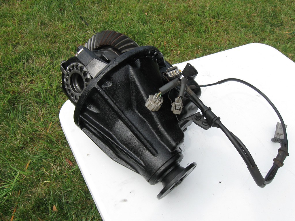

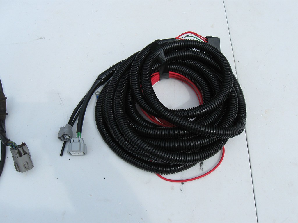

I bought the Low Range Off Road E-Locker harness from a member in the Classifieds for $100. Thats half off new. He sold his 3rd gen before doing the e-locker swap.
IMG_2529 by Mike Campbell, on Flickr
ultimate_toyota_elocker_wiring_harness_kit_1000px by Mike Campbell, on Flickr

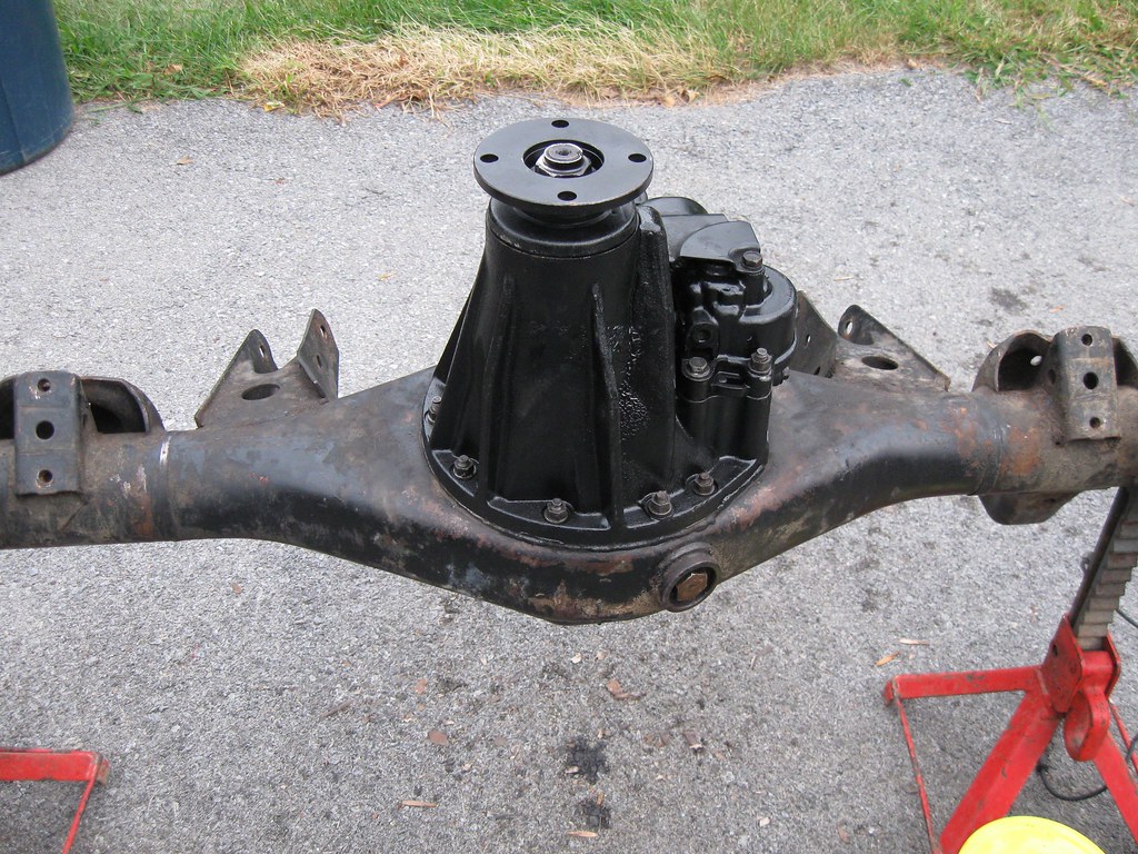

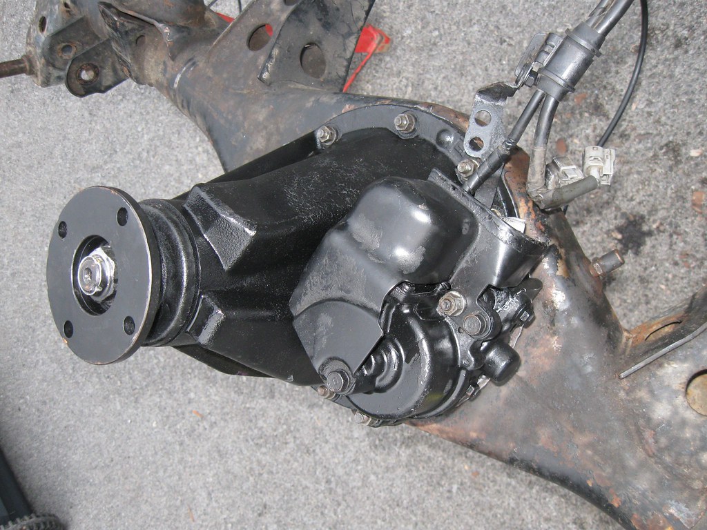

I followed the instructions on the Permatex label. I put a nice steady bead on the housing & around both sides of the studs. Set the carrier down carefully, "hand" tightened all of the nuts with my ratchet & let sit for an hour while I went in & had lunch. After an hour I tightened down by feel & then gave one more full turn. If you're an amateur use a torque wrench because these studs can snap pretty easily.
20170902_185632 by Mike Campbell, on Flickr
IMG_2534 by Mike Campbell, on Flickr
Here you can see a little of the Grey Permatex oozing out.
IMG_2535 by Mike Campbell, on Flickr
IMG_2536 by Mike Campbell, on Flickr

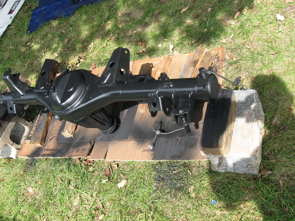

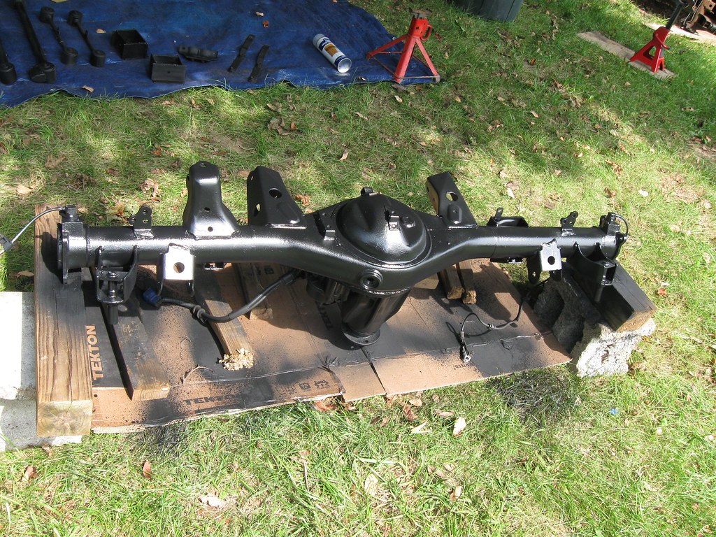

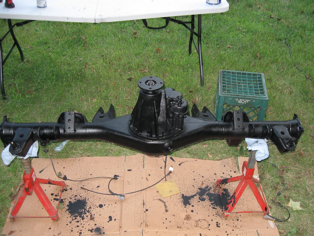

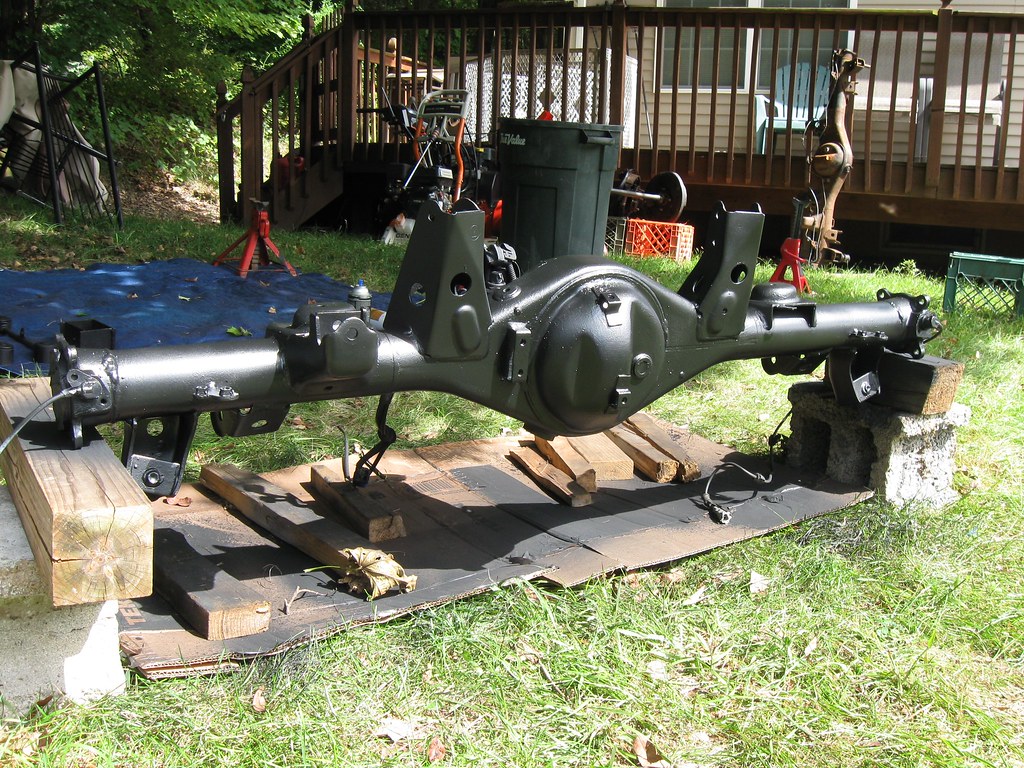

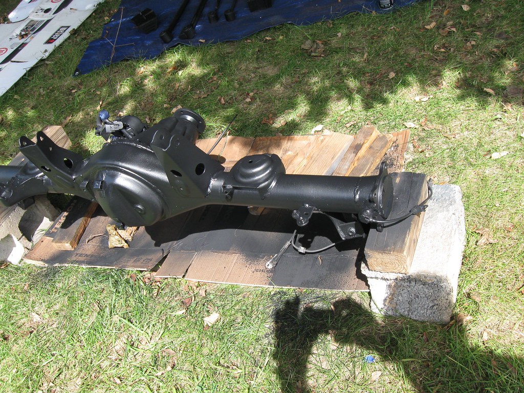

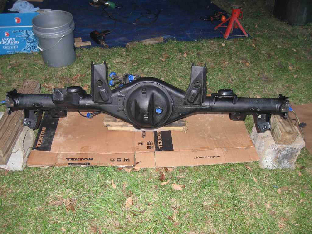

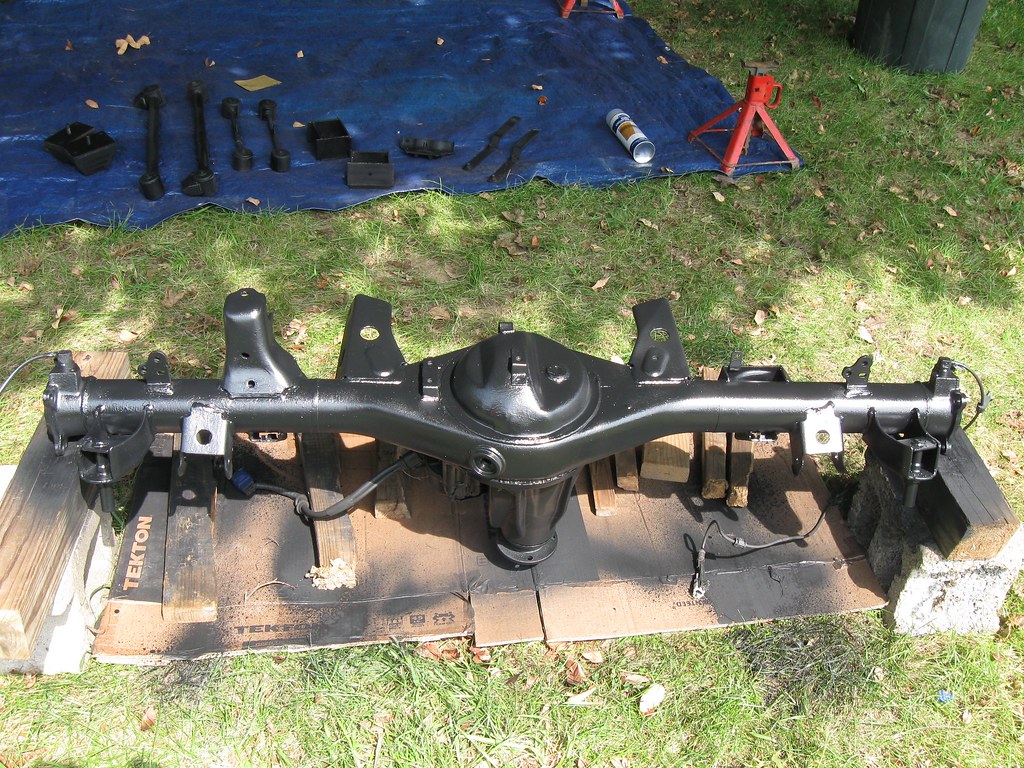

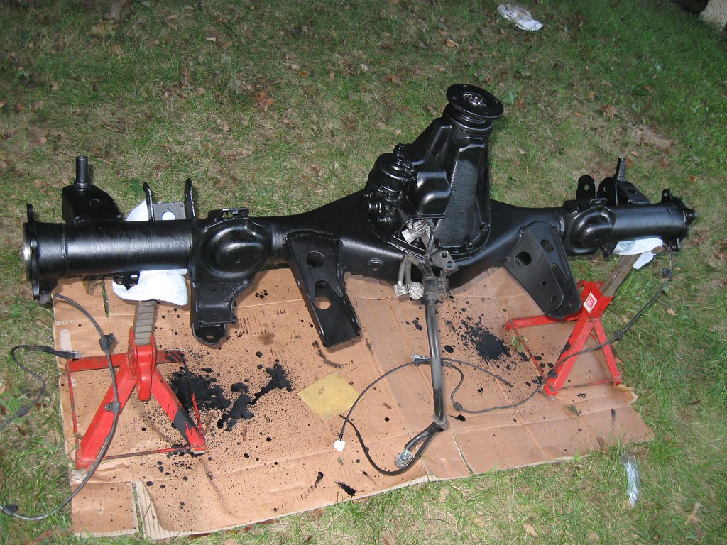

After letting the Permatex dry for 24 hrs I started to de-grease the axle housing. I was gonna use the pressure washer but I was afraid to get water inside and/or damage any of the electrical connections on the actuator. I used POR-15 De-greaser & blue shop towels.
I bought a quart of Eastwood rust encapsulator & applied the first coat by foam brush. I was really hoping for a smoother finish but this stuff dries fast & the only way to make it smooth is by spraying.
https://www.eastwood.com/eastwood-black-rust-encapsulator-paint-over-rust.html
IMG_2548 by Mike Campbell, on Flickr
I used a can of Eastwood's Internal Frame Coating w/ the 360* nozzle to get into all of the spots that a brush wouldn't reach. Thats what those drips are on the cardboard, that shit flies out.
IMG_2541 by Mike Campbell, on Flickr
IMG_2542 by Mike Campbell, on Flickr

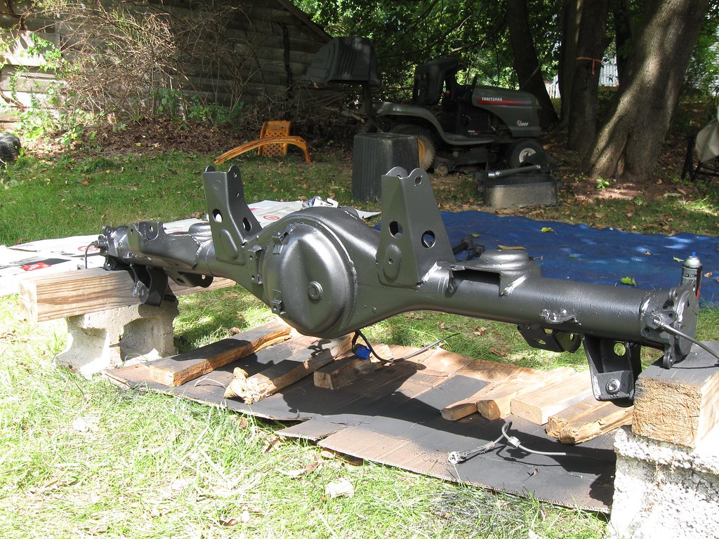

I let it sit until the following Sat & sanded the housing with 320 grit to get a smoother appearance & also to get good adhesion for the second coat.
I figured I'd try to spray this with my Wagner Stain sprayer that I used to do my deck. I diluted the paint with lacquer thinner & it worked pretty good. I wasted a pretty good amount of paint because the nozzle was too small but it got the job done.
https://www.amazon.com/Wagner-04170...34989767&sr=8-6&keywords=wagner+paint+sprayer
IMG_2550 by Mike Campbell, on Flickr
IMG_2551 by Mike Campbell, on Flickr

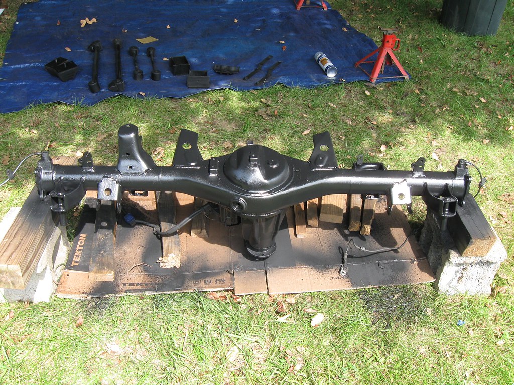

Let dry for 1 hour & added 2 coat's of Satin Black VHT Roll Bar & Chassis Paint.
IMG_2552 by Mike Campbell, on Flickr
IMG_2553 by Mike Campbell, on Flickr
IMG_2555 by Mike Campbell, on Flickr
IMG_2556 by Mike Campbell, on Flickr
Old perfectly fine axle housing in the background.
IMG_2557 by Mike Campbell, on Flickr

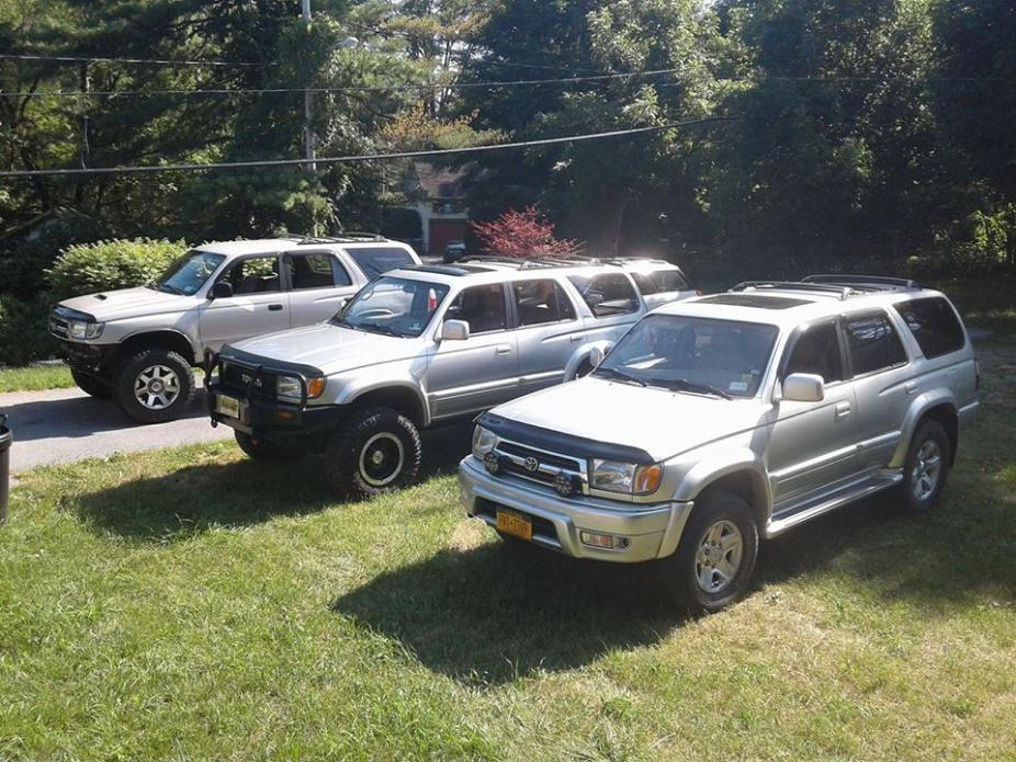

I'm not sure if I posted about my 3rd 4Runner. It's a fully built '99 E-Locked Limited with a rotted frame. Only has 144K on the clock. I drove it home but the frame is bad! Got it cheap & the e-locker axle was an add on so no rust on that. ARB bumper, TRD wheels w/ Duratracs, 3" Toy-Tec lift, CVJ axles, mint leather interior. I could part out a few things & break even easily. Or do a frame swap & have a really nice truck or keep it for parts. If I'm still out of work in the spring I'll have to part it out but I'd rather not. It runs & drives fine.

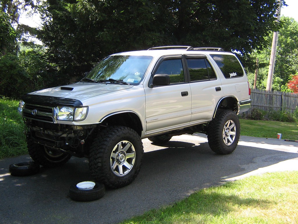

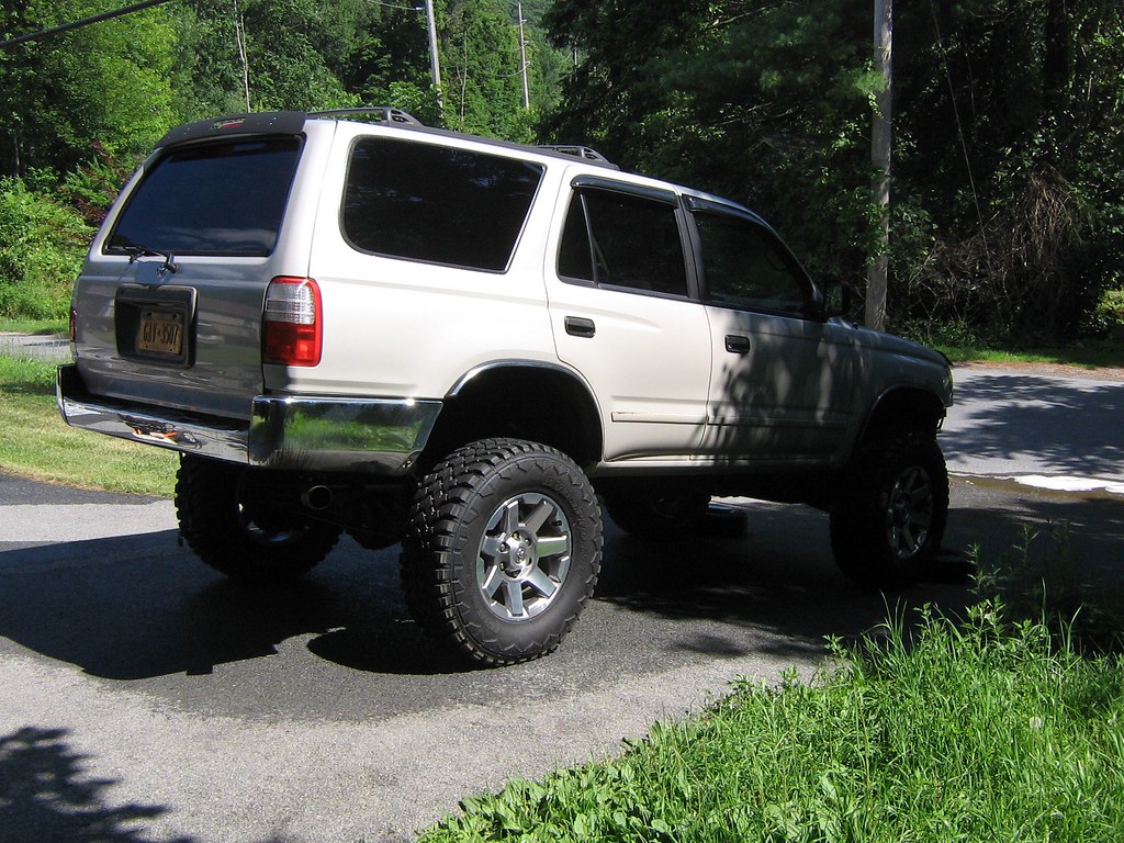

Here's a pic of all 3 in my front yard. Take care!
Neice Harem of 3rd gens. Good find on the runner. Its tough when dogs get old. I ve lost two, a 13 yr old GSP and a 12 yr old boxer. It's good to hear from you. Covid+ the shitty response for the working man and women did a number. Times are tough all around hope to God it gets better in a hurry. lots of my friends moving in with their families cause they can't afford the houses and expenses. All I can say is you are a strong Newyorker and I am sure you'll come out on top. Wish you the best.
